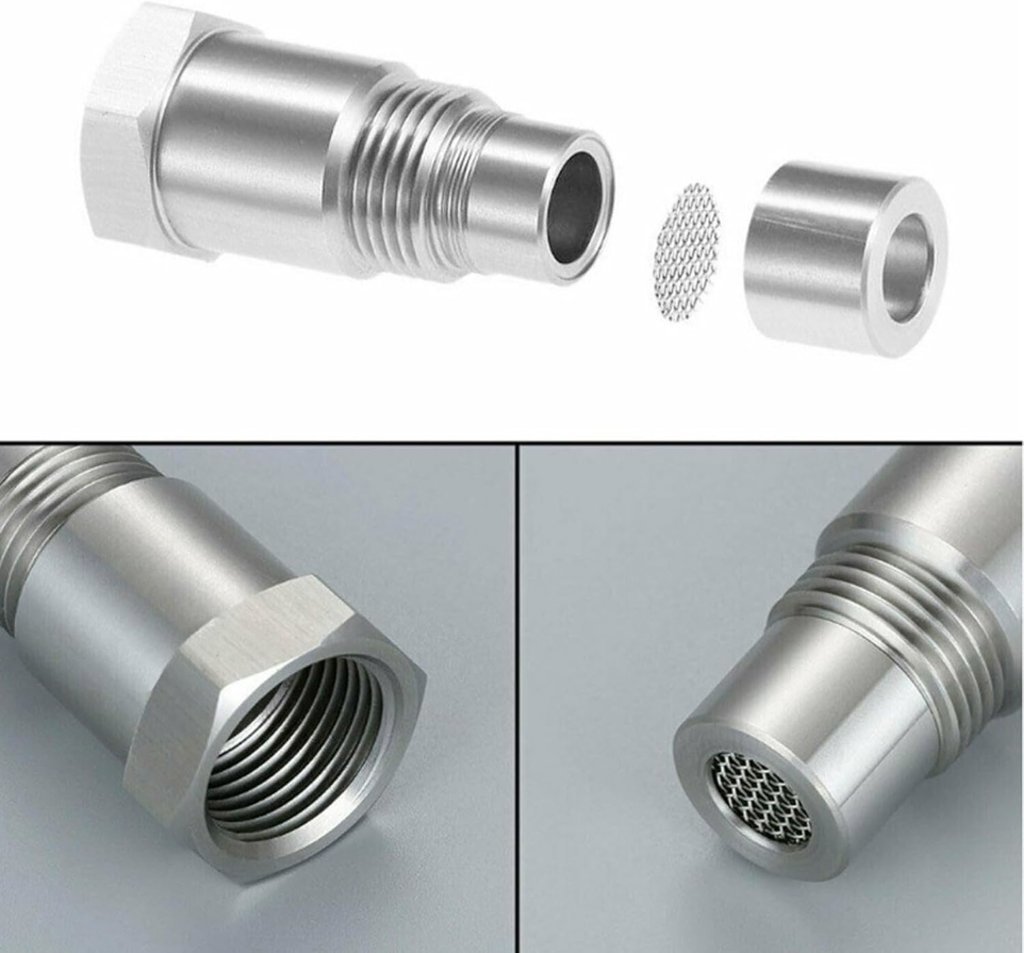

    I have another property with a cabin where they don't have inspections so I just register it there. So if it keeps going off I would want to put that adapter thing on the 02 sensor after the front cat on the passenger side? Can I spray some PB blaster on it when it is cooled down to start loosening it up or do the fumes mess up the sensor?

    I sprayed mine with PB but still couldn't get it off. I bought a new sensor and drilled out the fouler thing but still haven't gotten around to installing it. I did burn myself pretty bad on the hot pipe but this was a different issue where I went under the truck after driving and turned my front drive shaft to make sure it wasn't engaged, I accidentally touched the exhaust and got a blistered burn on my wrist. Doh! I haven't tried after that.

    If I had same code , at first would clear for few months then come back , then stayed permanent. Never noticed any difference in performance, I tried everything from fuel additives to swapping O2 sensors , even replaced MAF . Nothing worked .
    Had truck in dealership for a minor recall I think , so I asked them to diagnose.
    They said it was failed catalytic converter. Would not cause any issue to drive it if I didn’t wanna replace catalytic converters at $1200 per side. So basically if I’m understanding it correctly,
    Cats are not plugged or restricting flow.
    They are just worn out and not cleaning the exhaust gases at full efficiency.
    Since we don’t have emissions testing where I live , I forgot about it . but check engine light always bugged me so I tried this and it has been 2 years without code coming back. And no engine light .

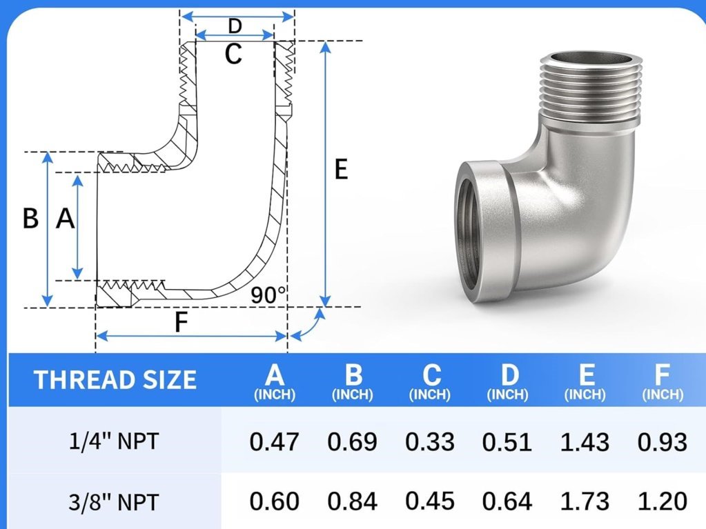

    The straight ones typically dont work on NA vehicles, I've seen the 90 degree o2 spacers work on the 4.0 though.

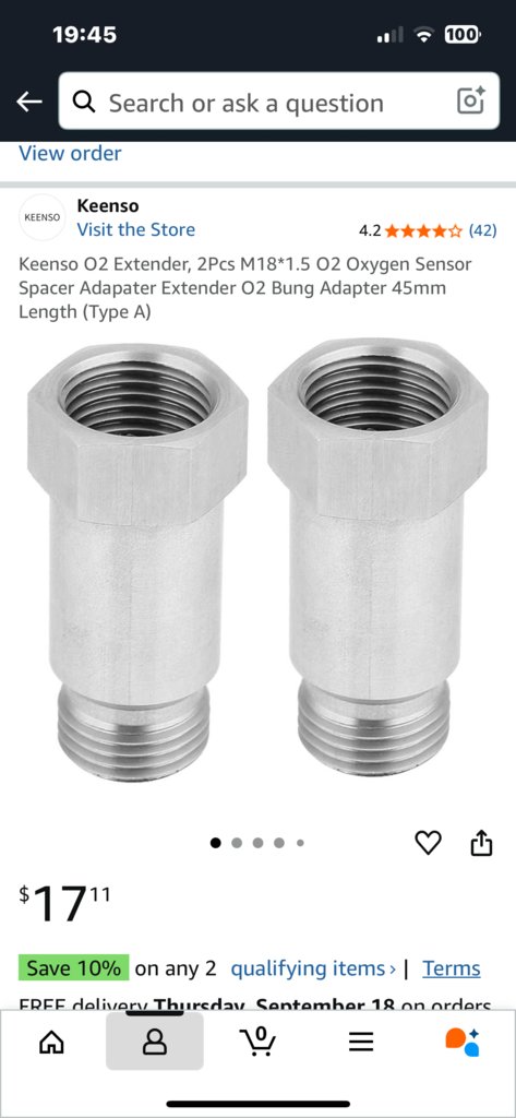

    So the threaded ones (18mmx1.5) only work on Canadian and the North American (USA) need the flanged style?

    I remember seeing a few different types some with the filters , can’t remember if the ones I got had it . I don’t know how there would be any difference in a US vs Canadian vehicle , my truck was built In California as far as I know. Unless emissions standards vary .
    I did question a mechanic about raising the sensors out of the exhaust flow one time while I was trying to get rid of the code , and he said sometimes that makes it worse . But I think half the mechanics I questioned automatically hear or think plugged or fouled cats causing restriction.
    Idk ‍♂️ . But I do know that for $20 vs $2400, it eliminated the P420 code.

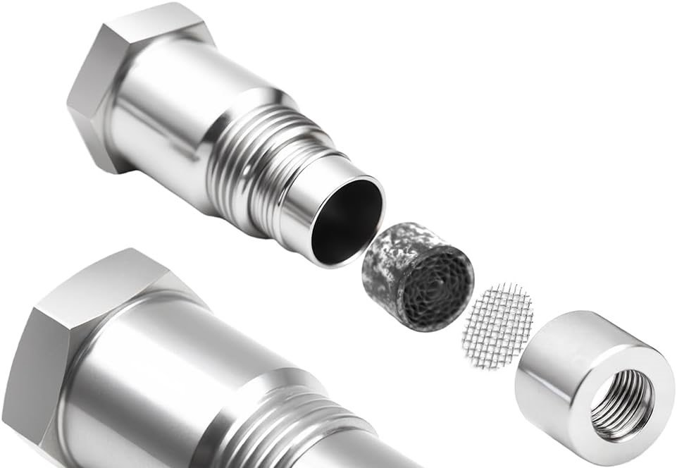

    51XR2iaVkhL._AC_SL1000_.jpg 71c7+fI+3rL._AC_SL1500_.jpg 713pefZtTvL._AC_SL1500_.jpg _AC_SL1000_.jpg
    I'm going to try the ones from Amazon if the fault keeps coming up. Also I am a metal fabricator so if I need to go the 90* route I will get these 3/8" elbows and cut the adapter in two and tig weld them to make a 90* adapter.
    The one Bishop links to is $60 plus shipping for 1.When trying to enter your address for calculating shipping it won't let you enter USA only Canada! To make this it will cost $15 plus my time. But thank you for the link so we can see another option but the adapter from Amazon may work as is.

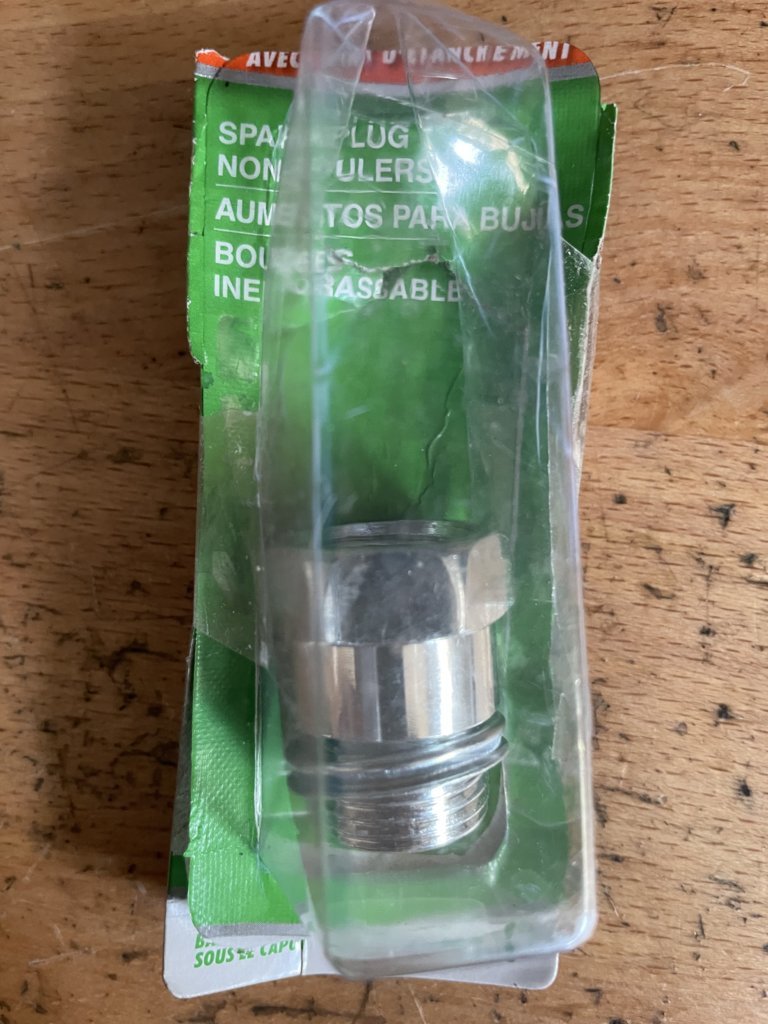

    I got rid of my P0420 with this Doorman spark plug non-fouler. 2 for $11.
    It will do until I get the exhaust leak taken care of.
    I bought a O2 sensor removal socket but it wouldn't budge. I then used a 22mm boxed end wrench with which it came off easily. Sparingly used some MMC78 on the threads.

    I was going to get the Doorman but the product listing didn't state what the thread size was. I am hoping the straight fitting will work as is and that will be the end of it. If it comes on something like once a month I will just keep the code reader in the center counsel and clear the CEL. I ordered a 1/2" drive socket. It should either work or break! The last time I worked on 02 sensors I had to heat it up with a torch to get it to break free. They run pretty hot from normal use I think anyway.I'm just glad to know that this P0420 code doesn't alter the way the engine runs as far as messing up the AF mixture.

    Well yes the Dorman is the same thread but you have to drill out the bottom. I did mine to 1/2".
    I bought the Tekton 3/8" socket. I just couldn't get the leverage with such a tall socket at that angle.
    I had a old 22mm Stanley wrench. The sensor connector fit through the box end. Much easier and with one tap of a hammer it came loose.
