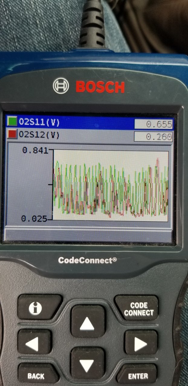

    Do you have a meter that can track live data?
    If not the oriellys one can, you usually just have to walk the attendant through it lol
    Track what the voltages look like from the front and the back O2 sensors if it looks anything like mine you've got a bad cat... you want the second O2 sensor to read a basically flat line
  10. Jul 7, 2020 at 9:50 AM
    Abeyancer
    Abeyancer Not so secret, secret van guy
    Mar 28, 2019
    #288326
    13,245
    Jimmie
    PNW
    98 4x4 ex cab tacoma 3rz
    @pontoon sorry forgot to attach the picture so you get a sense of what I was talking about

    The first 02 censor controls engine performance, and the 2nd one just compares the results from the first one, to see if the cat is doing its job. As @Abeyancer posted, if both censors are showing essentially the same thing, your cat is bad.

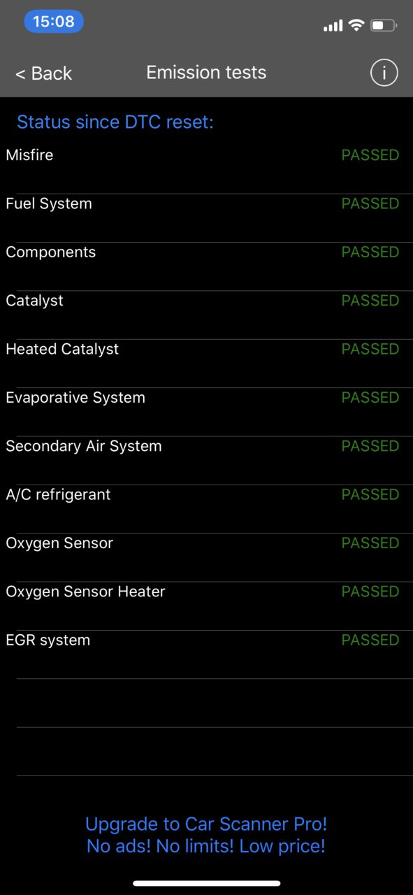

  13. Jul 17, 2020 at 3:24 PM
    pontoon
    pontoon [OP] Well-Known Member
    Jun 12, 2016
    #189413
    450
    2000 Tacoma SR5 TRD V6 3.4 5MT
    Wyoming09 likes this.
  14. Jul 17, 2020 at 3:27 PM
    Wyoming09
    Wyoming09 Well-Known Member
    Apr 24, 2015
    #153833
    14,277
    New Tripoli Pa
    2000 Work truck 5 speed 4x4 3.4
    Super Springs
    What if anything did you do just clear the codes and drive till all the tests run??
  15. Jul 17, 2020 at 3:34 PM
    pontoon
    Jun 12, 2016
    #189413
    450
    Two years ago I replaced the upstream sensor, reset code, passed smog, no CEL for 2 years.
    About a month ago I changed the oil and the CEL came back. I reset the code once without doing anything and I got the code again. When I cleared it I had gotten the code 3 times I think.
    I replaced the downstream sensor, reset the codes in the ECU, then drove it until the ECU passed the catalyst.
    Now time to quick get it smogged before my registration expires.
  16. Jul 17, 2020 at 5:12 PM
    #16
    pontoon
    Jun 12, 2016
    #189413
    450
    Just went to the smog station and passed smog. :woot:
