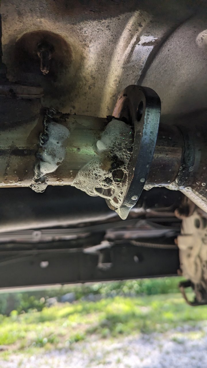

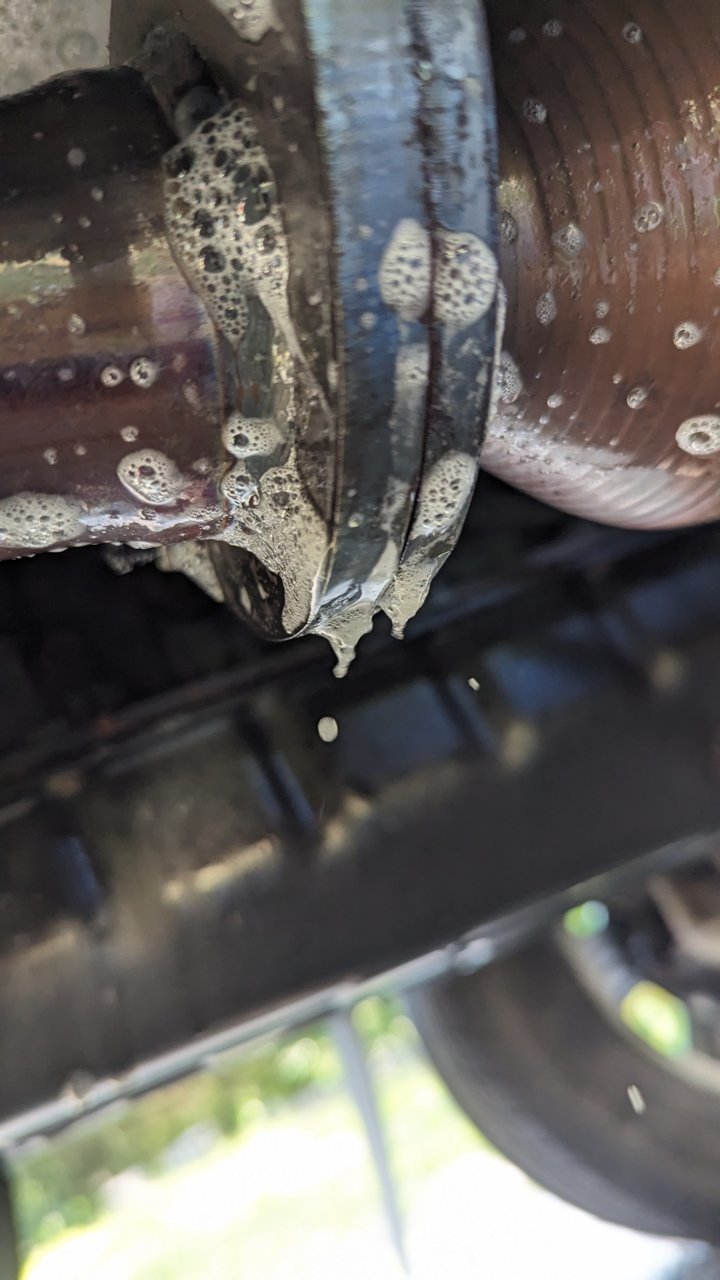

    Found a few exhaust leaks at connection points. Once spot is after the first cat and before the second. The other connection is after both cats. The leak before the second cat is small, do you think that small leak could be causing the p0420 code?

    it does not take much. As the exhaust gets hot the leak will expand.
    Replace the gasket and hope that fixes the problem.

    There are a couple of ways to test the cat. If you hear rattling, it's time for a new one. Furthermore, if you stomp on the gas and get a flashing check engine light and can't seem to get over a certain RPM, your cat is likely the culprit.
    I suspect addressing your exhaust leaks will clear a few of those codes though.
