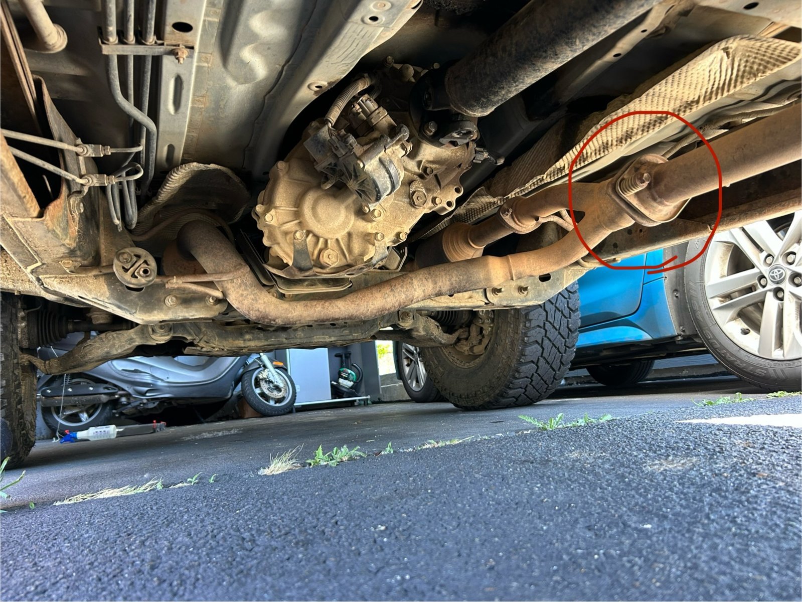

    I know an exhaust leak will cause these P0420 and P0430 codes, but will and exhaust leak past the sensors matter?
    I have an air leak here, but I would think it could cause those codes… or could it?

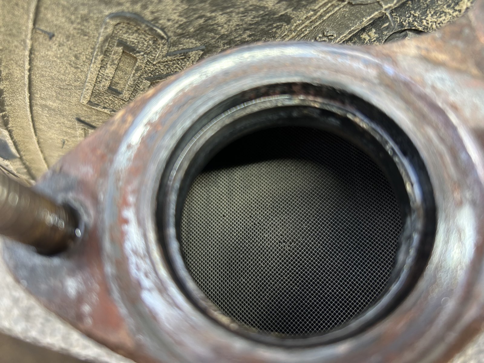

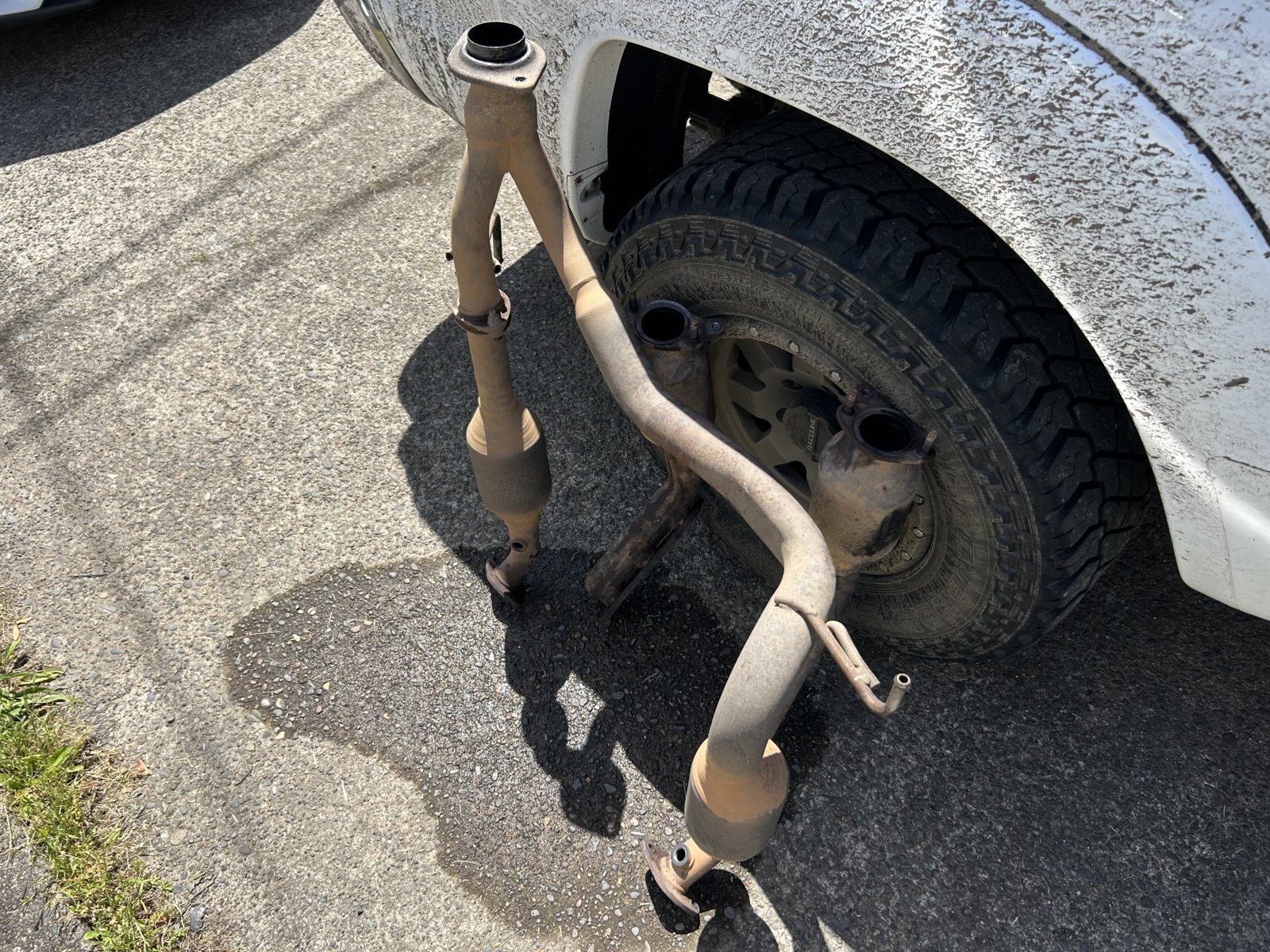

    I cleaned my MAF sensor and throttle body, I replaced all 4 O2 sensors with new Denso sensors I got from Rock Auto, I took all 4 cats off my truck and cleaned/flushed them out and I can’t find any wire issues. Still both of these codes persist. Both codes come on at the same time and consistently after I drive the truck 50miles after I clear the codes.IMG_0414.jpg
    My fuel trims seem elevated (anywhere from 7 to 11 at idle) and my gas mileage is not great. Seems to average 16 hwy

    I was fighting the same issue for a long ass time. I did my spark plugs, PCV valve, downflow o2 sensors, a whole bunch of stuff (some honestly unrelated) and what turned my light off for what’s been about a month and still going now is fixing an exhaust leak I had. That could very much be it.

    Where was your exhaust leak?

    On the flange right before the downstream o2 sensor. I think it was a bad gasket.

    No. A leak after the O2 sensor will not cause those codes.
    Graph the sensors and see what is happening.

    As @fatfurious2 mentioned, the gasket you circled disintegrated on me last year. I did not get any CEL codes
    Part # for my 2012 V6 is: 17451-0A010

    I have seen in some rare cases, that the harness for the O2 sensors was inadvertently swapped side to side. This caused the same codes you have every time.
    Looking at your truck, it looks quite stock so I doubt this is the case.
    When you reinstalled the exhaust, did you install new crush gaskets between the header and y-pipe? New manifold gasket too perhaps?

    Graph out your sensors are recommended earlier but tbh, p0420/p0430 codes are one of the few codes if not the only codes that are fairly reliable in telling you exactly problem, which is your cats are not converting enough. With your fuel trims being higher, spend some time to find the cause of that as an overly rich fuel mixture along with burning oil or coolant can lead to early catalytic converter failure.

    Yes all new gaskets. Starting to sound like 230k miles made my cats obsolete. The cats honeycomb looks great and was still clean. Even though they look great, the platinum comb just gets eroded enough that it can’t help emissions?
