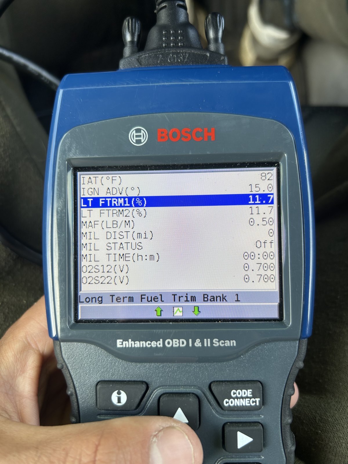

    Long term fuel trims. 11.7 and 11.7
    Short term fuel trim. 3.9 and 3.1

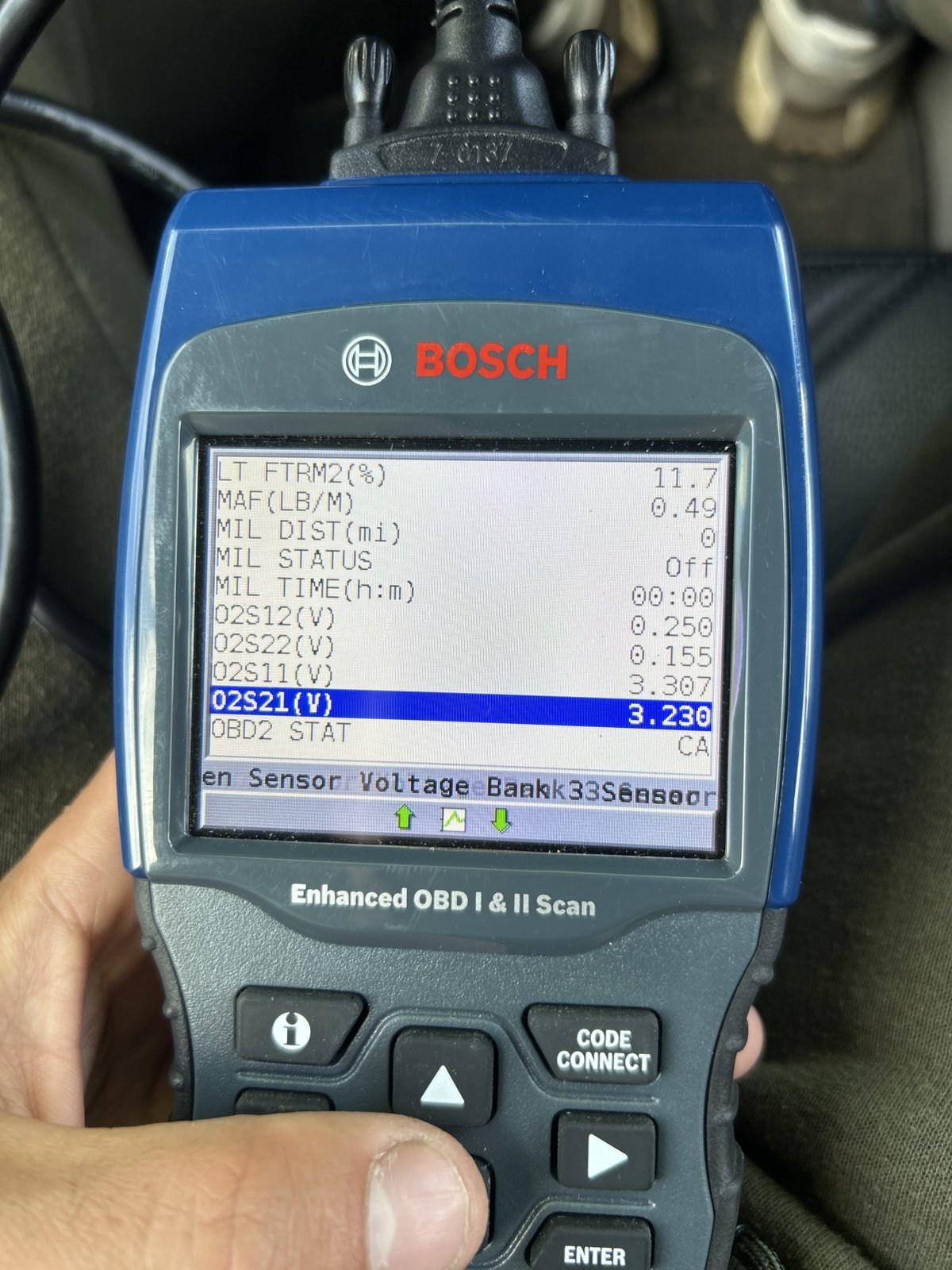

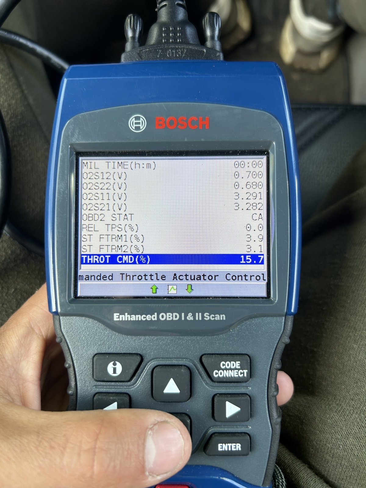

    Are my O2 sensors reading at appropriate volts?
    I am getting 15mpg.

    9 times out of 10 those codes mean the converters are no longer functioning as intended.
    Those codes don't mean the conver is plugged, they set when oxygen storage capacity of the converter is low.
    Now one or more could be plugged or restricted as well but a plugged/restricted converter won't set P0420/430 codes nor do P0420/430 codes mean a converter is plugged.
    There are some additives that "might" temporarily restore a marginal catalyst enough for it to pass the P0420/430 codes for a bit but the only real fix is to replace them or live with the light.
    The fuel trims while a bit elevated aren't too concerning, MAF reading is slightly low if that's at a hot idle which could account for the elevated fuel trims. Do you have an aftermarket air intake installed?

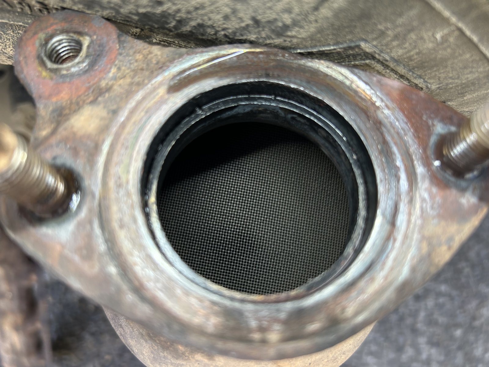

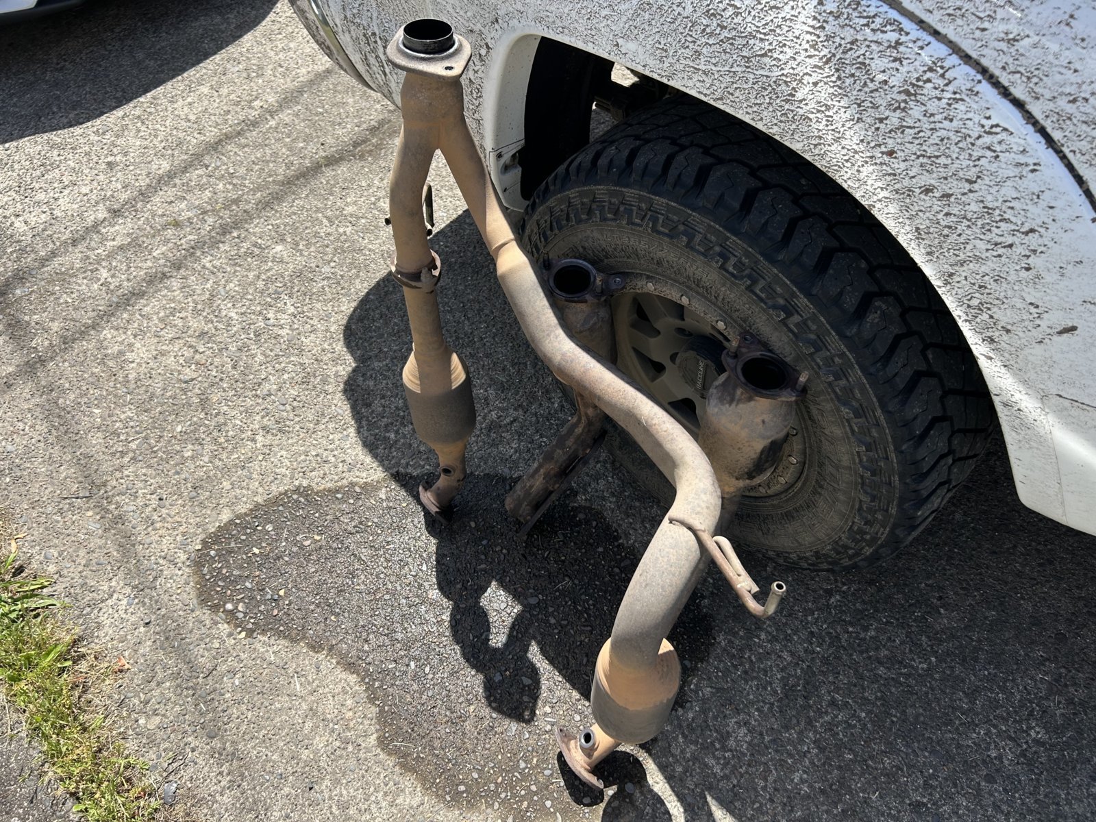

    Took off my whole exhaust system and cleaned out all 4 cats with multiple different cleaners and flushed them out. Not much contaminants. Code still came on.
