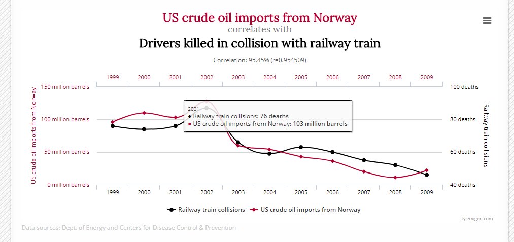

    I think what makes it hard to understand is the slight change in angle from the minimal lift. I can't see how it would seal an exhaust leak, seal or lessen a leaking fuel injector, fix a vacuum leak, reconnect a loose sensor plug, or fix a bad O2 sensor for that matter. I can't buy the honeycomb touching the sensor theory.
    You say the code has been on for a year? How many miles? Did it just come on randomly orignially?

    Yes
    well actually this is bad info, your truck only tests actively at 3/4 and 1/4 per tank. so unless you were at said angle at the moment it self tested...nada. anything before or after those two points is irrellevant. if you have a device such a code scanner or scan guage etc that allows you to clear codes you can see this clearly

    Zero correlation bud. The height/angle of the truck will NOT cause a CEL. Period. Not even for emissions system.
