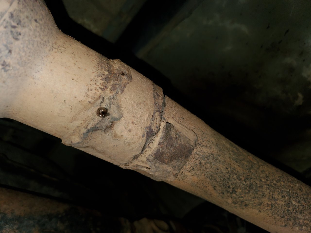

    I found the exhaust leak

    Is the exhaust leak between engine and O2 sensor?
  14. Mar 2, 2020 at 2:41 PM
    03taco
    03taco [OP] Well-Known Member
    Mar 4, 2018
    #246316
    515
    Alex
    2004 Taco
    Never Ending Project
    Right before the muffler

    Exhaust leaks downstream (after) the sensor won't cause PO420.

    And you know the muffler from the catalytic converter right?

    Yes
