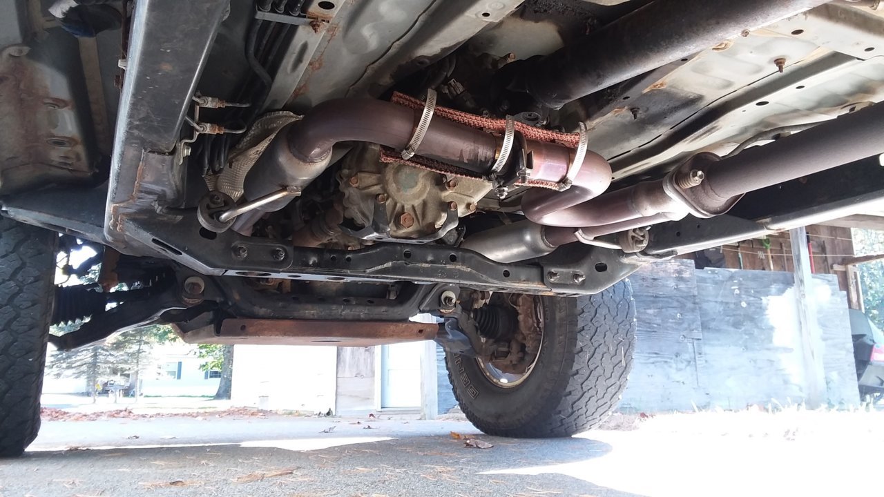

    Here's a pic to give you an idea about clearance. Not sure how the BudBuilt skid plate mounts but this y-pipe does give quite a bit more ground clearance compared to the stock exhaust. It passes pretty closely to the four wheel drive actuator so I put a small heat shield over the pipe to protect that.
    As for the check engine light it has remained on. This may be caused by the slight leak at the seam underneath the heat shield, (you can see the soot on the pipe in the pic), or it may be caused by the fact that the two rear cats were replaced with resonators. I'm going to tighten up the clamp at that seam to see if that fixes it and if not I'll buy the simulators.
    For anyone curious about performance, I feel that this y-pipe did wake the truck up quite a bit. It seems to pull a lot harder in 2nd, 3rd, and 4th gear. Unfortunately I haven't done the numbers to see how it affected gas mileage. I still have the stock headers and the stock muffler and the truck has a slightly raspier sound to it, not really a lower rumble but not an obnoxious ricer sound either. I have about 1500 miles on it now and I'm pretty satisfied with it.

    I think it will work with the skids without interference. I don't have a good picture, but they the rear plate is lower than the transfer case, and the BudBuilt rear crossbar angles down a couple of inches lower than the frame. I'm not a rock crawler, and only added skids to protect plastic and wires from branches and shit that might bounce up. They are also useful in floating over deep snow. Anyway, since I never plan to high-center the truck on a boulder I went with aluminum skids, and I will have no regrets if they have to be clearanced a bit.
    As for the trouble code, I bet you have a leak where the PB connects to one or both manifolds. I saw in another post somewhere that the PB is set up for a thicker than stock crush gasket, and that if you use a stock one it can end up a little off-center (in the downward direction) resulting in a poor seal. Replacing the secondary cats with resonators wouldn't do anything, and I doubt a leak at the crossover would either. That said, the installation instructions say that the center clamp is not meant to be permanent, and is only there for fitment before welding the seam.
    I am planning to have mine welded up at the local muffler shop after home installation. Once welded I am going to paint the crossover portion with some exhaust paint and then wrap it with heat-wrap. You are correct - we need to protect the transfer case actuator!
