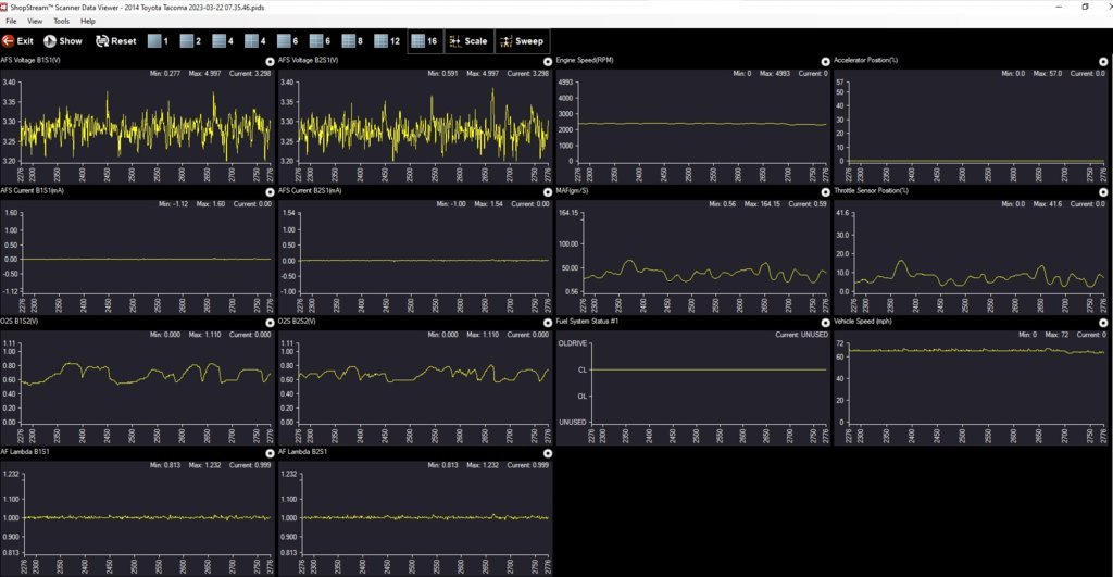

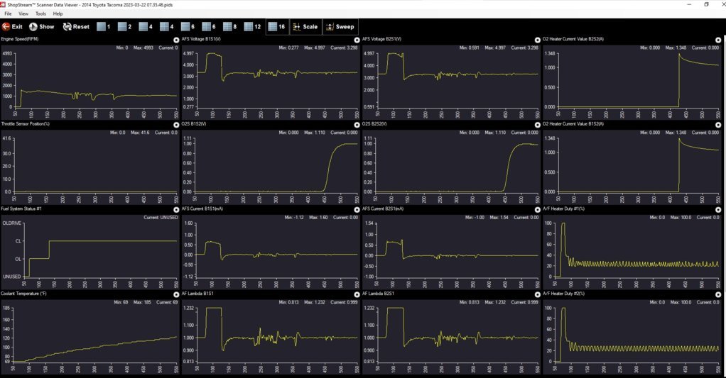

    For reference this is what scan data with good cats look like.
    Cold start and idle.
    Driving steady speed on a somewhat hilly road.
    GilbertOz likes this.
  8. May 23, 2025 at 9:07 PM

    Man was i hoping you'd chime in again haha. I can only do 2 at a time with my shitty scanner, so I'll do the driver side then passenger and compare against what was stated.

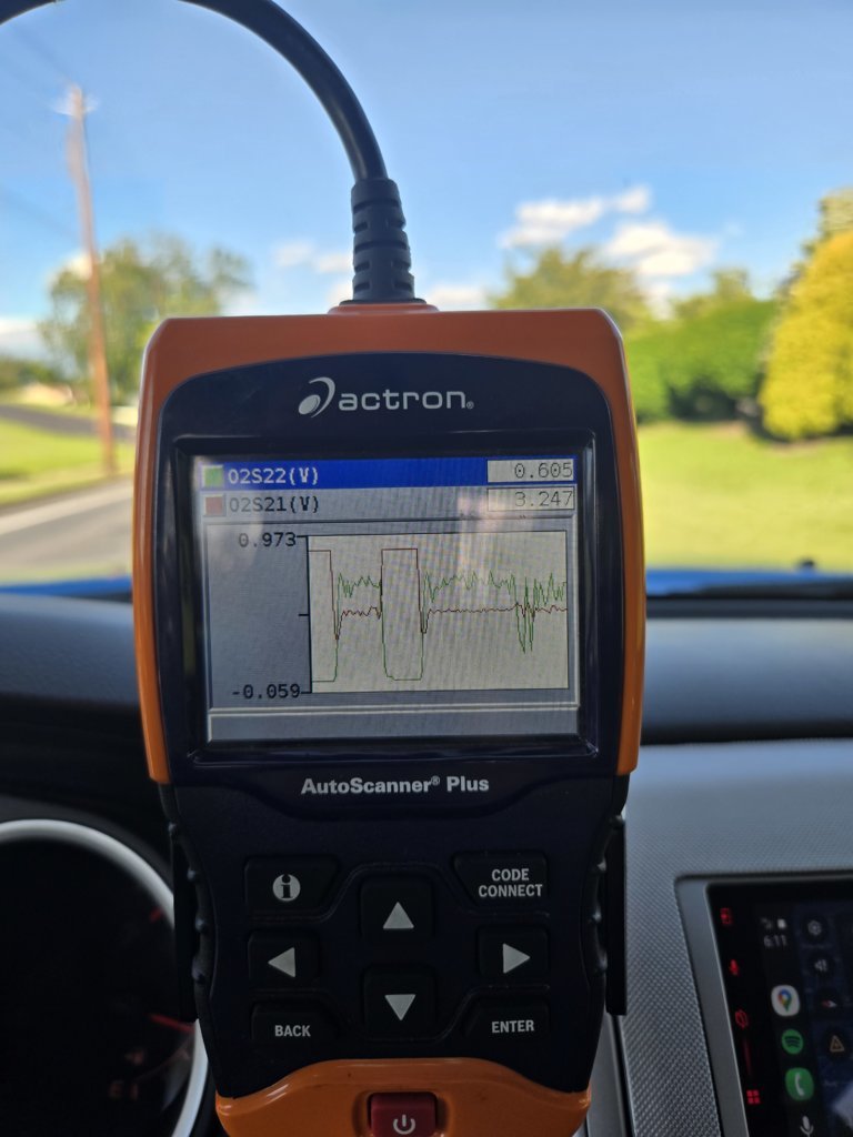

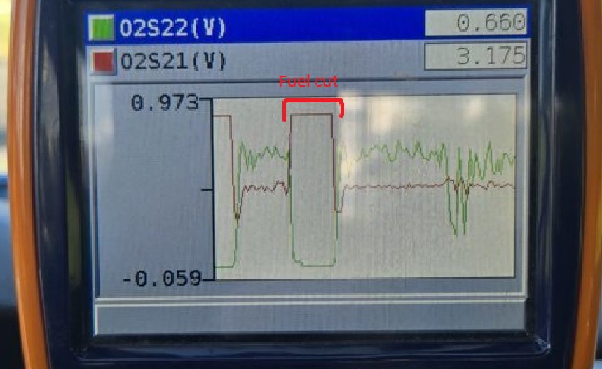

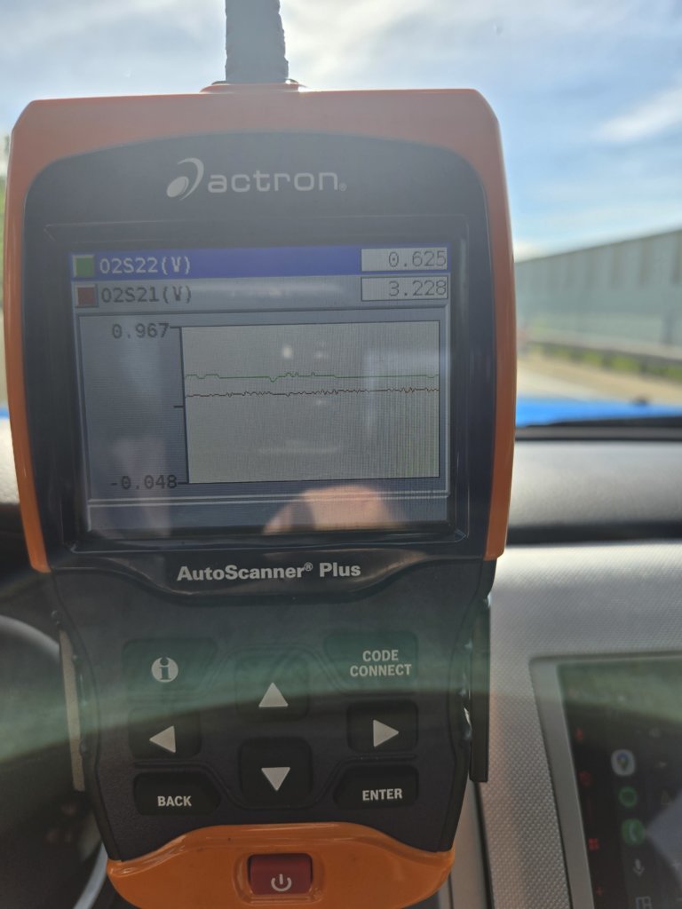

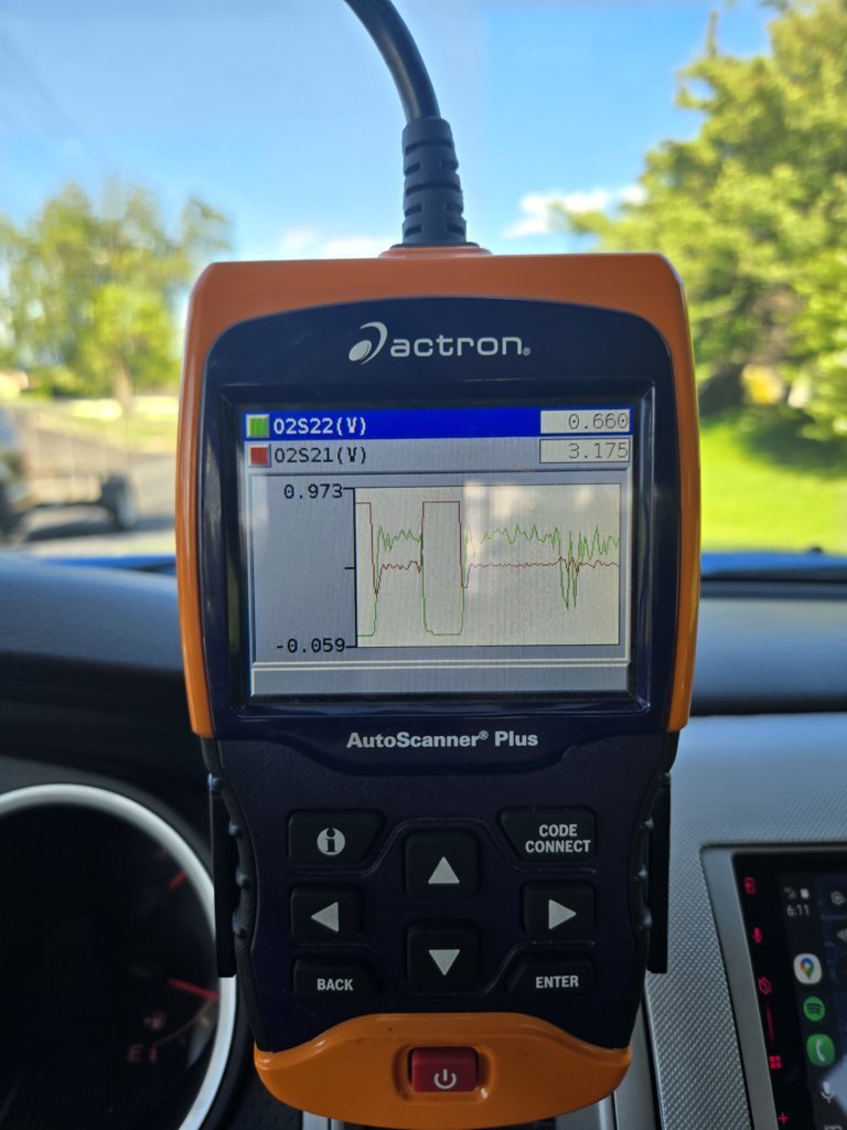

    So the afr and 02 voltages are pretty tame at idle. But when Im driving around easy. They go wild. If I give it good solid gas, they seem to all stay happy. But anything besides nothing, or all of it and the secondary 02s are bouncing around from .013 to .9 ish

    Not sure what's going on in the first picture, that looks like garbage.
    The 2nd two kind of look like a failing converter but it's hard to tell for sure without context of the timebase shown on the screen.
    You can see where the decel fuel cut occurs the upstream and downstream sensors look like they go lean at nearly the exact same time and the downstream recovers almost immediately when the fuel comes back, this typically indicates the converter is no longer functioning as it should but again without context of time on the screen it's hard to tell.
    With a good functioning cat there should be a delay of at least a second or 2 between changes in upstream vs downstream like when a decel fuel cut occurs and also the downstream sensor voltage should be pretty steady at a steady throttle.

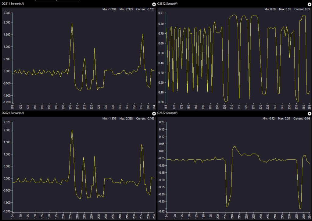

    This is taken from a Ford but is a pretty good example of a failing cat on bank 1 (top) and a decently functioning one on bank 2 (bottom), note that Ford displays a current value for their upstream sensors rather than voltage. 0mA is 14.7 AFR, positive values are lean and negative values are rich.

    I guess context would definitely help. I was driving at like 40 mph on a semi open road with red lights. So in the 2nd 2 pictures I was off throttle then went back to cruising at about 45. I'll get one today on the highway with no stop and go. Just 60mph cruise
    The first picture was steady cruise at about 30 mph or so. And yeah it looks terrible haha

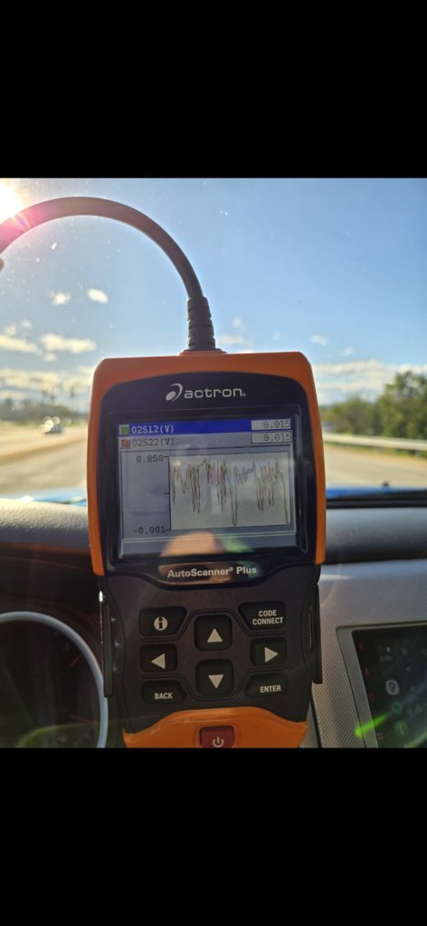

    This was steady at 70mph

    That looks good, honestly I'd drive it for a while if your not up for needing to pass emissions just yet and see what happens. You might get lucky and it was just kinda gunked up from running poorly.

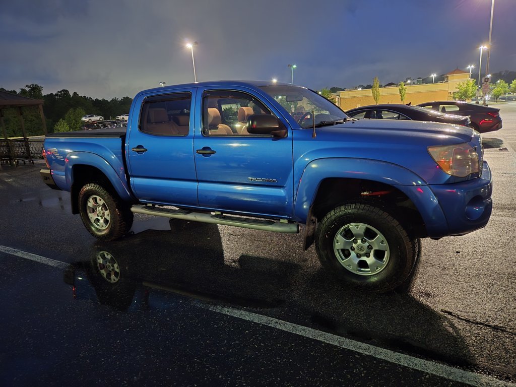

    Oh, and one just for fun because i just finished. Here she is after a 3k lift i finished 5 days ago. im gonna keep this truck till I die. Idc what it ends up needing.
    I did icon rear rxt rear leafs with 5160s, and the achrive garage u bolt flip option 3. In the front i did jba ucas, 2885's, 5100's, and wheelers super bumps. And i extend the rear brake lines.
    I have shims and carrier drop on stand by.
    Oh and the C4 hybrid bumper with full hoop will be here in a few weeks.
