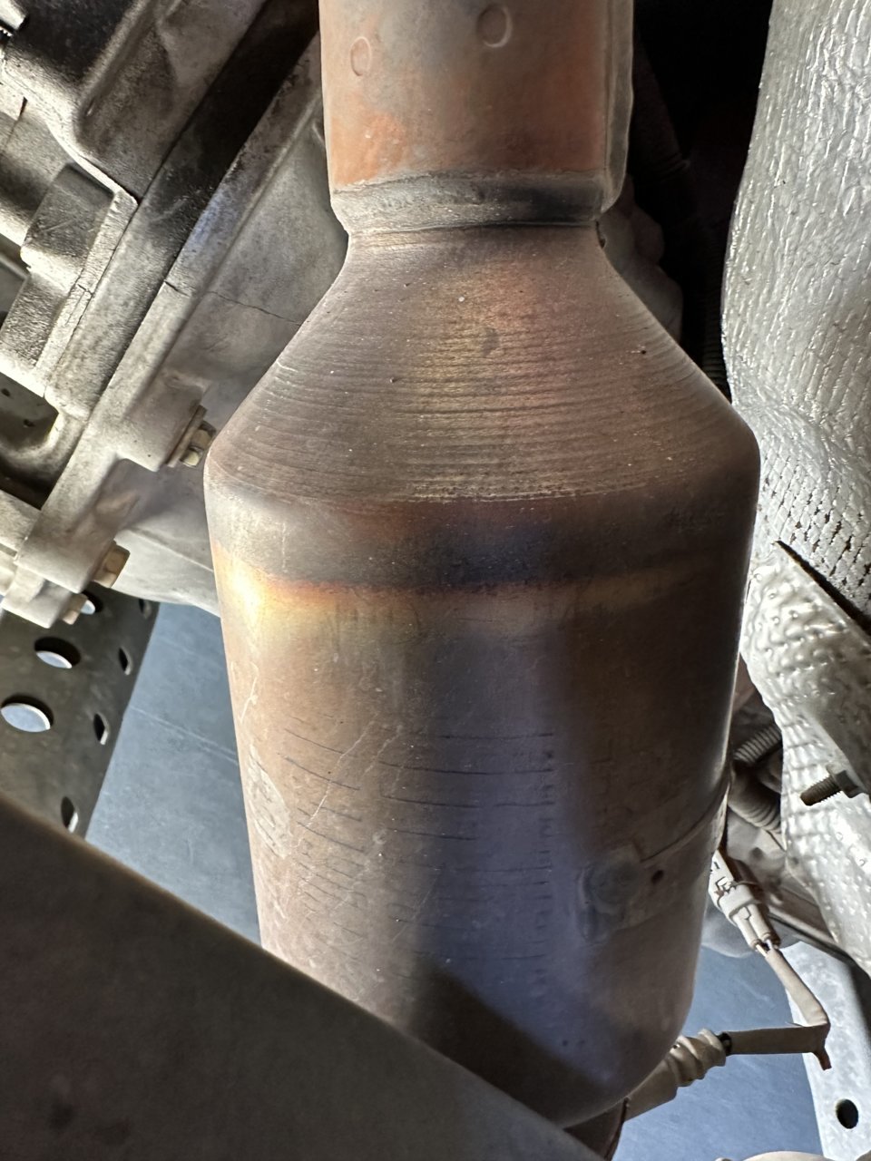

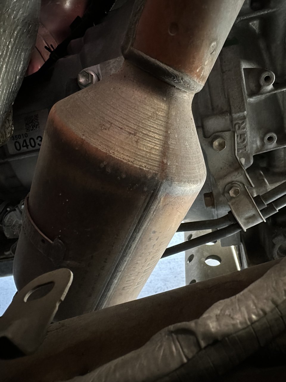

    Also do these look ‘cooked’?

    My temps got even higher when driving, yikes I was a little over 1500 is there maybe and under line problem I should figure out before doing those cats?

    I cant speak to the exact range you should be seeing, sure someone else can. But I do know cats runs very hot by design. Allows the catalyst material to react with and scrub the gases
