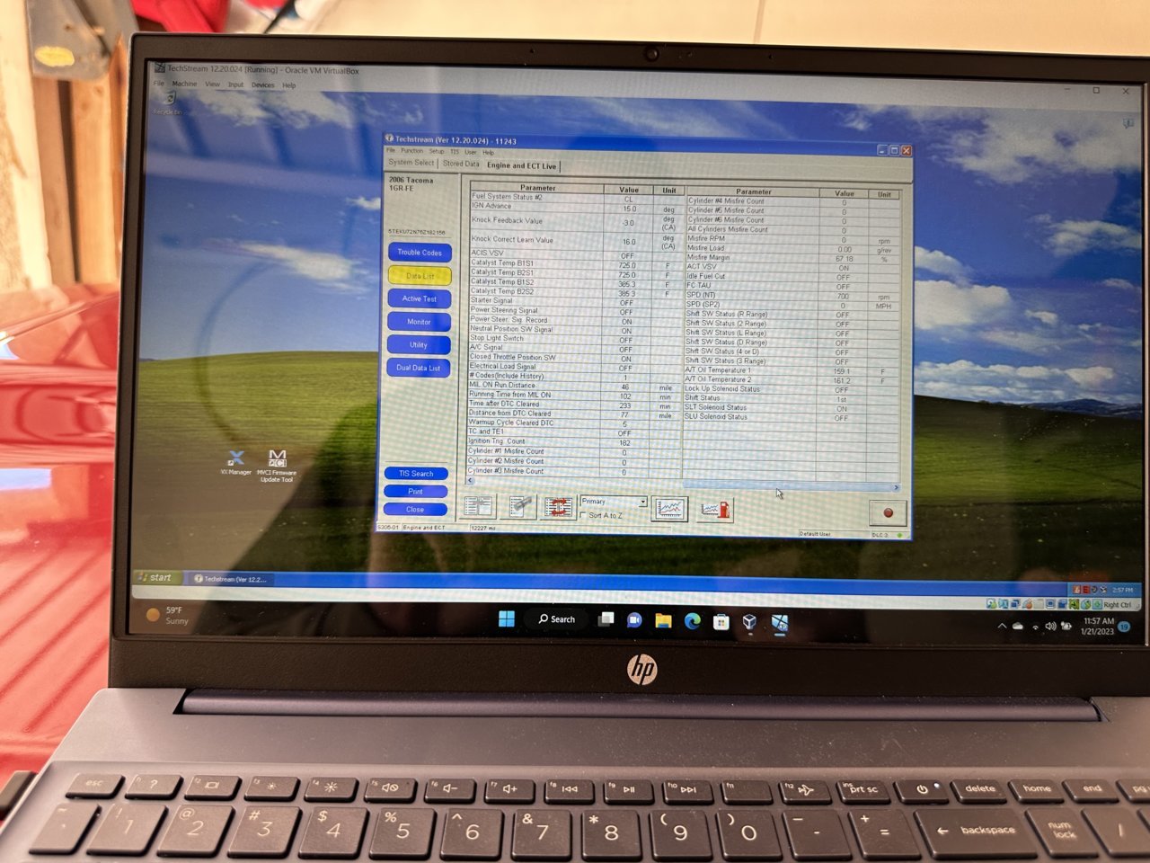

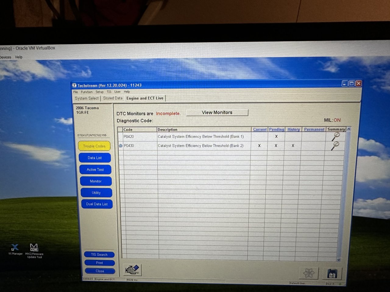

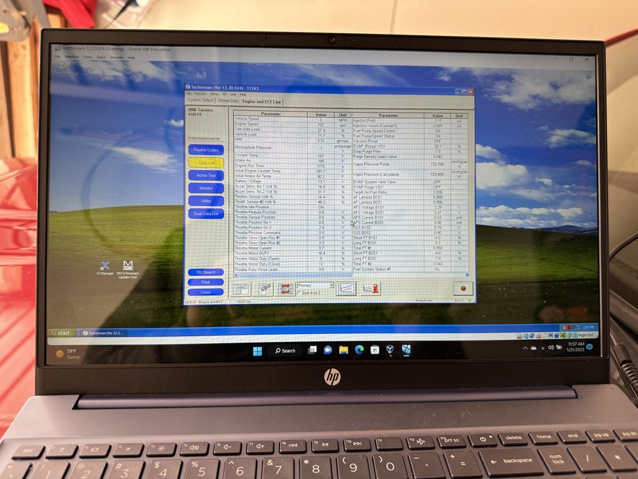

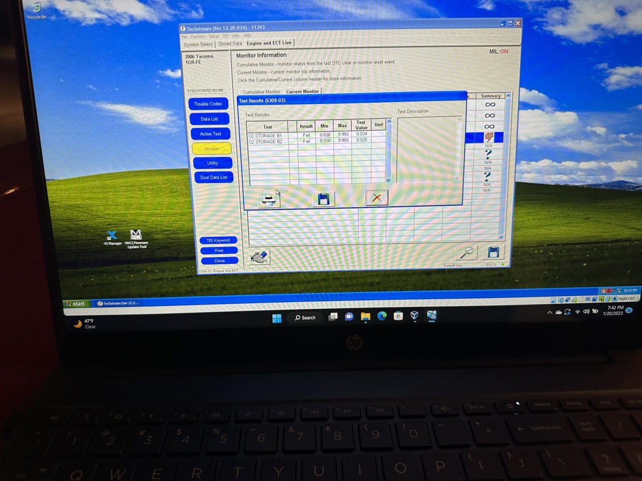

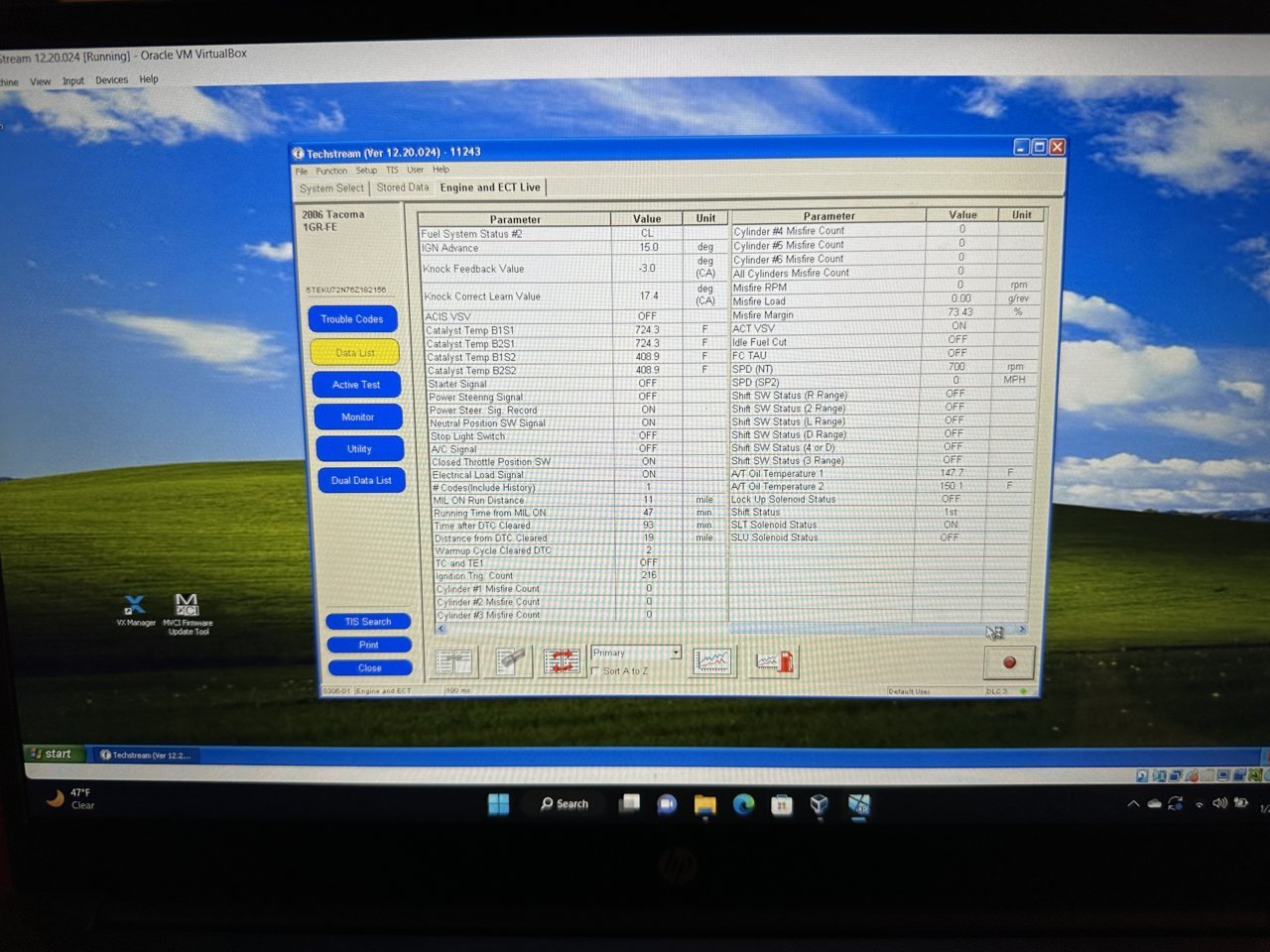

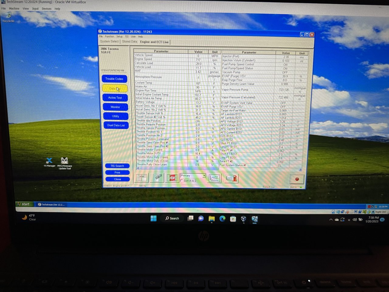

    I had a p0174 and I changed out the MAF sensor with an oem sensor from toyota. The truck is running much better and seems likes everything is good to go… well After about 10-15 miles check engine light comes on its p0430. Here is some data from tech stream. What are some next steps in trouble shooting this?

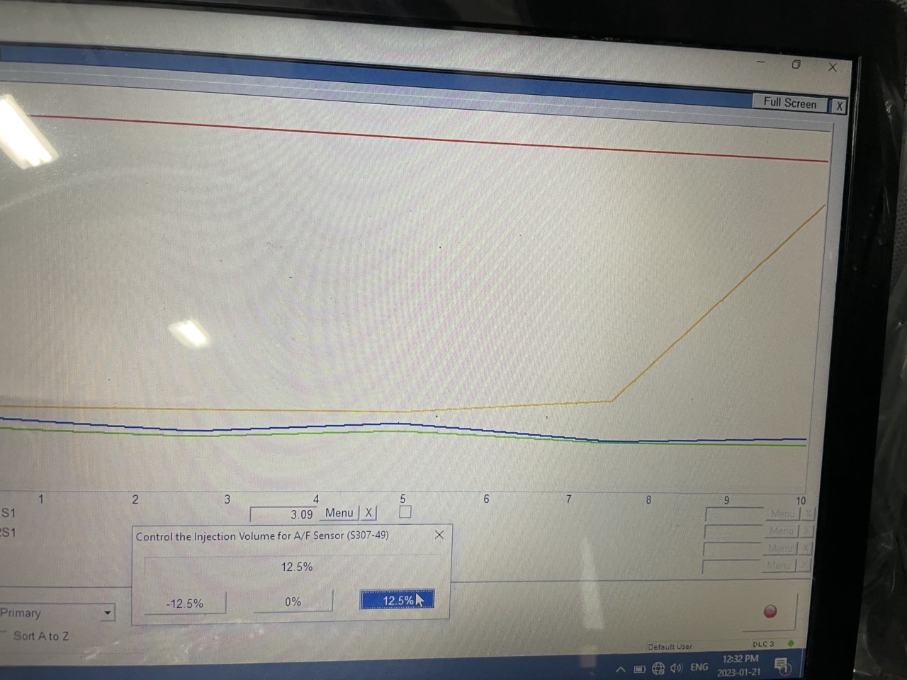

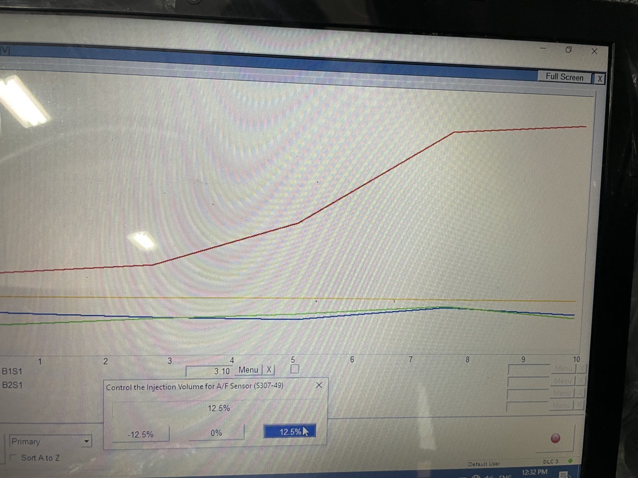

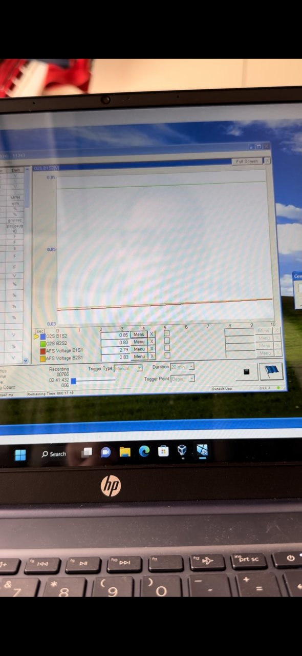

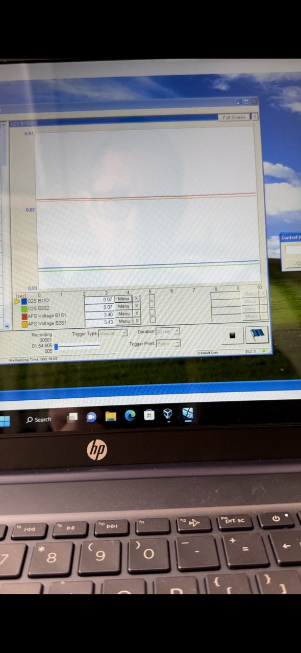

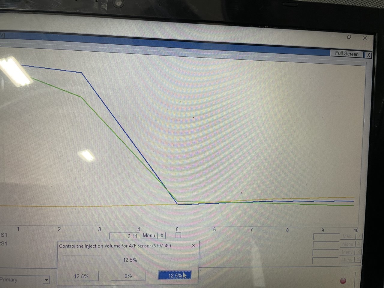

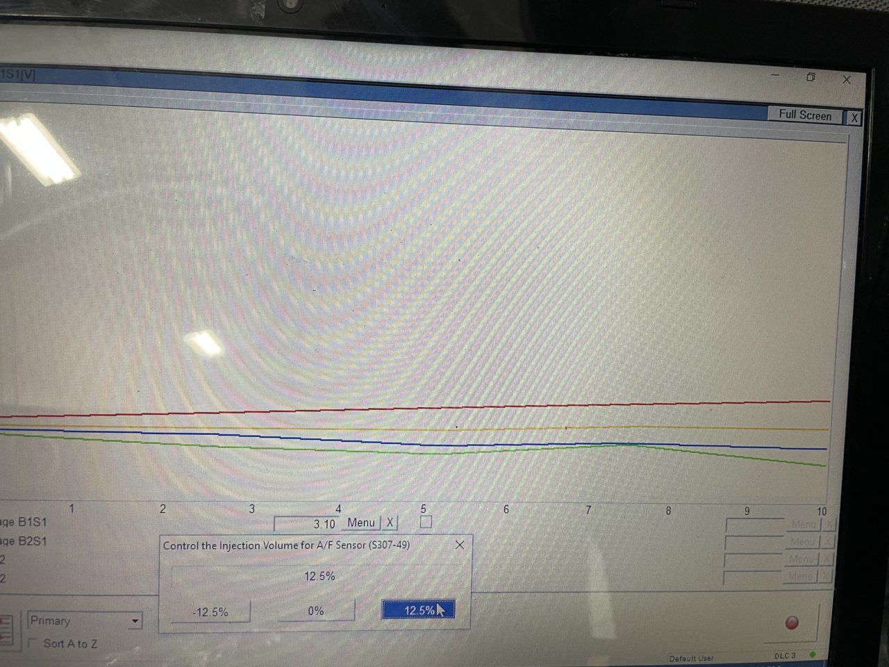

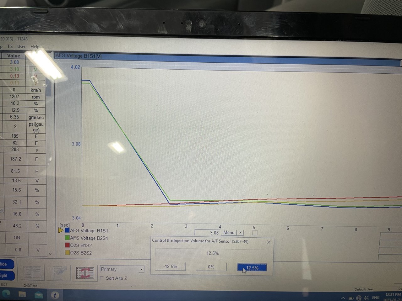

    Ok blue green is af upstream after being commanded rich from lean. They dive in voltage as response.
    The yellow and red are down steam o2 sensors. If the cat was bad they would rocket up in voltage to match the rich, but because the cats are working they aren’t seeing the pre cat mixture. So there’s a good delay until eventually they read rich like the upstream.
    im at work on my phone so I’ll elaborate more later. This was a 2007 with 260,000km taco
    E33475B2-76A8-4C51-8FDC-42C83C3EA53C.jpg F293F133-1755-442C-AB58-A5ACD7F79B39.jpg 447384B0-218B-4AA6-9DEE-C201E7307933.jpg AB6883E6-27BC-4A1F-81D3-1B1EA5A9C114.jpg 6DF31704-92E2-4D17-9395-615ABADA445B.jpg

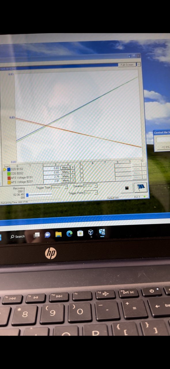

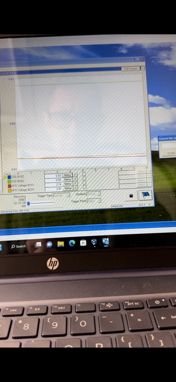

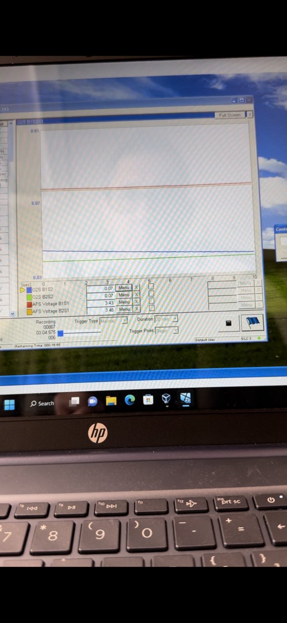

    Does this show anything? Ha. The check engine light turned off today I drove around quite a bit this morning.

    The screen shots are backwards

    So because both downstream sensors are instantly reacting to the fuel trim change, it means the cat is no longer performing. There should be a delay, but yours instantly went with the AF sensor.
    In my photos you can see how the o2 sensors stay where they are and it takes a few frames for them to come up.
    Bad news, but at least you know how to test the cats now. Good work!
