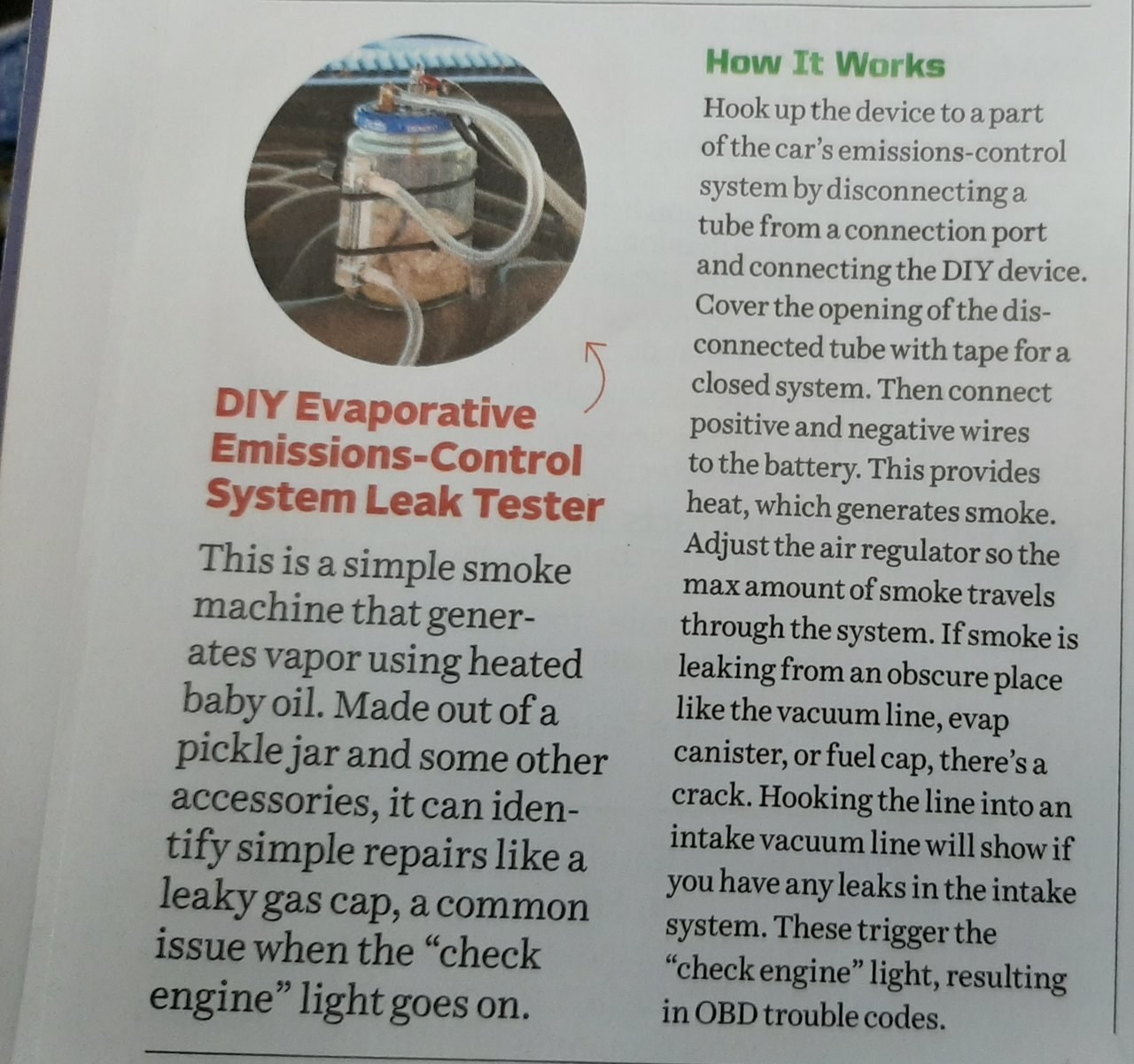

    Yes. I turned the output regulator as low as it could go and still pass air, then, plumbed in a"bleeder" to bleed off
    before the smoker. There was another valve to exit smoke when I squeezed a trigger. Thank made it a two person job so did not get very far that day.
    bleeder
