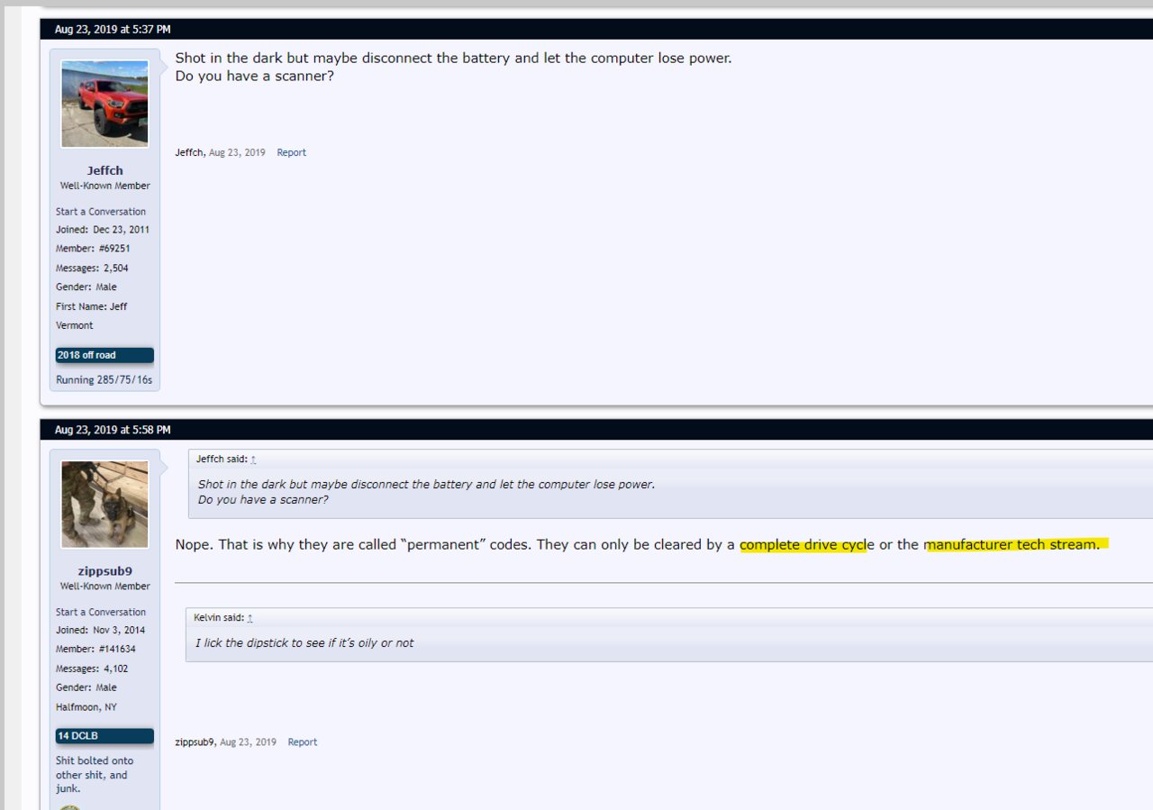

    I think you are right about techstream and permanent codes. Found a few threads on these types of codes.
    https://www.tacomaworld.com/threads/clearing-permanent-codes-emissions.511391/
    https://www.tacomaworld.com/threads/obd-permanent-fault-code.625848/
    And when i said early i was able to delete 2 of the 3 instances this is probably why:
    Reading the two threads it sounds like i either need to do the drive cycle or use techstream.
    Someone did mention putting the truck into check mode. Then maybe trying to delete it i guess?
    Another post on tundra forum saying the same:upload_2023-2-1_13-32-59.jpg

    Based on my experience with 2012 car, permanent won't go away after numerous drive cycles. As I said, lots of folks in your area have access to techstream and probably would do it for a 6 pack.
