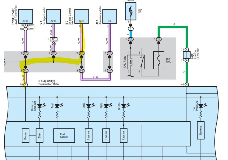

    Ok I’m going to test continuity on the violet/white between cluster plug C9 pin 19 and ECM plug E7 pin 8. And I’ll be thrilled if that’s the issue. However I’m probably unlucky enough that it’s the cluster. Is there any way I can test its output in a rudimentary fashion with a DMM? No oscilloscope for me.

    Correction violet/white is pin 2 on the cluster side harness. Regardless, there is continuity along that wire to the ECU. So is faulty cluster the only conclusion? What utility is there in removing the circuit board and looking for busted solder connections?

    The speed signal is a 0-5v square wave so not sure where the 10.6v is coming from unless your on the wrong pin or a module is faulty.
    Should be E7 Pin 8 at the ECM and C9 Pin 19 at the combination meter.

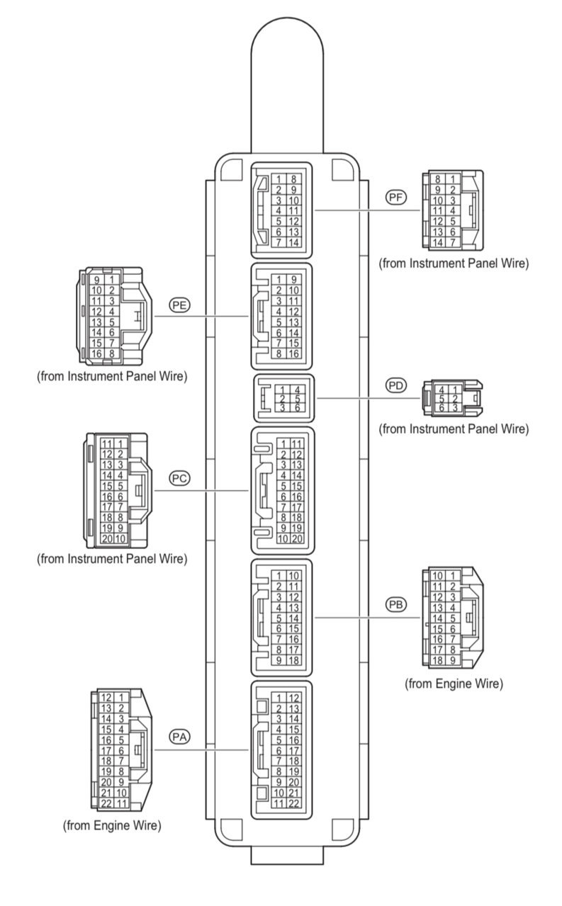

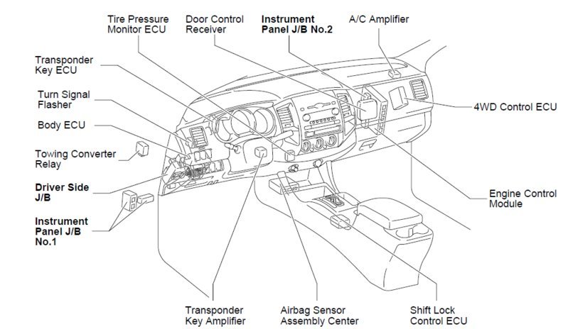

    Speed signal is also provided via the same wire to the 4wd ECU (if equipped), power inverter (if equipped), accessory meter (if equipped), and the TPMS ECU, so any of those theoretically could be pulling the signal wire up or down.

    Those are certainly the pins I tested. I was [am] confused since I’ve also seen the oscilloscope showing a 0-5 square wave. I have those options you listed; pretty sure they were all disconnected though while i was performing the diagnostic. I was having a concurrent problem with 4x4 not engaging, with the cluster lights constantly blinking, but I thought i solved it (or at least 4x4 now works again) by adding a wire overlay. There was some open ground I could never locate. In fact, I started a thread about it and all of you were kind enough to contribute. Mahalo!

    Well you could unplug the PCM and the cluster and see if the 10.6v is still there, if it is then something is shorted to power either in a module, harness, or connector.

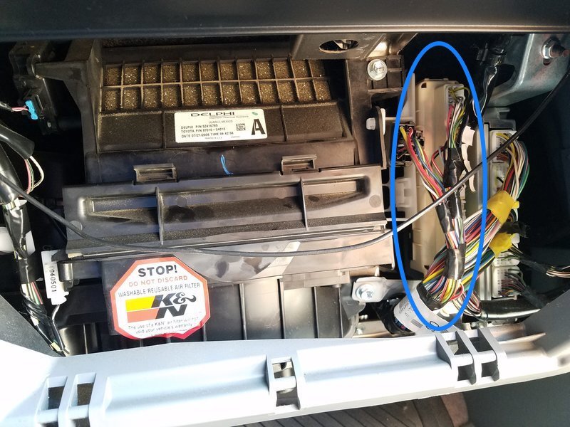

    I learned (strong exaggeration) a few new things today that may help. Using the DMM, when I test voltage at the PIN 19 on plug C9 on the cluster, I get ~4v (c9 male is unplugged and c10 male is plugged in). When I test the PIN 8 on plug E7 on the ECM, I have about 4.5V. When EITHER end of the harness is plugged in, to the ECM or cluster, and the pin out on the end of the harness is tested, I get ~10v. When both ends of the harness are plugged in, I now get ~10v on pin 19 (contacting the pin on the backside or the circuit board).

    I got to looking closer at this and it does use a 0-12v square wave so seeing 10.9V there is plausible.
    I went and looked at my notes from when I wrote up the 4wd system thread and I showed 0v on the SPD wire at the 4wd ECU when stationary and 0-12v square wave when moving, I have a manual trans but the SPD signal seems to be wired the same coming from the cluster.

    5V is about bottom of scale, the pulse is generated every 15.75 inches traveled. High end of the pulse is 10-14V for SPD signal. You likely just proved the 5V signal coming from ECM is functioning by unplugging and measuring that voltage.

    I would unplug E7 at the ECM and C9 at the cluster and take some readings.
    Check C9-19 to E7-8 ohm reading, should be zero or very low.
    Check C9-19-GND, should be infinite.
    You may have a short or a fault where the SPD signal splits out to the other modules (inverter, 4wd ECM, or accessory meter) via the J/B. If you have a ground, start by unplugging the connectors that send speed signal to the other functions and see if your voltage returns.
