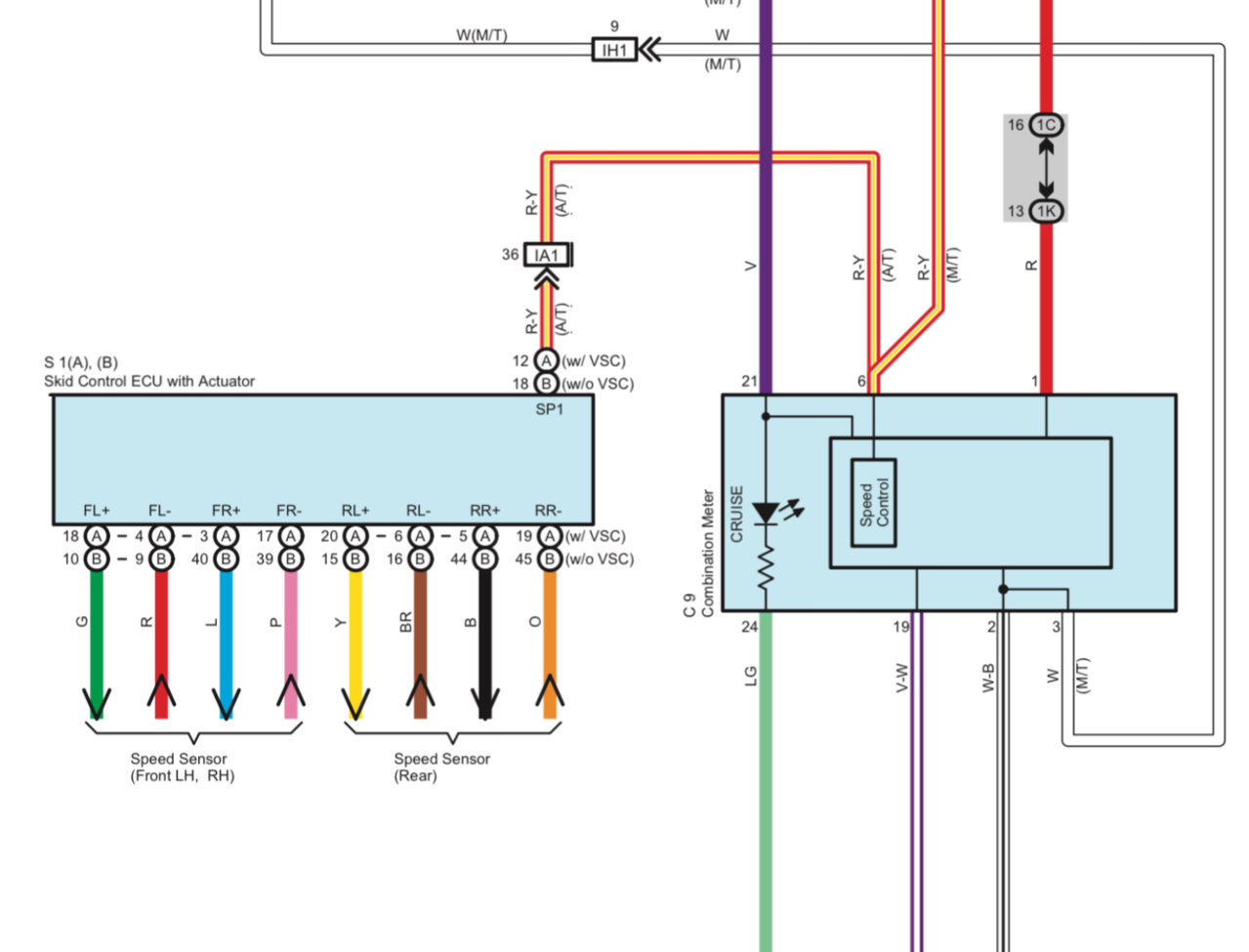

    The digram for the combustion meter doesn’t show it, but the speed control is certainly tied to the Cruise Control / light.
    Why it’s flashing? That’s for the other guys in here 6Gear and Dm93.
    Those 2 guys know much more about this stuff than me.B90584C6-59F1-4B61-BF65-9AFACAD4F69B.jpg

    I'm not sure, the cruise control and light is entirely controlled by the PCM. All the cluster does is receive the vehicle speed signal from the ABS module (A/T) or the output speed sensor (M/T), reads it for the speedometer, modifies it slightly, and passes it out to the PCM and other modules that monitor vehicle speed.

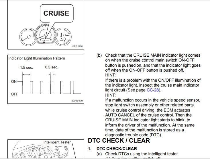

    This is the only place I see mentioning a blinking cruise light in service info.
    And whats a combustion meter?o_O

    A combustion meter shows the current state of my frustration.
    When it reads full, those around me should take shelter. As there will soon be a fit rage with objects flying through the air that may cause serious bodily injury.

    You mean C9 Pin 19 right?

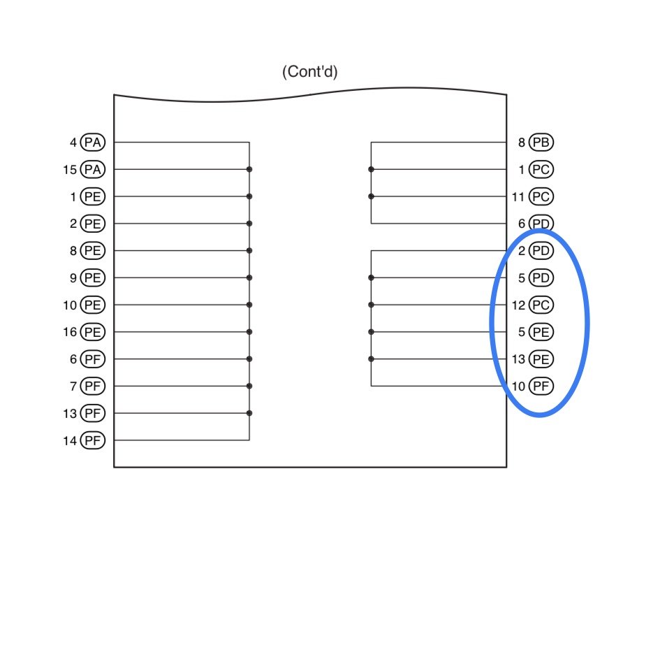

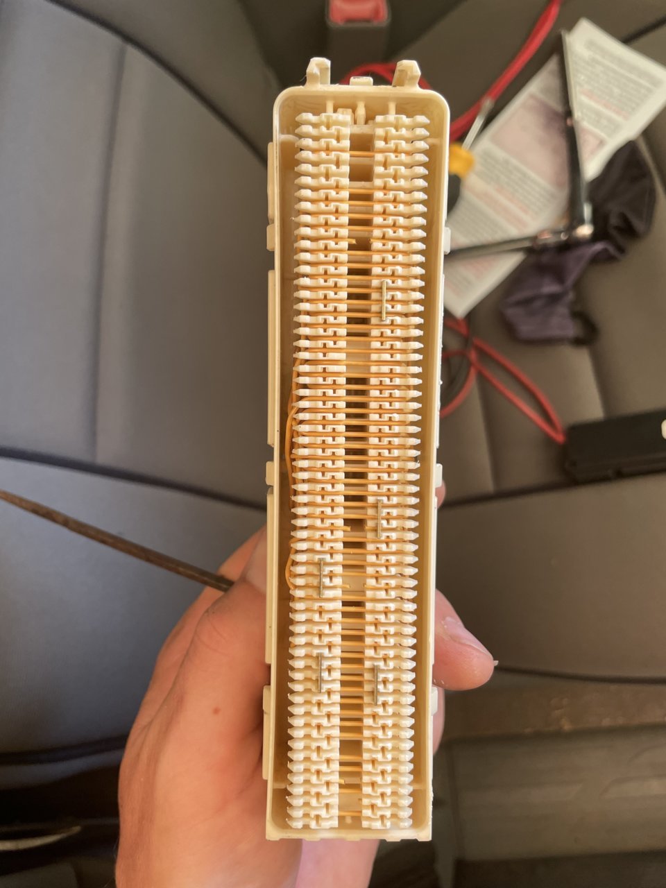

    DE478939-86C4-4A87-9BA8-BB70353EFABF.jpg The jumper is certainly a straight shot, but the original wiring is also still plugged in. So my multimeter says I have continuity in the harness from the cluster to the ECM, and I have a good signal from the cluster to the ECM as made evident by my jumper experiment, what is happening?
    Side note, anyone ever look inside the j/b 2 next to the ECM? Decided to pop it open considering the circumstances. It’s odd to me there are so many breaks in the wiring - some of them have jumpers but some don’t. There’s also jumpers on lines that aren’t even cut? Going off on a tangent here..

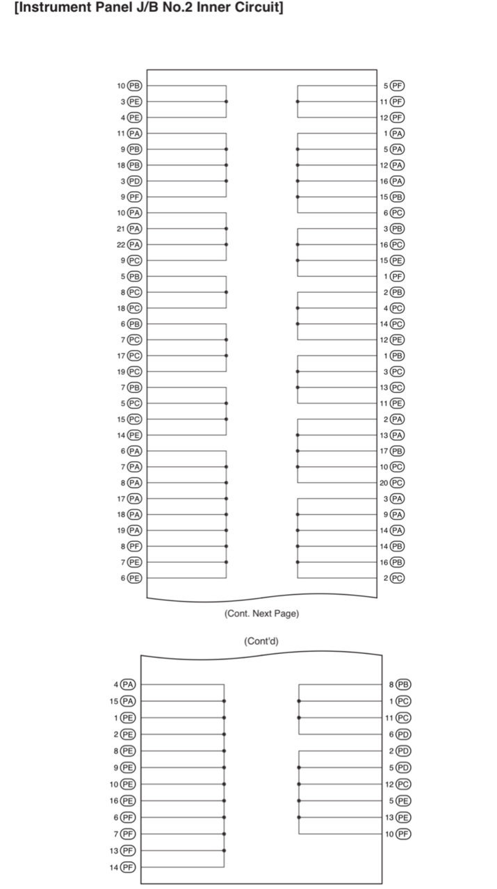

    I have not taken a look at it.
    But you are dealing with the lower right hand corner in the picture below.
    see how they are all “spliced” together?
