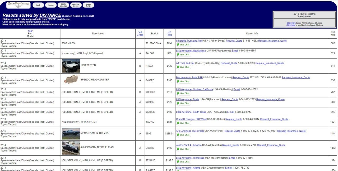

    just a heads up... a used cluster is $75-$125 on ebay or car-part.com, and programming the correct mileage is $90..

    I’m having a hard time finding one for a manual truck.
