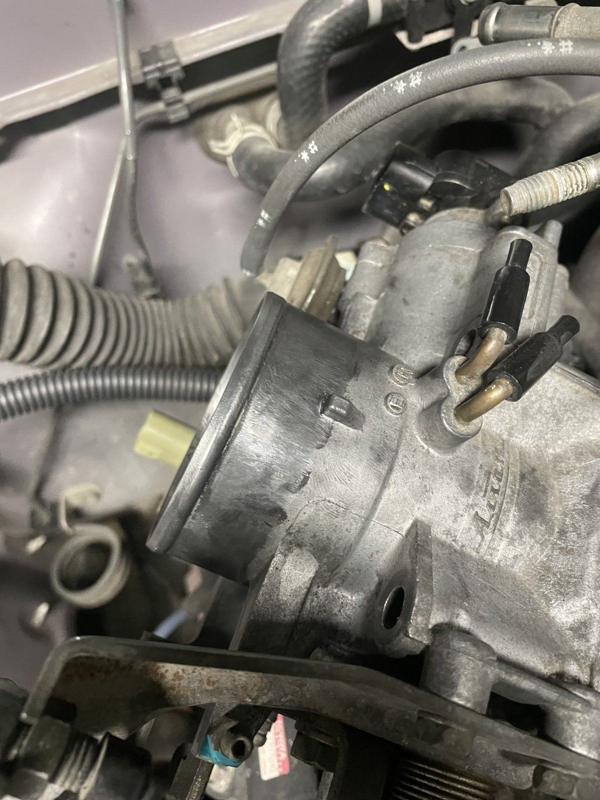

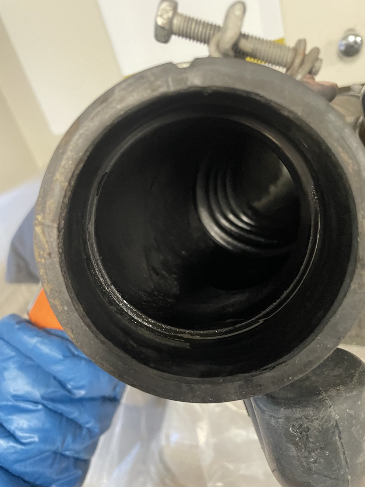

    ok i don’t know if this a red flag or not, but i just took the TB off and it looks like it’s getting so hot to the point where it’s melting the rubber from the intake tube…
    is this normal or should i be concerned??

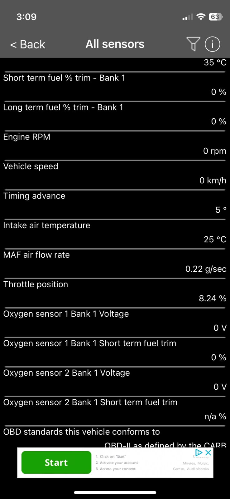

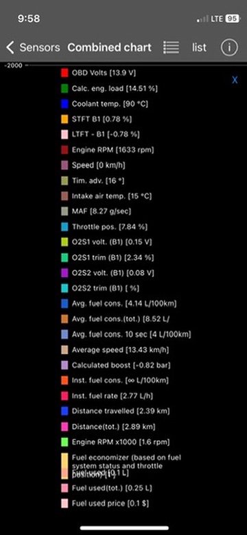

    Here are the numbers from my scanner, anyone see anything wrong with these?

    One thing I know can cause a different idle each time, or an abrupt idle change as it warms, is a dirty or damaged MAF sensor. You cleaned the wire only with MAF cleaner, right? The reading is the same every time, or at least once it warms up? The spec on mine is fully warmed at idle it should be 3-5 g/sec, and at 2500 RPM it should be 13-18 g/sec.

    MAF looks high for idle, but it says 1.6krpm so that's probably right. Fuel trims look fine. So air/fuel is fine, you're just ingesting a lot of air

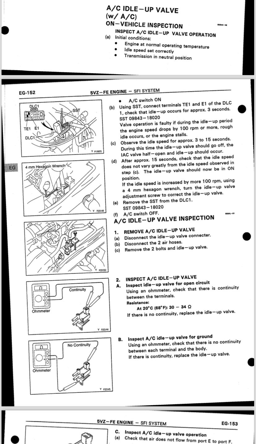

    Do you have A/C?

    Does the throttle body melting the rubber intake concern you? I didnt notice this until I had it re-bored

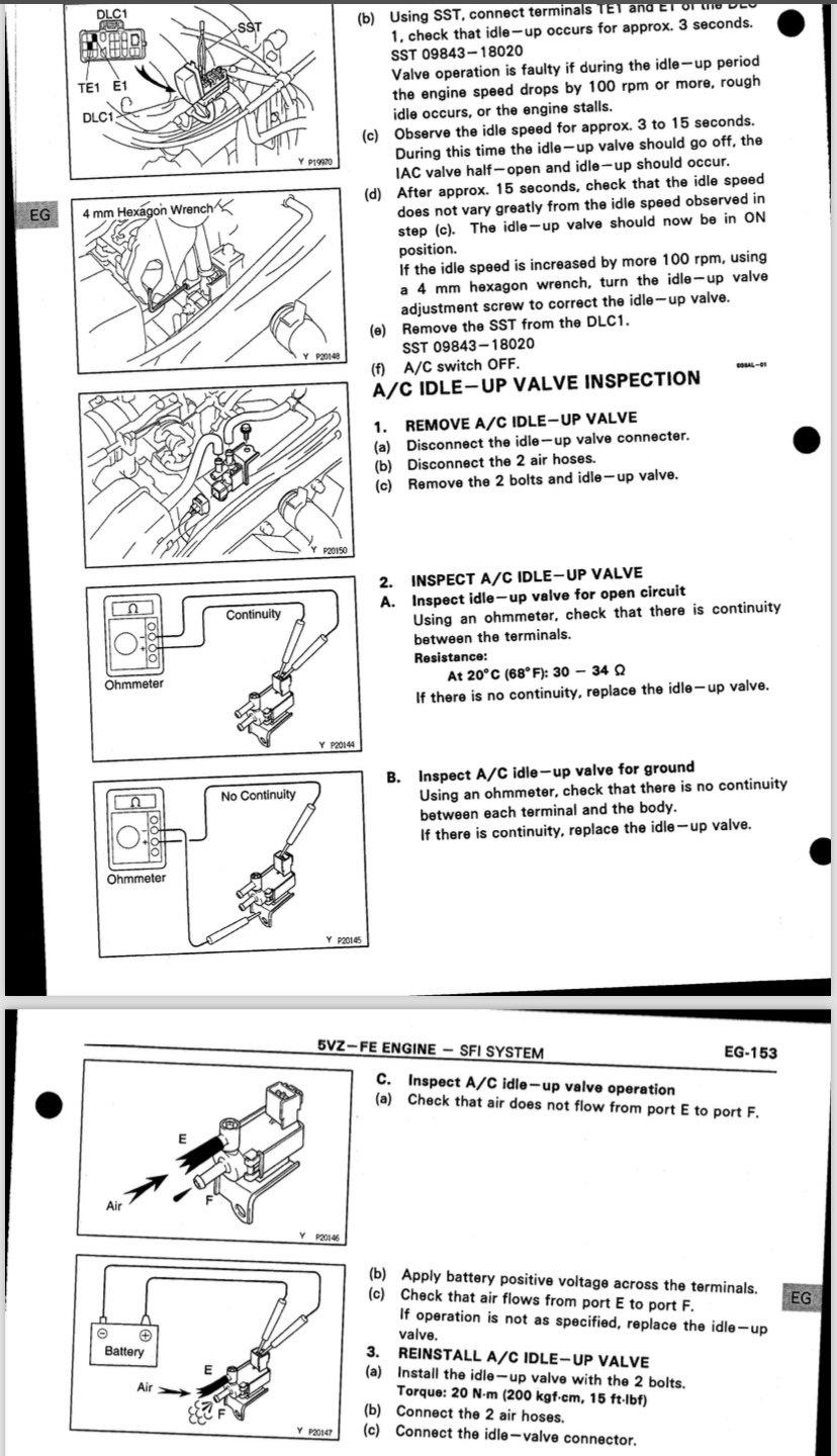

    Have you checked your AC idle up valve?
    If that is stuck open, which is the typical failure mode, then you will see your idle about as high as you have it.
    here’s how to check

    I think you'd have to confirm that it's actually melting due to temperature, and not a reaction to something you may have used to clean the throttle body, or residual oil from the rear head vent.

    Awesome thanks, I have not checked it, but I'll look into it. Seams somewhat complex for someone like me since I don't know how or have the tools to check circuits and such. Also, AC seams to have no effect on my idle so would the AC idle up valve even matteR?

    Not really. That's more likely due to oil deteriorating the rubber than actually melting

    I did notice some oil in the TB
