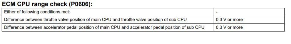

    The ECM code is for an internal fault.
    There is a Main CPU and Sub-PCU inside the ECM.
    There really isn't anything to check outside of opening up the ECM.

    That's crazy.
    But perfectly reasonable by todays standards.
    Who would think a throttle valve discrepancy code would be caused by faulty O2 sensors (or in this case missing)
    That's service data for you.
    This is where in field experience takes the win.
