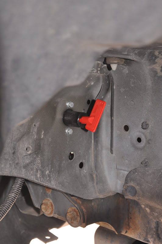

    I used getusedparts.com to find the part. You fill out the form on their website for the part you need and they send it out to a network of used part dealers and junkyards. Whoever has the part will contact you by phone or email. I got about 5 calls and 15 emails within 24 hours of my request. The entire process made me a little nervous, but it all worked out when I got the part installed and the truck ran fine. Unfortunately I cannot remember the vendor I acutally bought the part from, I believe it was something like Smart Auto Parts. All the prices were similar, I just picked them because they called me directly and seemed to be the closest to me, although the part ended up not actually being shipped from where their office was located in Texas.
    Here are some pics of the switch I installed while I waited:
    Here is the switch assembly prior to install.
    Heres the switch located under the wheel well.
    This is looking up from the ground at the switch assembly.
    This is the key to the switch
    I ran the wired through this gap next to the head light.
    Heres a shot of the wood spacer I made to fit the Optima in with the factory battery clamp.

    excellent! :yay: Thank-you for the info and very good pictures of your temporary switch. Just filled-out the form on the website. Do you remember the price you paid?
