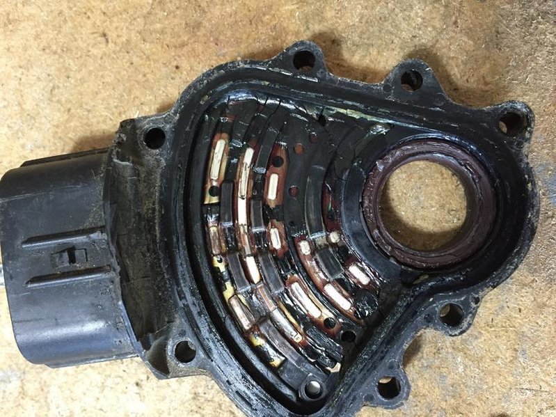

    I don't want to jinx myself, but I belive I resolved the problem by replacing the neutral safety switch. I've had the "new" one on the truck for 2 days now and it hasn't happened once whereas the delayed shift would happen a couple times a day.
    I found a junkyard in Sacramento with a 2006 tacoma and had them pull the part for me. Cost me $90 including shipping. The dealership wanted about $250 for a new one.
    For reference, this is the part I replaced:
    Since it is riveted shut, I am going to cut the bad one open and investigate to see if I can see a problem. I'll try my best to cut the rivets to allow me to bolt it back together if I fix it.

    There is a printed circuit board inside . One of the circuits will be trashed and black from water intrusion . I have taken many of them apart .
    Every time you had a delayed shift , there should have been a soft code set in the ecm memory . Put the truck back in park and the ecm then knows whats going on . The park circuit is going to be fine when you get it apart as your truck started fine

    I really want to see the inside of that switch. Those rivets should drill out pretty easy. They look like aluminum rivets.

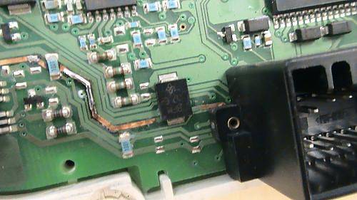

    Not the actual switch but this will give you an idea of what happens when the board circuits go for a crap . Why manufacturers ever put these type of controls under a vehcile is beyond me . Water finds a way in .

    gear cruncher you were right. A lot of black gunk in there actually.
    I have no idea what i am looking at, but do you think if I wiped all the grease out and put new dielectric grease in, this unit could still work?

    Yikes , That board looks horrible . It,s hard to tell by the pictures but looks to me like some of the copper is missing in the park - neutral range . I wouldnt take the chance of trying to run it again . I suppose if you put it back together and try the resistance test to see if it passes ?
    Dont remember if you had a multimeter , but the resistance values are listed at the bottom of this pdf
    http://www.customtacos.com/tech.old...06toyrm/06toypdf/06rmsrc/rm2006ta/0270013.pdf

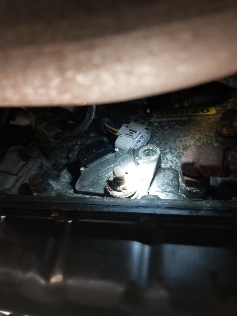

    I need tips on how to get this switch off my tranny. I have the wiring harness off, the 12mm bolt off and the 22mm nut off. Been trying with 2 screw drivers to get it to pop off...no luck.
    2007 Tacoma. Automatic 4x4.
