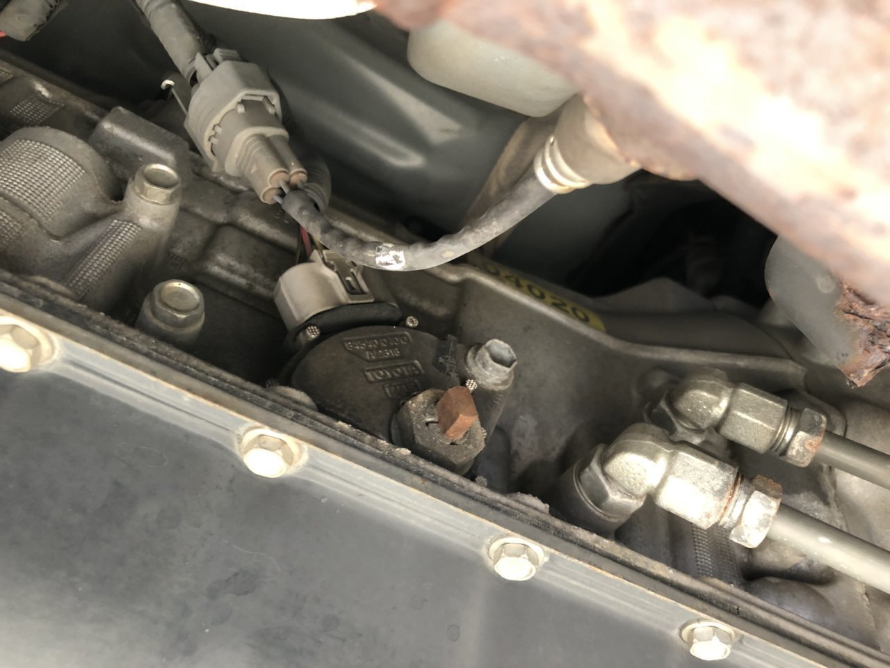

    Has anyone had to replace the neutral safety switch in your truck?

    Yes. Most of the time it’s at the connector.
    Unplug the connector and see if there is corrosion on any pins.
    It’s not always that, but it’s the go to first spot…….

    The connector is under the dash on the left side right?

    No. It's on the side of the transmission.
