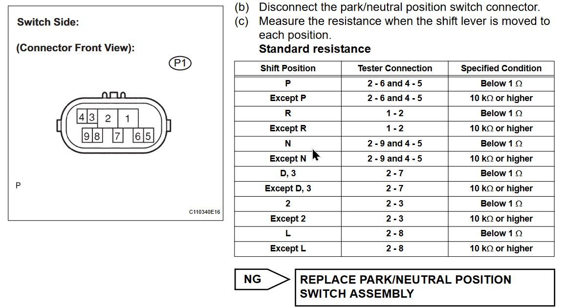

    P0705 - Transmission Range Sensor Circuit Malfunction (PRNDL Input)
    Either of the following conditions is met:
    (a) Any 2 or more of the following signals are ON simultaneously. (2-trip detection logic)
    •Park/neutral position switch input signal is ON
    •R input signal is ON
    •D input signal is ON
    •2 input signal is ON
    (b) Any 2 or more of the following signals are ON simultaneously. (2-trip detection logic)
    •3 input signal is ON
    •L input signal is ON
    MONITOR DESCRIPTION
    These DTCs indicate a problem with the park/neutral position switch and the wire harness in the park/neutral position switch circuit.
    For security, the park/neutral position switch detects the shift lever position so that the engine can be started only when the vehicle is in the P or N shift position. When the park/neutral position switch sends more than one signal at a time from switch positions P, R, N
    or D, the ECM interprets this as a fault in the switch. The ECM turns on the MIL and store a DTC.
