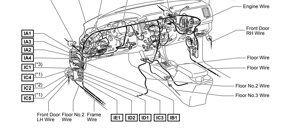

    Those codes all have to do with EVAP pressure sensor, need to check the wiring between the sensor and the ECM.
    I think I'd want to be checking Connector ID2 behind the left kick panel first as the wiring for both the fuel level sensor and EVAP goes through there.
