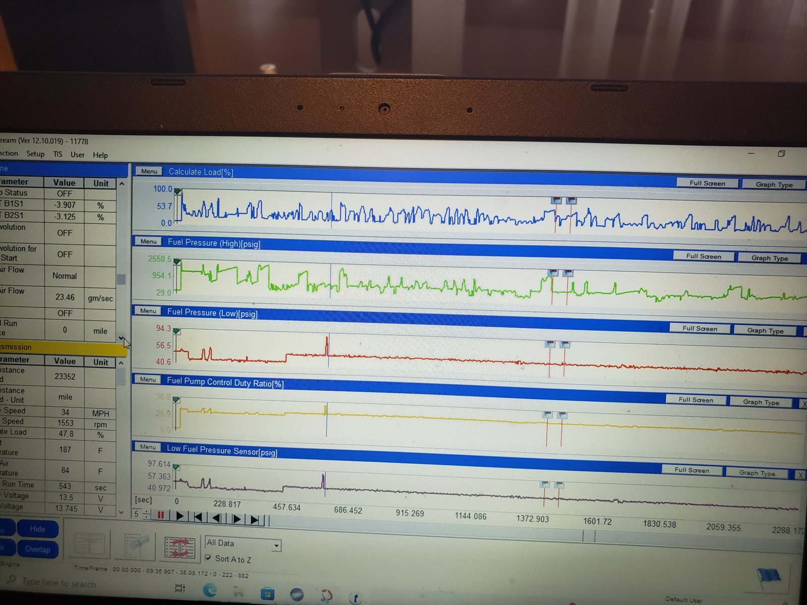

    Here it is running
  17. Dec 6, 2023 at 6:12 AM
    #37
    Hagd_tac
    Hagd_tac [OP] Member
    Nov 21, 2023
    #437925
    21
    2017 trd or dcsb
    To me it looks like a normal pressure reading? It's not showing 49 psi like the freeze frame. Busy with work lately haven't had time to do anything else really. Also the CEL is still gone, I never reset it. :confused:

    Freeze frame(FF) is set when CEL is triggered.
    Try to trigger CEL by setting up conditions found in FF.
    Looks like you were pressing the pedal around 60%of engine load.
    So add those PIDs to the dash board.
    ECU will clear CEL on its own. There is an algorithm described in service manual
