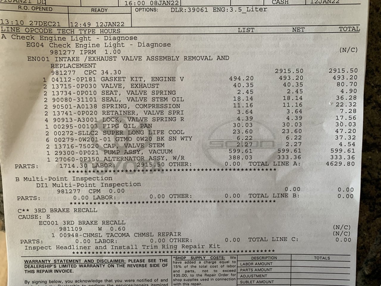

    I wish/hope that it is something far more simple than what they are suggesting. Here is the exact description and they really don’t specify whether it’s the intake or exhaust valve.
    Found abnormal compression results. Performed leak down test. Found 80% leak down on cylinder #1. Air is coming from tail pipe. Most likely due to bad valve seats. Need to replace passenger side cylinder head and all exhaust valves.
    The thing that gets me is the truck is running fine and shows no signs that something is wrong. I averaged 19 mpg on my last tank of gas. Crazy!!

    I picked my truck up Wednesday. Here is the list of work they did. But yesterday I noticed a squealing from under the hood at anything above idle. So I'm not sure if it's a belt or a pulley. If it ain't one thing, it's another.
    At least yours is covered by warranty. I just dropped $5K out of pocket on a 4 year old truck with less than 100K miles. I pray I don't have another repair for a long time.

    Jesus!! Did you need an alternator too?
    the $1500 warranty seemed silly at the time of purchase but now I don’t regret it at all.

    I mean that's what it looks like on the last line. To be honest, I didn't ask too much once they had to pull the motor. I assume that's what they would normally do.

    I’d question it, unless you authorized it looks like the replaced it without talking to you about it.
