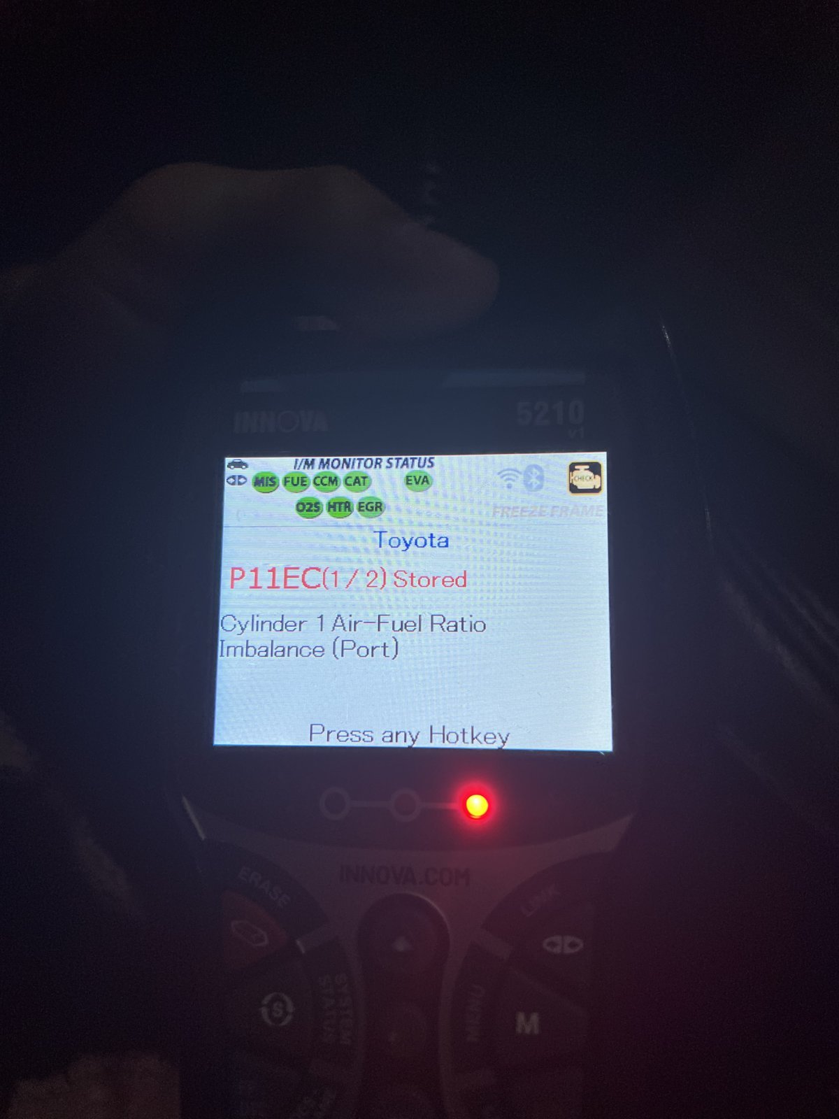

    Dear fellow Tacoma owners, I recently had a P11EC code diagnosed on my 2022 Tacoma. It drove just fine but my cheap code reader would would clear it but it would just come back on. I took it into a dealer up in N. Texas and they said it was bad gas and that the #1 cylinder fuel injectors were bad. So, I had the injectors replaced by the dealer not under warranty. I was no further than 2 miles down the road when the light came back on. What the hell! those dang guys didn't fix the problem. When I got home I put my expensive code reader on my truck and it said to take it in. Ugggh! Then I took my Tacoma into another dealer and within 15 seconds they told me that I had a sucked exhaust valve. I'm thinking what the heck did I just fork out $1700 dollars for? Under warranty the dealer replaced the passenger side head and #1 cylinder valves. Giant major engine work but no light since. So the first dealer misdiagnosed the problem and I was subject to a wallet tap!? I went into the original dealer and told them the story and basically too bad so sad. Nope!!!! Not good enough. Tried to contact the GM of the dealer.....crickets. Miffed, I sent a letter the the GM of Gulf States Toyota outlining the issue and eventually got a decent partial refund but I now own 2 brand new injectors that I shouldn't have to own in the first place. Take it from me and my experience beware of..... its bad gas....P11EC code in my case was a sucked exhaust valve. AND after internet surfing the issue, I'll lay the diagnosis clearly as the exhaust valve and the injectors as a money tap to my wallet.
