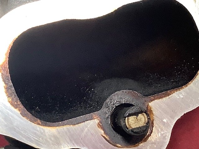

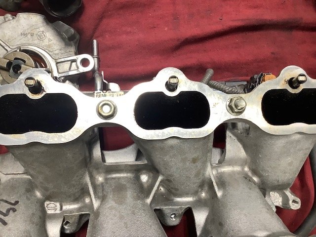

    It’s blowing “clean” air back into the intake though. So don’t think it adds to the build up.

    It's not that clean, check out this picture of my intake.
    Many Tacoma owners aren't aware of this problem so how do you know it's not happening with Lexus vehicles?

    By clean I mean air that hasn’t been through the combustion process yet. It was fresh air from the intake sucked in on the intake stroke and blown back out on the compression stroke.
