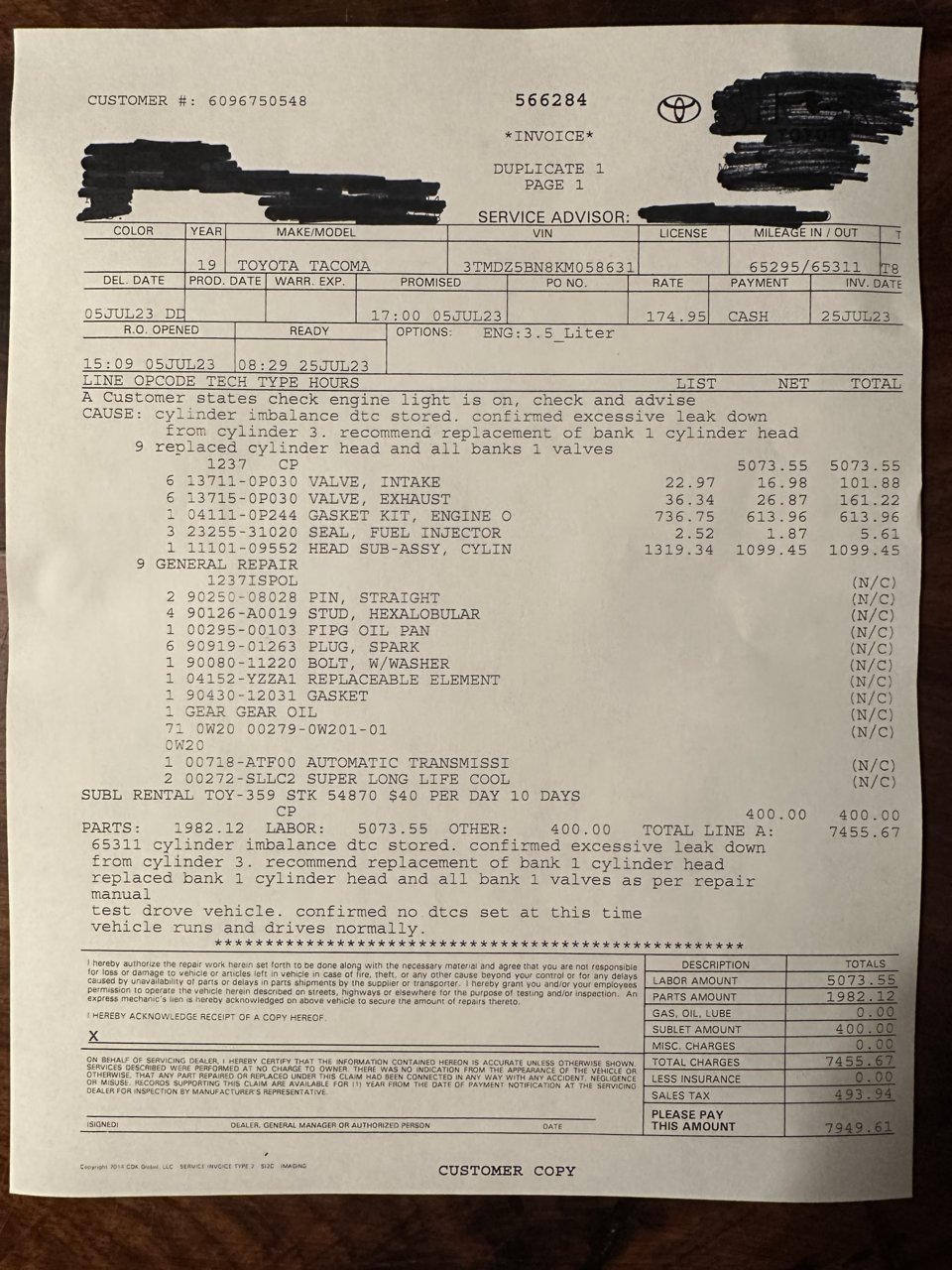

    I definitely wanted to keep you all posted on the outcome. sorry it took so long. I literally just got the truck back yesterday from Toyota. I’m attaching a copy of the invoice showing parts and labor. Shows replaced bank 1 cylinder head and all associated valves. To be honest, not completely sure what that means. I asked the service rep for a detailed description of repair and she said the mechanic working on it usually takes very detailed notes, but this is all I got. Anyway, if you have the time, just wanted to make sure all that needs to be done was done and that it was done right. I’m just very concerned that there will be future issues. The rep said they’ve been seeing this much more often with this year and also said so far no call backs after repair… so far. Truck seems to run good. Definitely better than what is was. Only thing I noticed is mpg hasn’t gone above 14, which sucks and throttle response doesn’t seem as good as I thought it would be, but unfortunately don’t have another 2019 Tacoma to compare it to. Is that normal? 285 17r 16s on it, so I knew that would effect mpg but should it that much? (Regardless of speed highway or street still stays around 13 to 14)
    Anyway, I appreciate all your help. Definitely helped me out a lot with all your replies. Right now I’m still aggravated with the dealer I bought it from. It’s pretty obvious this was a pre existing issue. When I brought truck in originally they said they would take care of it. I told them they needed to take it to a Toyota service center after they failed to repair it. which they did. But they did it through the extended warranty I had purchased without my knowledge or consent. Just seems real shady. I feel it should have been their responsibility. You’re talking a pretty big repair bill they dodged the bullet on. Nothing out of pocket for me (luckily no deductible). I called the warranty company as well and talked to 2 different reps there. Both said although it raises some red flags to have a repair that major a few days after purchase, but they said they did do a pre sale inspection on truck and everything was legit and I should take it as a win. Hmm. Not really feeling I won. Just curious what you all would do in this situation, based on the repair and potential for future problems. I’ve always had Toyota trucks and never had any issue. But this one is making me nervous.

    cberr
    cberr [OP] Active Member
    Dec 4, 2013
    #117872
    26
    south nj
    3" lift, Airaid CAI
    Sorry. Not sure if I uploaded invoice. Let me know if I didn’t. Thanks again everyone!

    Wow that was a close one. Happy that the warranty got you covered bud.

    It should be fine after this repair. My 2018 Jeep had the same repair for similar reasons and never had the problem reoccur. That said, if you're not happy driving it or are worried that it's going to leave you somewhere then you have your answer regarding what you need to do. It's like when you have a job you hate. You wake up every morning hating the fact you have to go in and it's impossible to enjoy your work. You don't need a truck that makes you unhappy or worried every time you drive it. It may not be a logic based decision, but IMHO you should enjoy what your drive. Wait a bit, see how you feel. If you still feel like you do now, swap it out for something else. And if you do decide to get something else, don't go back to that Chevy dealer! LOL

    Damn. $175 rate is the daylight robbery

    Aha, gm dealer I worked at was cheapest in town at $200/hr
