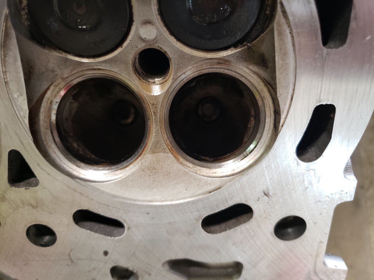

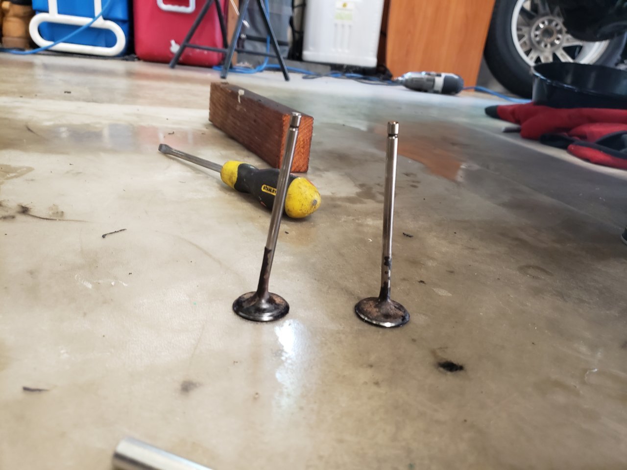

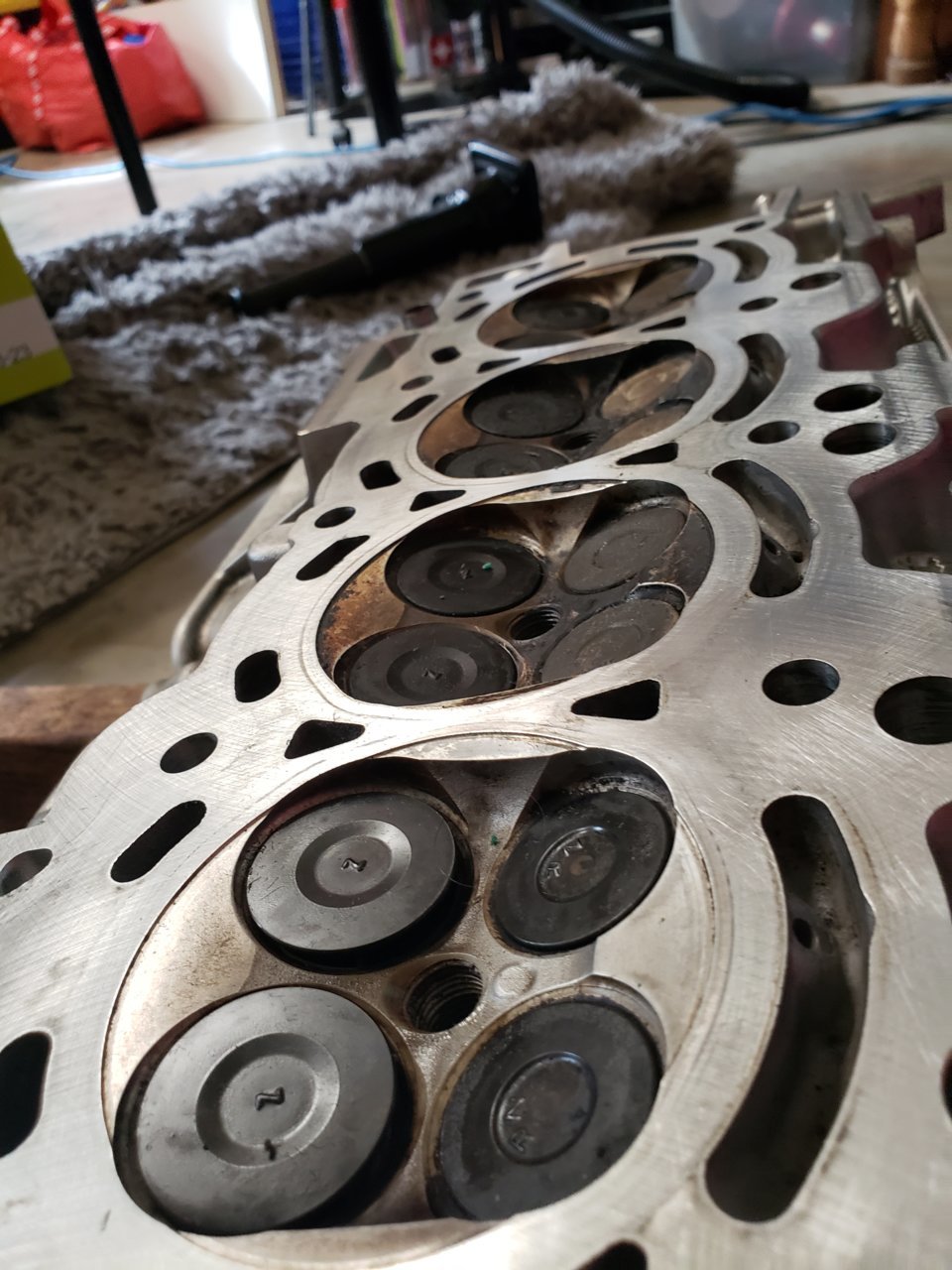

    The carbon buildup is minimal on intake valve seat face and won't cause the leakage. You'll see more buildup on intake valve stems.
    Here is toyota head and intake valves from the engine which intake is always full of oil.
    Junkhead likes this.
