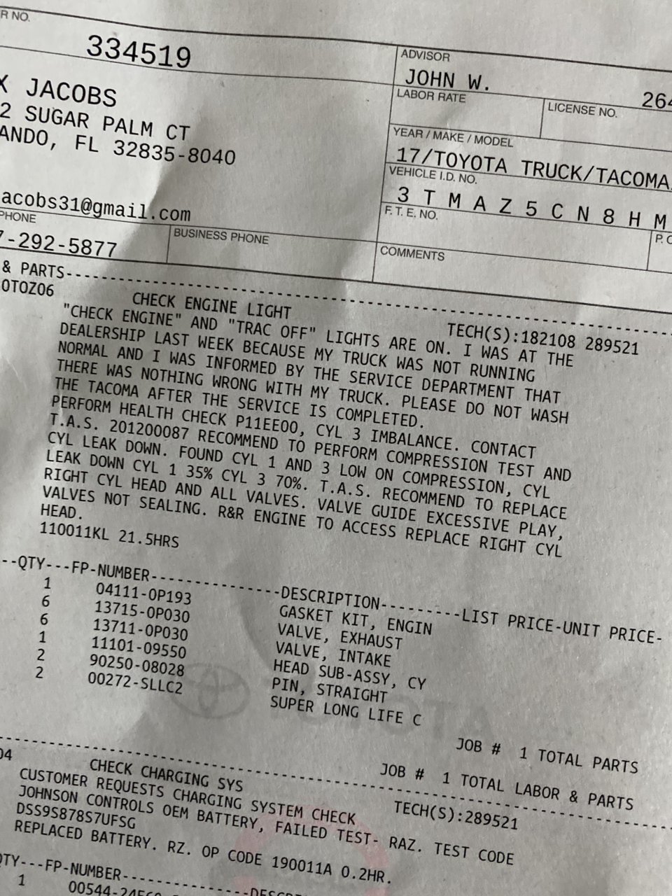

    Hey everyone! I have a 2017 Tacoma SR5 with 36k miles on it. Recently the “check engine” and “Trac off” lights came on. When I brought it to the dealership they informed me that the codes read “your DTC codes are as follows
    P11EE00 #3 cylinder imbalance
    P160500 rough idle”
    Below is a list of all of the parts being replaced under warranty. Has a home else had this problem? The truck has been serviced by Toyota every 5k miles.
    04111-0P193
    1EA HEAD GASKET KIT $ 560.14
    13715-0P030
    8EA EXHAUST VALVES $ 214.00
    13711-OP030
    8EA INTAKE VALVES $ 134.64
    11101-09550
    1EA CYLINDER HEAD $ 1110.96
    90250-08028 2EA STRAIGHT PIN $ 4.02
    PARTS TOTAL $ 2023.76
    LABOR TOTAL $ 967.93
    JOB TOTAL $ 2991.69

    I’ve read a few members have so your not the only one...the codes tell them where to look a compression test and or leak down test would confirm a burnt valve which sounds like what you got.

    Here is a picture of what I had done.
