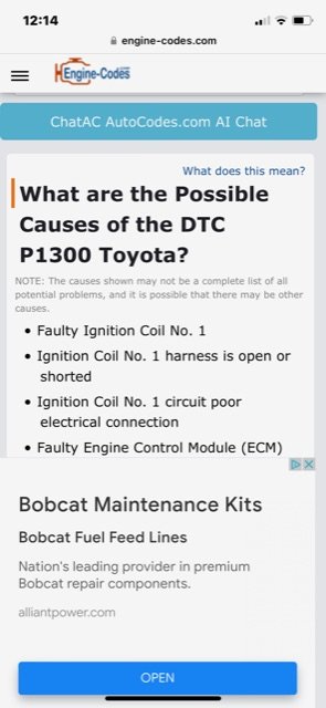

    Hope this explains and helps…

    Got new denso coils and spark plug wires and no change. I went through the list on the pdf and ecm seems fine. I thought for sure it had to be that. anymore suggestions?

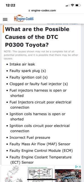

    I don’t think this is a misfire
    You would throw a P0300-P0304
