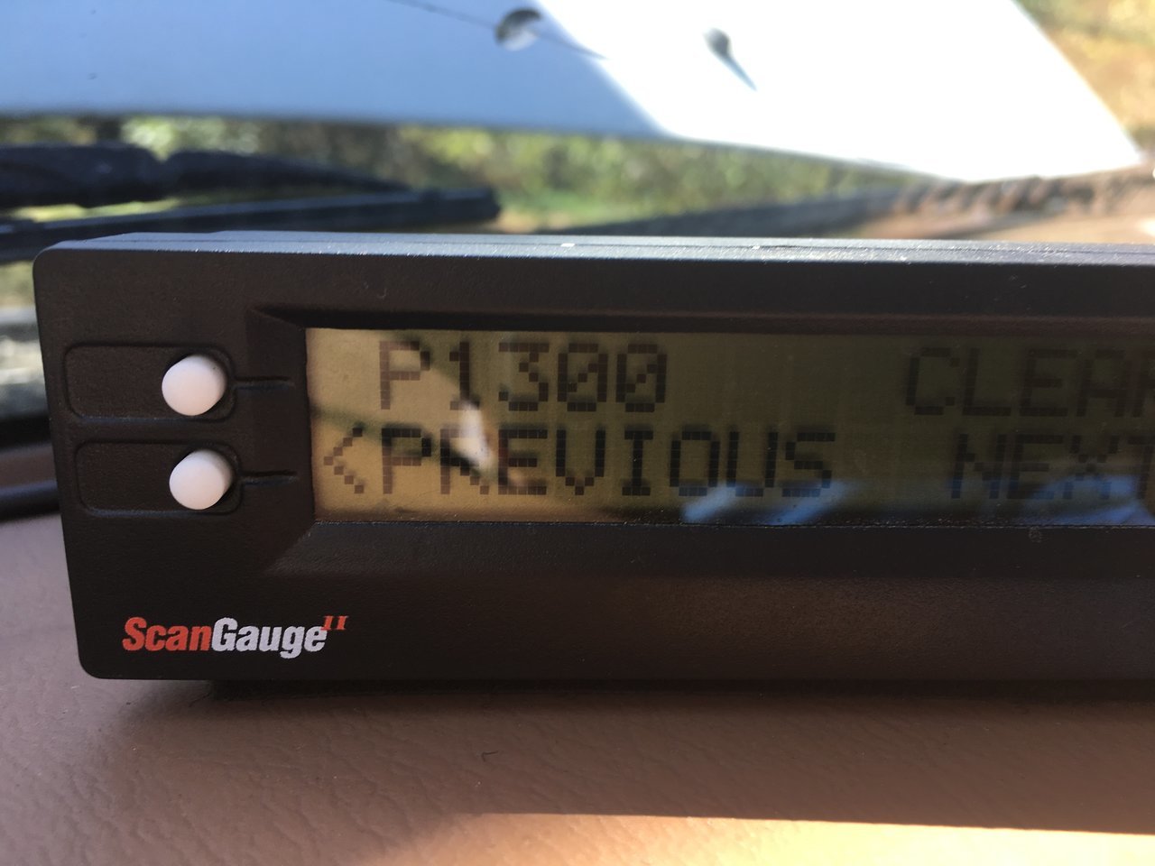

    Hi, new here and need some help.
    I recently bought a 2000 TRD for my son knowing it had recently had a P1300 code (Igniter Circuit Malfunction), where the PO had changed the coil pack and said he had no further issues. We paid $3,500 for it, making it more than worth it to do some baseline maintenance. Custom front and rear bumpers, sliders, factory e-locker, BFG ko2 @ 90%, 286K.
    Anyway, CEL comes back a week or so later, and it stalls a couple of times while at speed over the next week. Change all three coil packs with factory Denso, new NGK wires, all good for a bit and then CEL is back with another stall at speed.
    Install new NGK spark plugs, noting the old ones had some oil contamination, particularly cylinder 1. Starts very rough, then won't start at all. We do the entire valve gasket procedure as there was obvious leaking, and clean oil out of the spark plug tubes (presume leaking plug gaskets as they were most likely original). 4 of the new NGKs are oil fouled, so install an entire new set expecting everything to be good now, and no change. It seems to fire and then dies, but only once unless you take the Key back to off and start over. It will just crank without firing at all after it dies.
    https://vimeo.com/234583203
    Engine flooding due to the new plug fouling seemed likely, but the plugs aren't covered in fuel pulling one back out to inspect and the usual tricks to overcome flooding aren't bearing any fruit. So outside of the valve gasket job and cleaning up the spark plug tubes, the only change was the new plugs and it had the NGKs in there before, although was time to change them.
    Changed the battery and have checked the EFI fuses. Appreciate any thoughts as to what this might be as it seems a big coincidence that something else failed given the P1300 code makes total sense with oil in the spark plug tubes prior to the valve gasket job. Yes, plug gaps are good.
    Thanks!

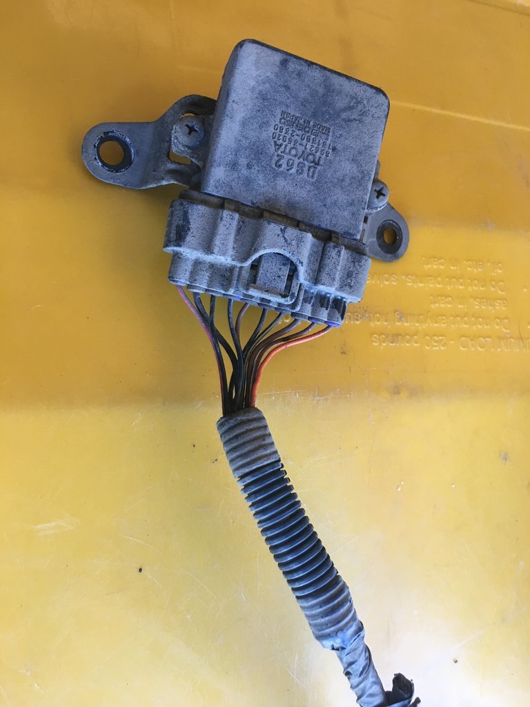

    So I think my issue is obvious, and it was pulling the intake tube finished off this already loose igniter wire, turning an intermittent problem into what I have now.

  9. Sep 20, 2017 at 11:13 AM
    Glamisman
    Glamisman Well-Known Member
    Oct 22, 2016
    #200436
    4,665
    eek... how are you going to fix that?

    I accidently squashed a connector on my truck when i dropped my intake on it doing valve covers.
    If you're a patient man you can take the connector apart, 1 wire in your case. That waterproof rubber piece slides back, you gently unbend the metal clip with some fine picks and maybe a rally small screwdriver, skin the wire back and reassemble, being careful to not warp the clip into something that won't go back into the hard shell connector.
    I thought it was hopeless and was just going to cut the whole thing off and butt connect and shrink wrap another from someone willing to cut up a harness from salvage.
    'Til I couldn't get anyone to part with one.
    Edit: The metal clip comes out the front of the connector, make sure you slide the wire though and do all your work on that side or else you won't be able to reinstall into clamshell. (the clip part)

    ^^^^thanks. I still had some wire available as it broke off below its rubber fitting, so I melted solder down in the connector, then stuck the solder gun point in to melt the pool and quickly stuffed the wire back in. We have ignition and the connection holds as I tried to pull it back out (gently).
    One final P1300 to clear...
    I will still pick up a harness end and igniter (might as well have a spare) from salvage as I can wire in a bit of slack that way and I'm not sure I trust this fix for the long run.
    Thanks for the inputs - hopefully this thread will help others. It could hardly have been more obvious, but my first time digging through one of these systems and obvious often arrives late.
    cruiserguy, tomwil, DrZ and 1 other person like this.

    Appreciate the offer :cheers:. Scored this off a '99 4Runner yesterday. Whole thing was $5. Usually just the igniter is left when people pull the engines, but for some reason this part of the harness was cut and left.
    Not super stoked to reverse a fully functioning repair, so may let it ride for a bit since the connection is hand test solid.

    I did end up splicing in the new harness. My fix lasted about two weeks and pulled out again. All is well and I have a spare ICM that works for both the Tacoma and our ‘99 4Runner. Not bad for $5.
