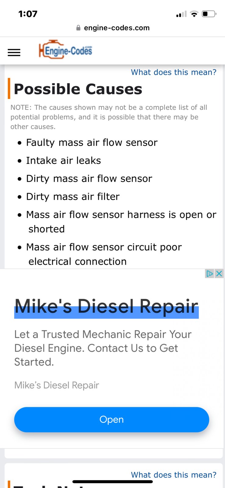

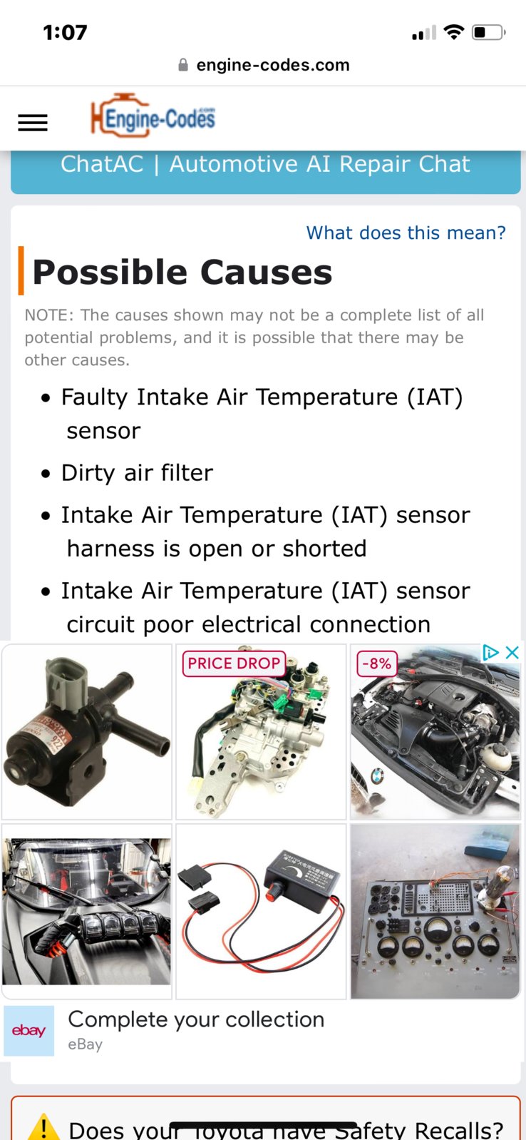

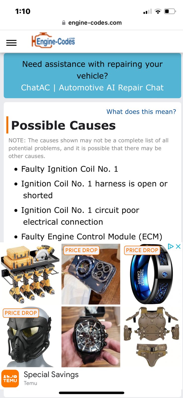

  15. Aug 16, 2024 at 11:20 PM
    ControlCar
    ControlCar My Moto: Help & Learn…period.
    Jul 22, 2023
    #429578
    3,065
    Steven
    Sugar Land TX
    1996 Taco 2.4L 2wd Automatic
    Clock Volt meter/LSPV Delete/Hyundai 16’s/FP gauge/after 9months of wrenching ZERO oil leaks
    Guessing that this vandal messed with the airbox(opo side of battery)
    maybe knocked/broke air intake tube loose causing P0100 as well as P0110
    This air temperature sensor plugs into airbox
    P1300 is your coil that is to the right of airbox
    Post some pix of entire engine bay
    Lots of members here might see the problem
