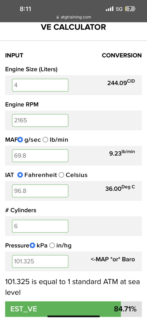

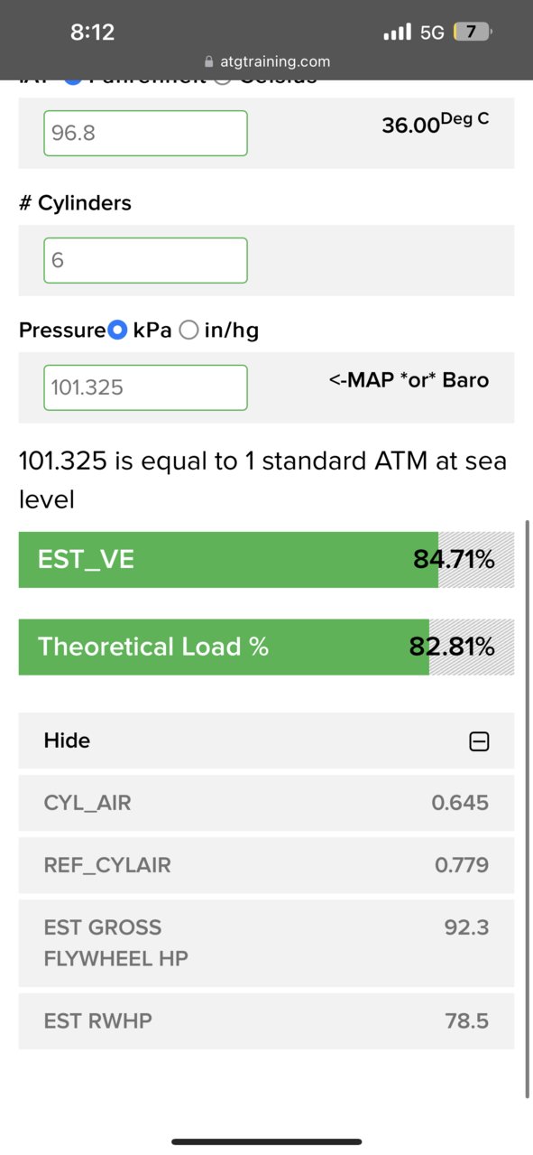

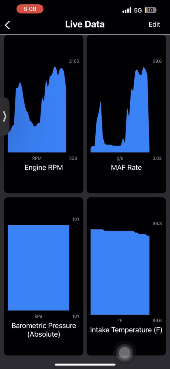

    I WOT in 3rd and this is what I got
    Dm93[QUOTED] likes this.

    That looks ok but not sure how accurate it is down low like that, typically you do a pull through 1st and/or 2nd gear so you hit max RPM.

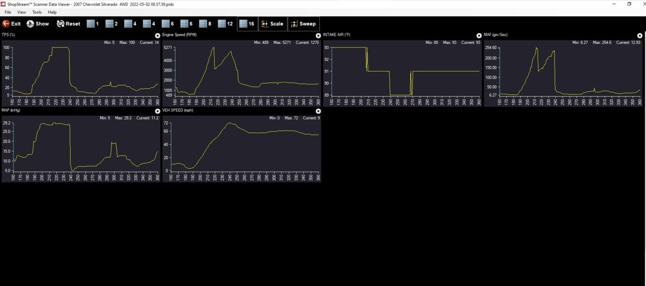

    As an example this is a VE test that I did on a Chevy I was having issues with, you can see WOT basically through the 1st and 2nd gear shifts and take the max RPM & MAF readings.

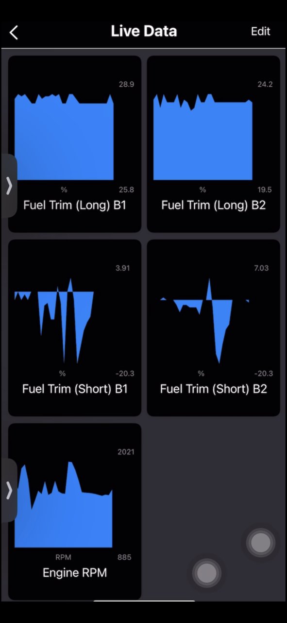

    FP test coming up. look at these short term FTs when I rev the throttle -20

    Is that snap throttle or trying to hold RPM with the throttle?

    But seriously, I’d like to see a WOT pull to full RPM with A/F data (B1S1 / B2S1)

    Snap throttle fuel trims aren't really useful, you want a steady RPM/load when looking at fuel trims.
    Paul can explain it better than I can.
    https://www.youtube.com/watch?v=9gJoH5_Thaw
