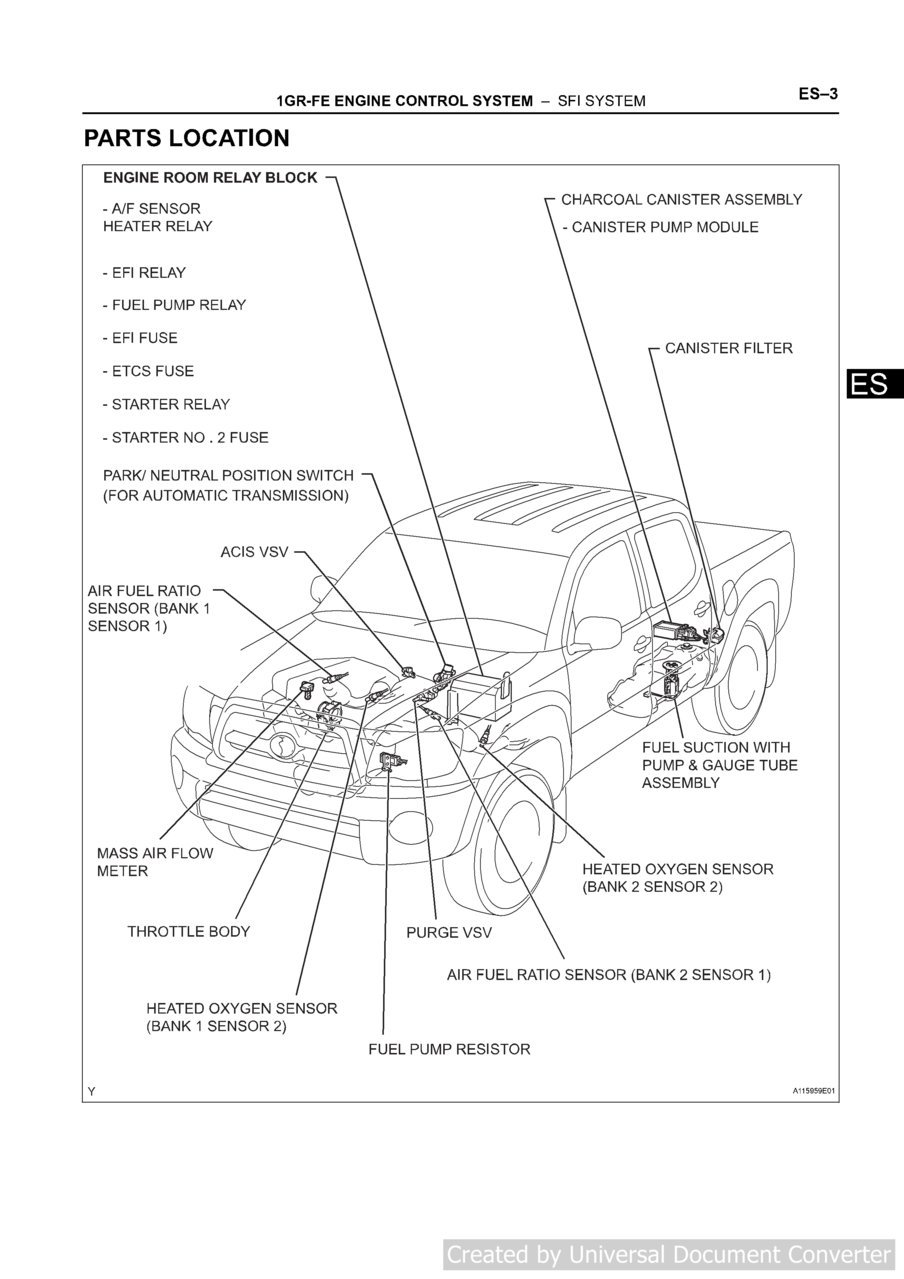

    Check engine light and trac off light with p2238 code anyone ever have this happen?

    not sure why the trac off and check engine light came on with 02 sensor issue but rear feels weird around sharp turns like sliding out some

    Most common cause is a failed bank 1 AFR sensor (Upstream Passenger Side) but it could also be an open or short in the wiring between the sensor and PCM.
    The Trac Off light almost always comes on when a trouble code is stored in the PCM because the Traction Control System relies upon the Engine Control System to be working properly.
