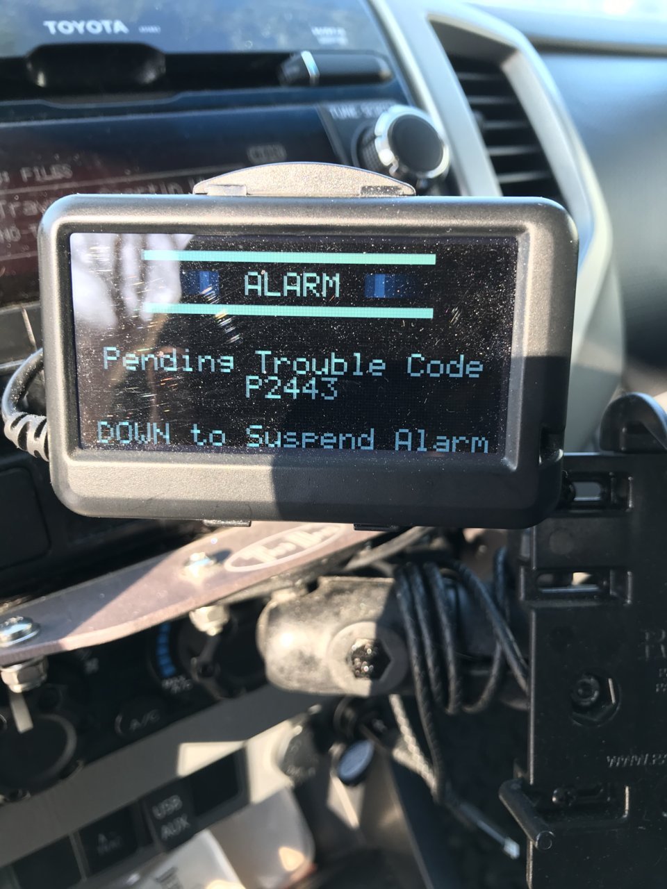

    My understanding is that it could put you in limp home mode which can be a safety issue if it happens at an inopportune time.....

    Was it a pending code? They can come and go but usually are a precursor to throwing a "full" code. Mine pending code came and went periodically but when it became a more frequent occurrence, I called the dealer. Maybe I got really lucky but at the end of the day, the way my case was handled should be the way all cases are handled....
    Prior to having my SAI replaced, I purchased an Ultragauge. In the event that it threw the dreaded coded and went into limp mode, I might be able to cancel the code out and resume normal driving for a short time. I'm glad I didn't have to resort to that....

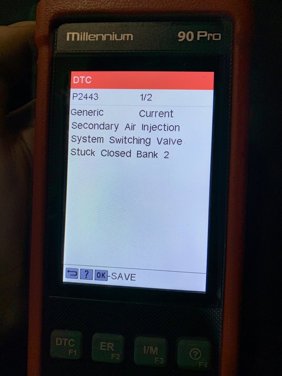

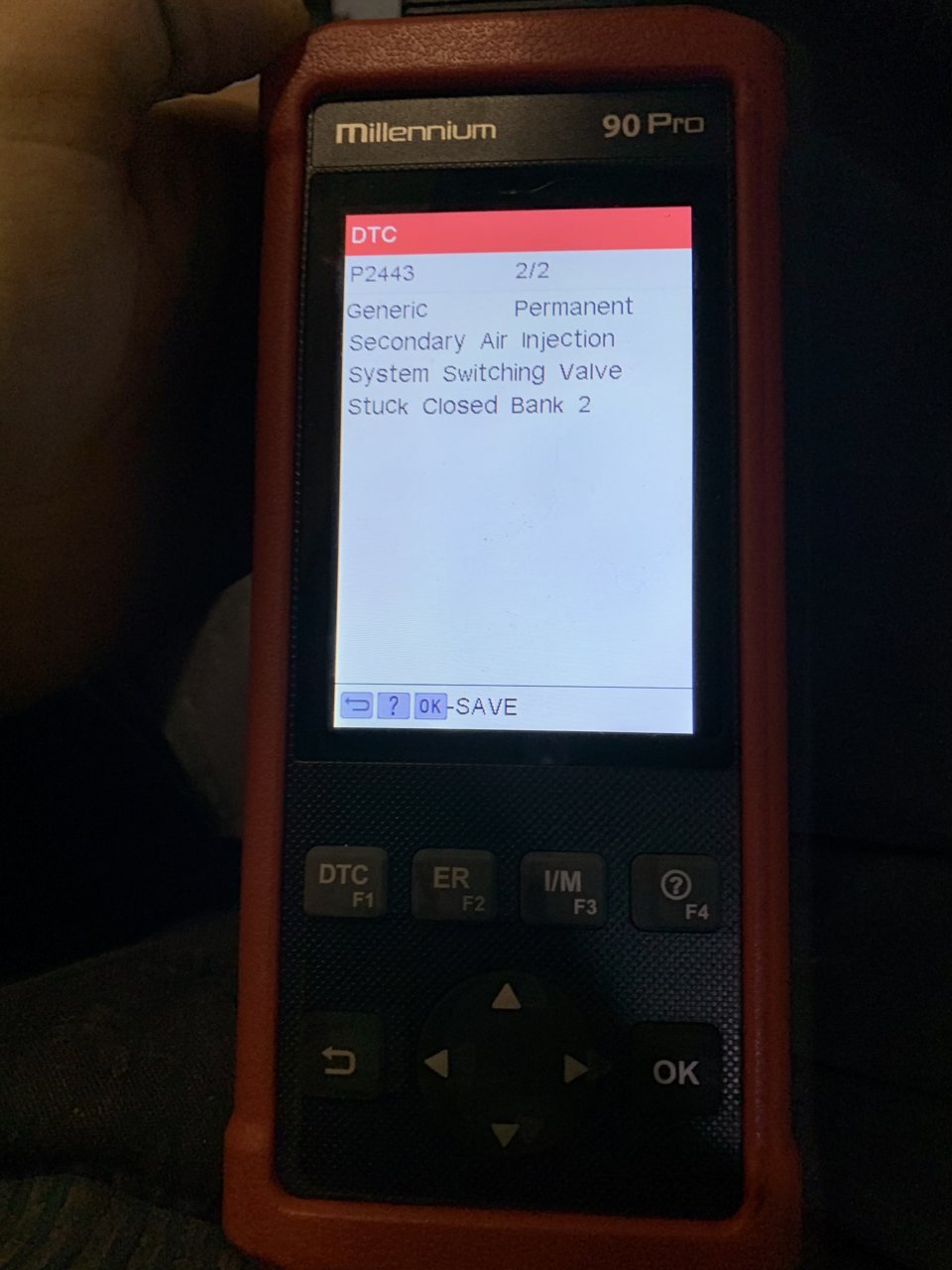

    These are what the scanner displayed for my 2012 this morning 4797B70E-0FE2-43C8-B03F-232D2829E0FE.jpg62698EA1-C275-4669-B4CA-1877DCCB63BF.jpg

    The dealer here in town confirmed it was covered under an extended warrantee but they want 140 bucks to diagnose it themselves. Just going to try to avoid paying 140 for a 2 minute diagnostic is all.

    My Ultragauge display just prior to heading for the dealer...
