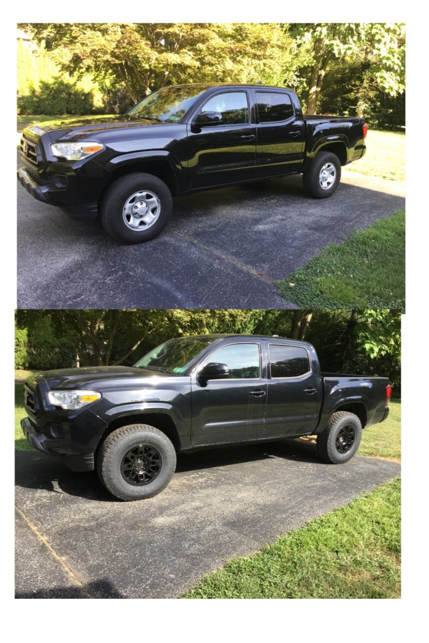

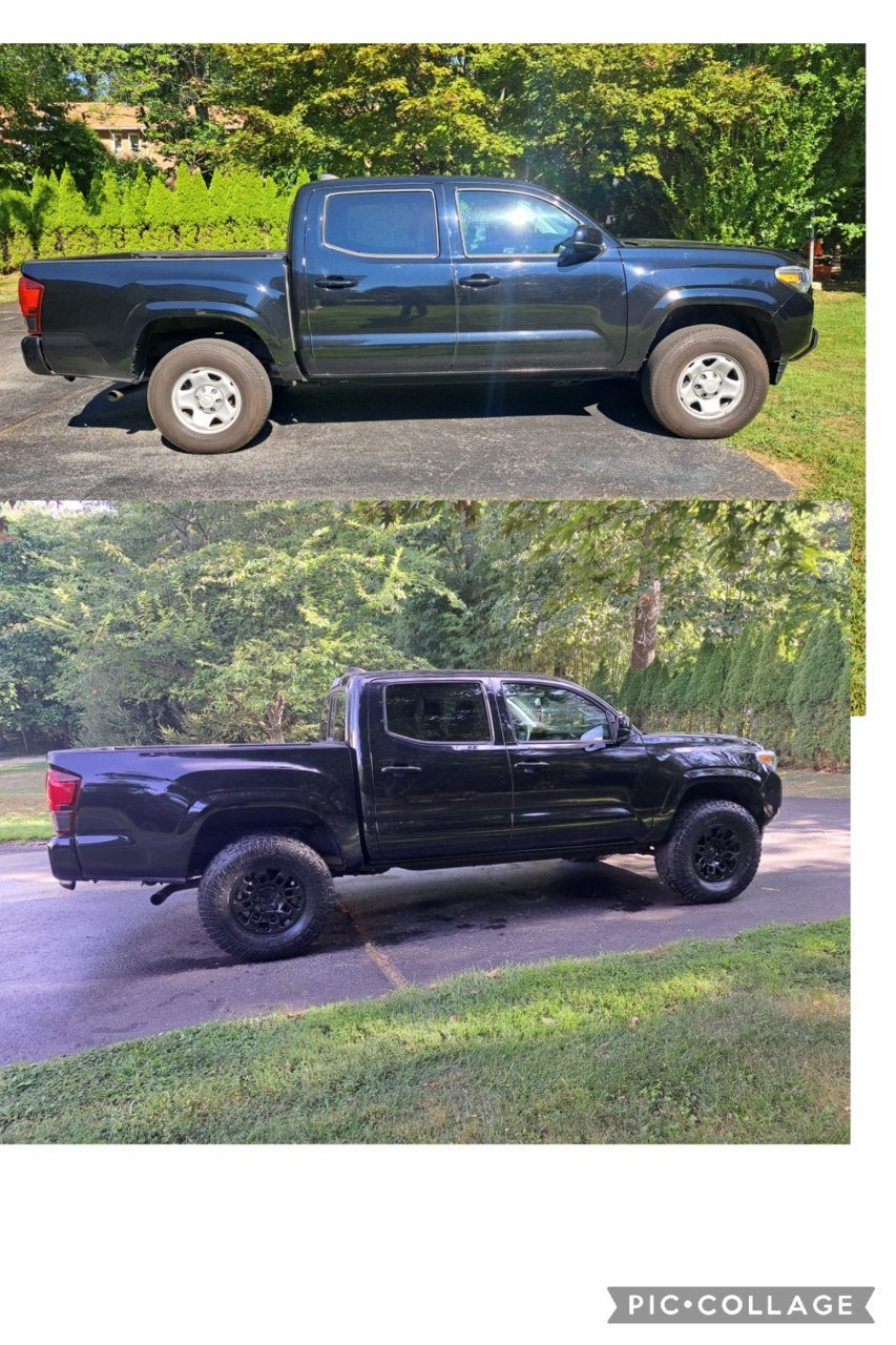

    Just got 265/75/16 in place of 245/75/16 on stock 2020 SR
    No rubbing no issues so far other then the loss in MPG
    Went from around 20 plus to 18 plus in normal driving
    Set them in OEM TRD wheels, Toyo OC 3. Nice tires, good warranty and wear out
    No or low road Noise increase. Nice ride and good lookE306F60A-F304-4992-82BA-38D6A0F99956.jpgA6E672C3-6D16-447C-832F-1EE770B9F840.jpg
