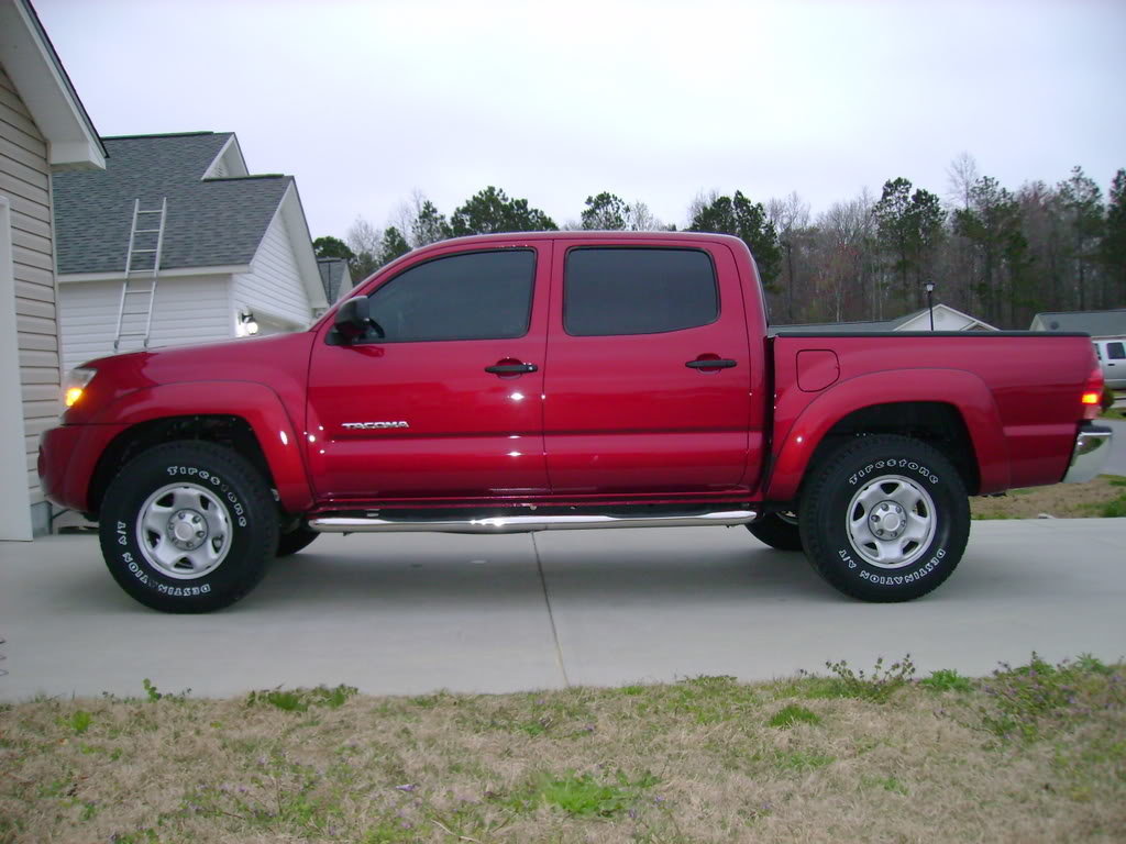

    Not the best pic:

    WilsonTheDog, Thanks for responses. You said no drop in MPG. Did you start out with Dunlop GrandTrek 245/75/16? What kind of 265/6516's do you have? I saw the pic, but couldn't make out what model they were. Looks great, though. PS diddo on the NObama.

    Yes, had the Dunslops, replaced after about 7K miles and they sit in my garage taking up space. I now have Firestone Destination A/T's. They are P rated (I don't really go off road), which keeps the weight down. If you go with C or D rated tires, weight will increase dramatically. The 245/75/16 Dunslops weigh 34lbs while the 265/75/16 Destinations are 44lbs. C rated Destinations are 50lbs.
