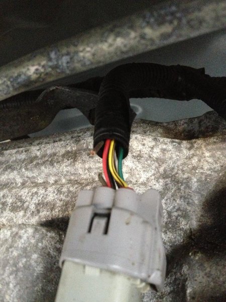

  6. Jul 31, 2013 at 11:40 AM
    Redskins21
    Redskins21 [OP] Well-Known Member
    Oct 10, 2012
    #88699
    52
    Think this might have something to do with it?
  7. Jul 31, 2013 at 12:42 PM
    Sandman614
    Oct 26, 2010
    #45273
    35,948
    Tim
    Garner, NC/Boone, NC
    '06 SR5 Off Road
    Ah ha! It's at least a start.
  8. Jul 31, 2013 at 1:27 PM
    BamaToy1997
    BamaToy1997 Wheel Bearing Master
    Jan 31, 2012
    #71846
    10,791
    Bill
    Navarre, FL
    1997 Tacoma 4X4 AKA "Blue Beast"
    best wheel bearings around! www.marionbumper2bumper.com
    I don't know. Maybe. I just figure it is a natural resistor for the circuit, but maybe you are onto something.
