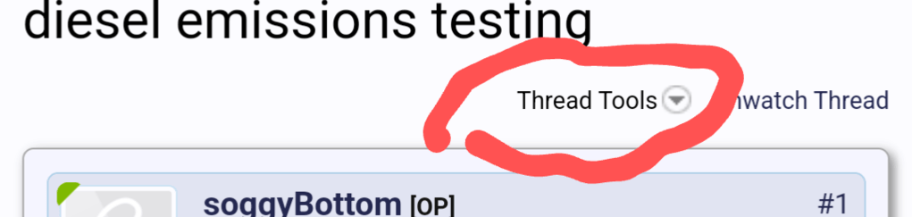

    Please change the title of the thread. There is a button at the top on threads you create
