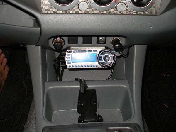

    Just installed the PA15TOY in my 09 DC last night, just for those interested I have the JBL head unit with built in 6 disc changer.
    My goals were two fold-
    1. To install a adapter that will allow me full access to my 15gb Itouch through the steering wheel controls as well as keep it charged at all times.
    2. Provide an aux input other than the stock input jack in my dash below the A/C controls. This is where I have plugged in my Sirius Starmate, the bundle of wires look like crap and it's driving me nuts.
    The PA15TOY adapter provided everything and more. Installation was very easy. It took more time to create the play list on Itunes then it did to install.
    Here is the before shot.
    [​IMG][/url][/IMG]
    Here is the after shot.
    I'm not done yet as I am still playing with the final position of the Sirius player, it needs to be twisted slightly toward the driver otherwise the glare is too much to see the display.
    It is a pleasure being able to toggle between Sirius-Itouch-Radio-CD at any given time all through the steering wheel! I should have purchased this a long time ago.
