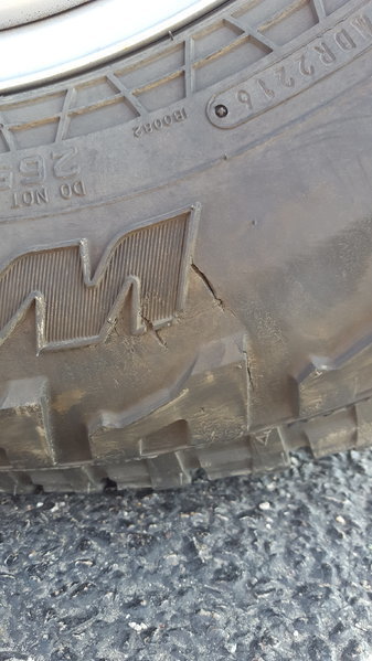

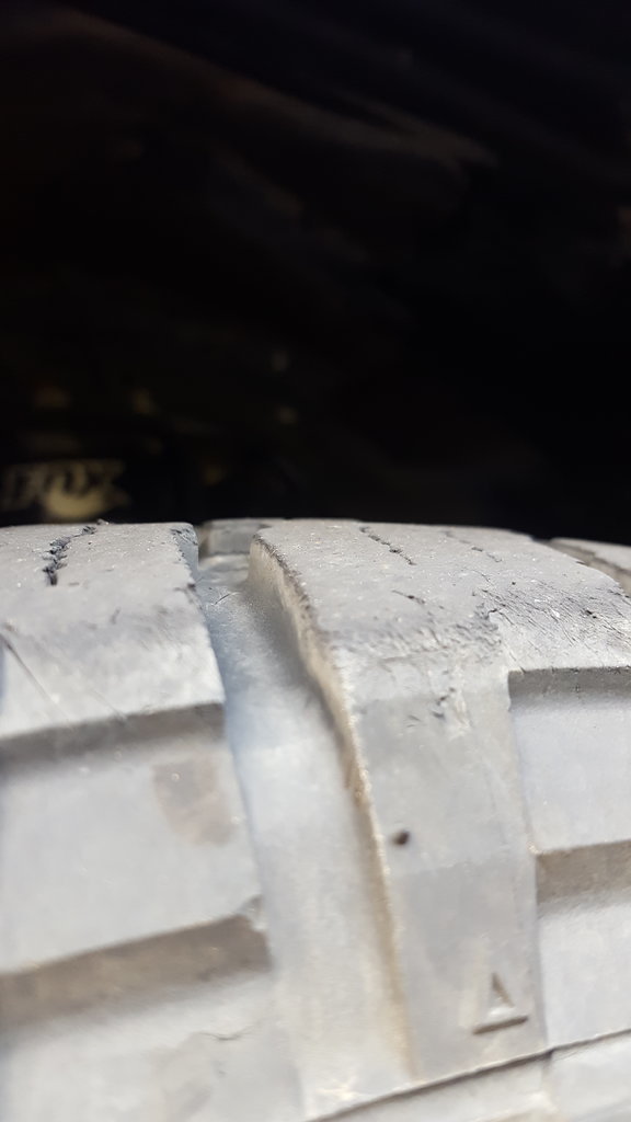

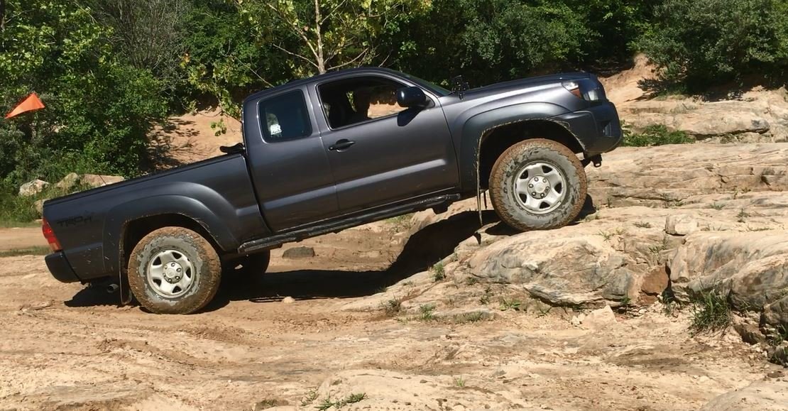

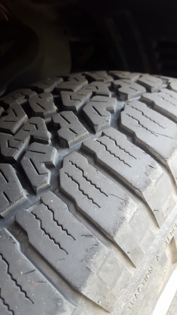

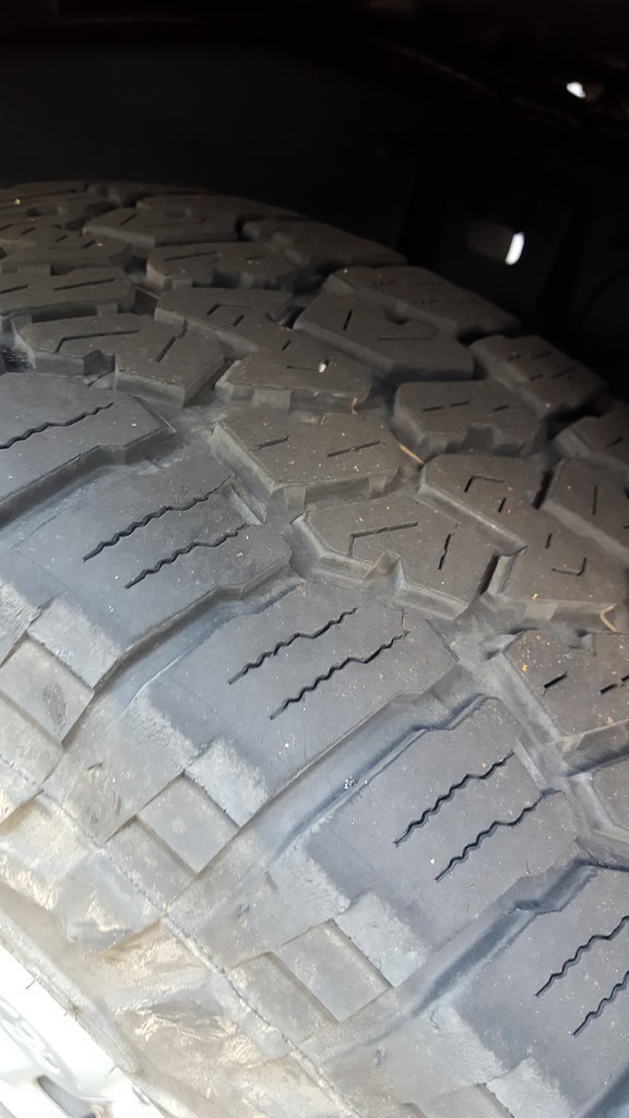

    20,000 mile update. 265/75r16 - original tread depth was around 14/32nds when I got them. The first 5,000 miles, the tread wear was quite drastic jumping down to around 11/32 all around. At the 10,000 mile mark it didnt jump down as fast; right around 9.5/32. Same with the 20,000 mile mark, Im right around 8/32. It could be from my driving. The first 5,000 was quite a bit of city driving and also off roading (rock, mud, dirt, sand). The other 15,000 was mostly highway. On another note, I do off road these tires and besides the standard depth wear, I have noticed these tires have quite a bit of cuts and also rounding of the tread blocks (all tread blocks). I also run right around 33 psi. Overall, I don't have any complaints with traction and especially the considering the cost is so reasonable, but not sure if i'll make it to the 50,000 mile mark if I off road these anymore. I guess we'll see. Plus, I want 285's. :) I forgot to mention that I do have a slit in one of the tires, but haven't had any issues yet (knock on wood) that I mentioned a while back.

    Are you running LT or P rate tires? I've heard that the P-rated tires wear faster due to silica content or something. I went with E-rated because I wanted to have more tire than I needed rather than not enough, I've been happy so far but I'm a low mileage commuter when I'm not exploring so I can't speak to longevity.
    I guess I really need to chalk test these, especially if everyone else is running much lower pressure and still happy.

    I'm running the P rated tire for weight reasons since my truck is a 4 banger. Yeah, I had contacted Falken regarding tire pressure and he had told me to run around 30, but I thought that was kind of low so I'm running 33 instead. Im not sure about the LT. Chalk test is a good idea though. To your point, I will definitely be running an LT next time around, but will also be bumping up to 285.

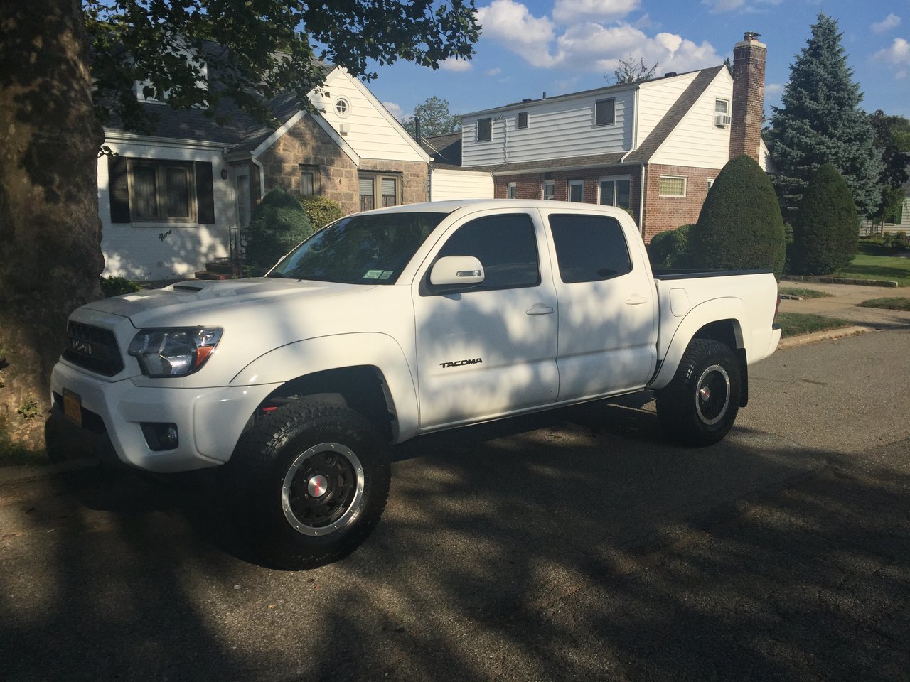

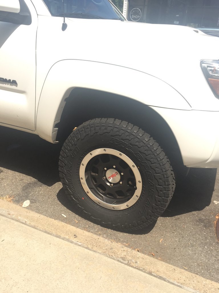

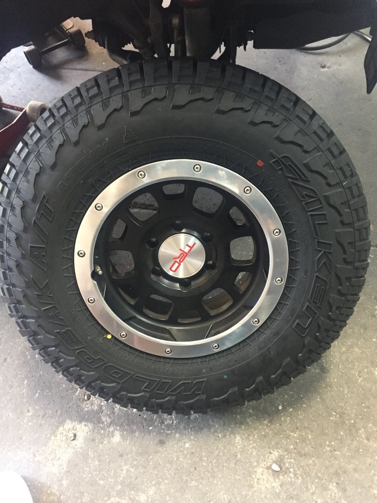

    Decided to go with LT 265/75 R16 on my 2015 TRD Pro and so far I love them. Much quieter ride than I was expecting. IMG_4513.jpg IMG_4514.jpg IMG_4511.jpg
