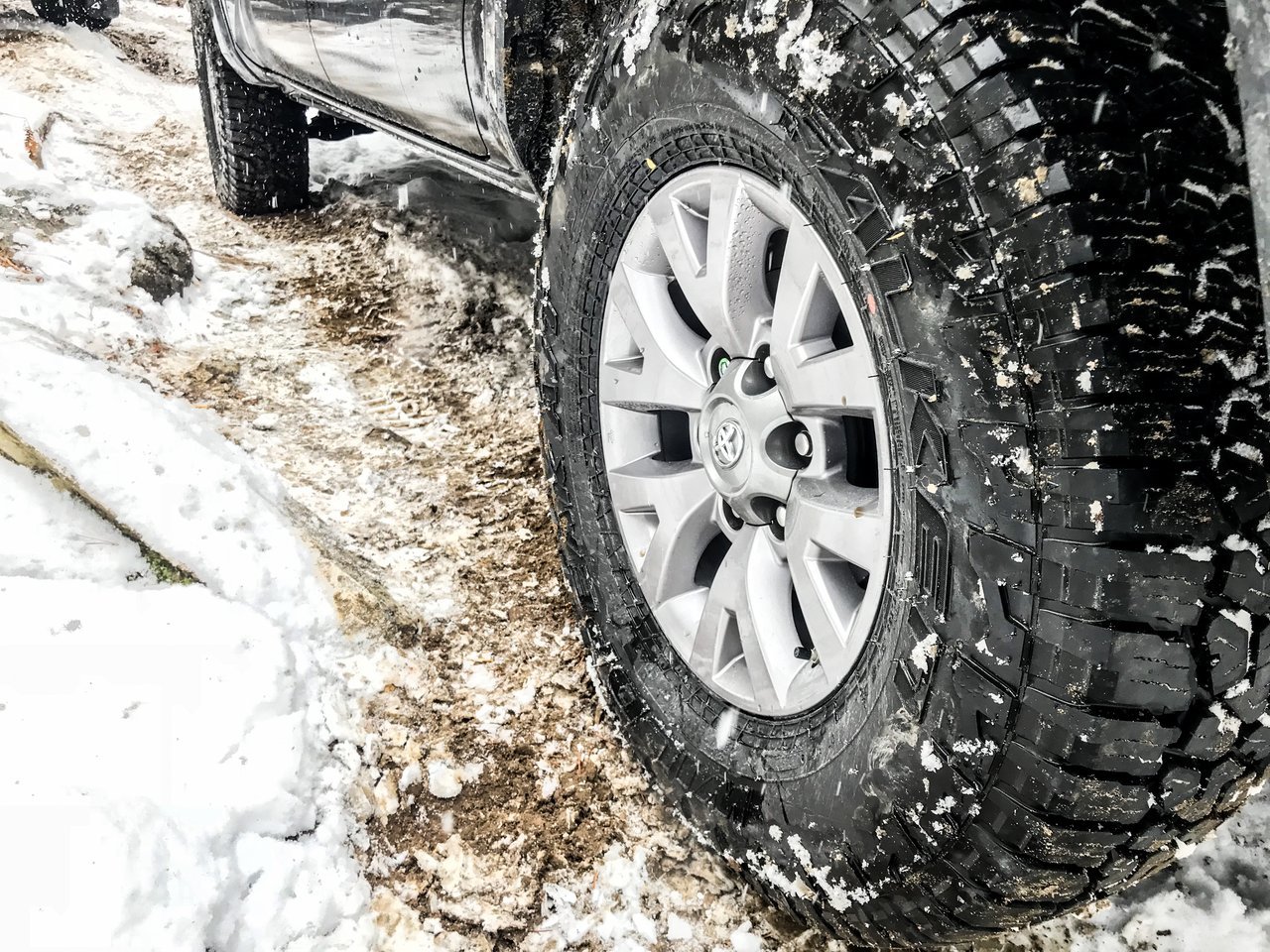

    Went out in the snow with a bunch of TW guys this past weekend. The tires did great! For how slick it was out I was very surprised with how little the tires spun on the trail especially going up hill. If they did spin it was most likely from getting hung up or the tire not being big enough to roll over something. Changing my line worked every time.
    There were a few spots going downhill where I would lose traction but mostly because I was on a rock. Once I hit snow traction was there.
    On the fire road getting to the trailhead I had no issues with traction at normal pressure (about 35psi) in 2wd.
    Overall I have been extremely happy with the tires. As of right now I can see myself buying these again when I decide to go bigger.
    Edit: I’m running p265/75-16

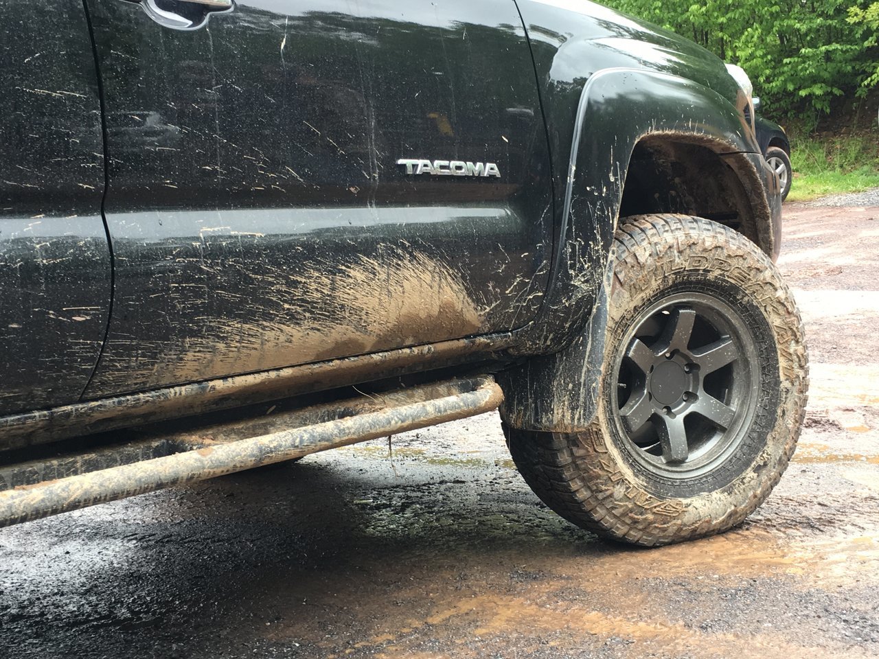

    Haven’t posted in a while here, folks have been interested in long term wear. Tire size is 265/75/16 Standard load, I’ve been rotating them about every 5k miles, I run the pressure at 36psi all four corners, currently have 25k miles on them, tread wear is 9/32 on the front 10/32 on the rear and they are wearing evenly across tread
    I’m am still impressed with the wet handling, they work very well in the snow too. I was running the Cooper StMaxx on a bigger heavier truck before the Tacoma, the Falken Wildpeaks are not nearly as aggressive as the StMaxx however they are much lighter. Considering I’m about 80/20 on road to off road, the Wildpeaks are very good combination for the Tacoma. Having a tire that doesn’t mind a few side scuffs is a plus as well.

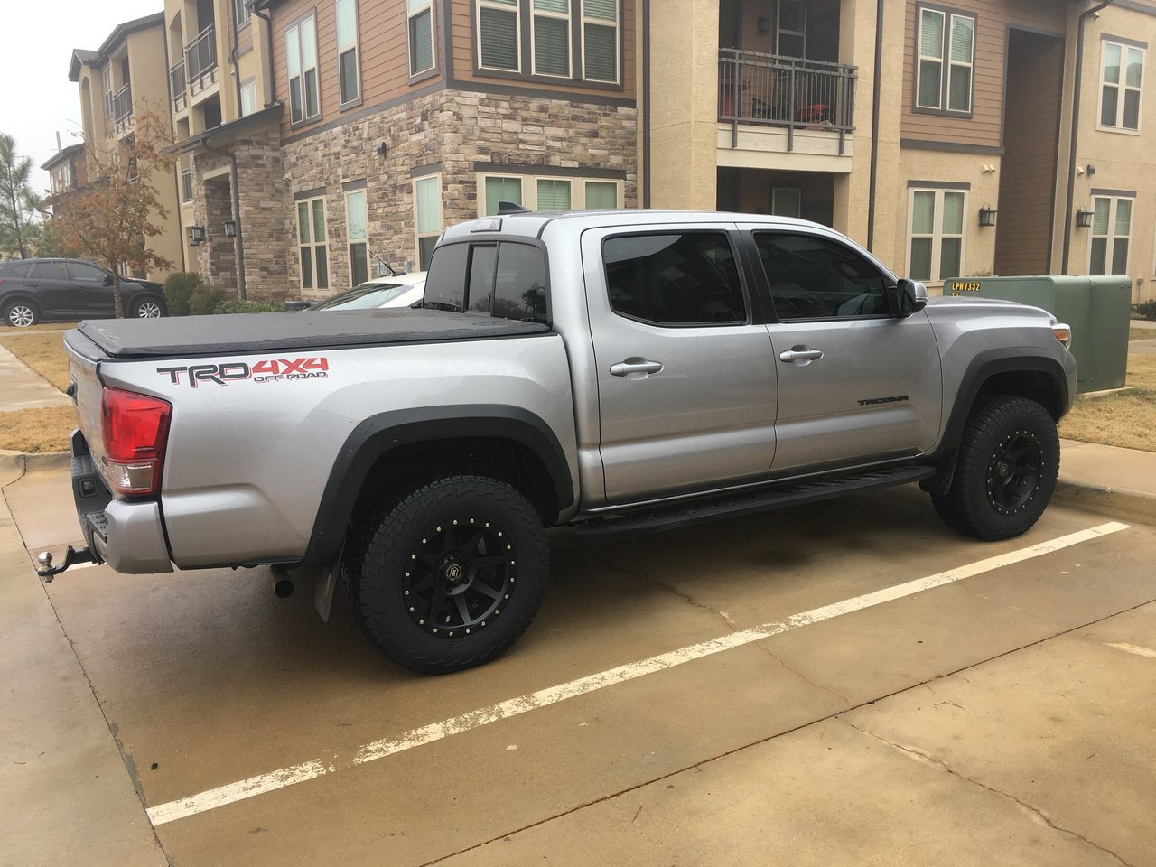

    Super happy with my Wildpeaks! I was worried they weren’t aggressive enough, but they look much better in person! Drove 2 hours in heavy rain right after I had them installed and they did great! 0B82948F-3C2F-434B-B009-7409A485B9C7.jpg917FAB99-B064-478A-8E58-C31240CC536F.jpg

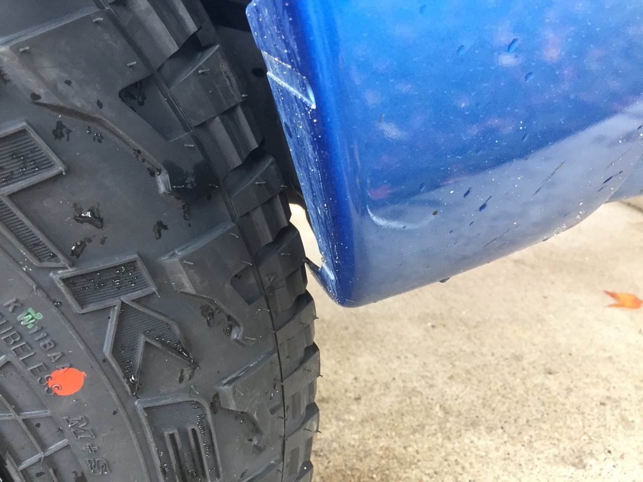

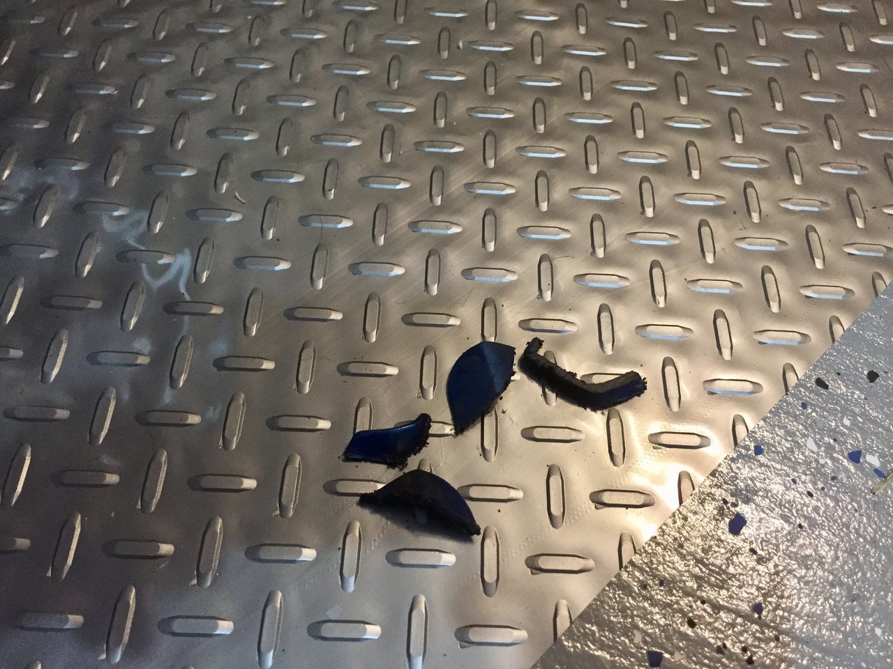

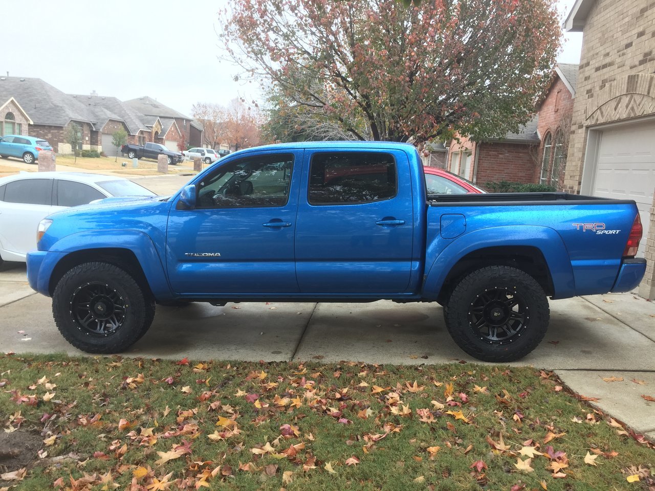

    Couldn’t be happier with how the truck turned out with new wheels too. The Wildpeaks look much better in person and the truck has a great stance now. Lift will be going on in the next month or so. Minimal rubbing on the inner fender so I trimmed about 1/2” off to make it clear, can’t even tell. I do have stock suspension up front with 192k so I’m sure it’s sagging a little.
    17x9 ProComp 7005 -6 offset 4.75 bs
    265/70/17
    My only complaint is the tread on all 4 tires measured in at just under 13mm depth. I had read it was suppose to be 14....

    Did you have to Cut some fender off?? Im getting the same size tire soon...

    The last 2 photos above show where and how much I trimmed. It was almost nothing and you can't even tell.
