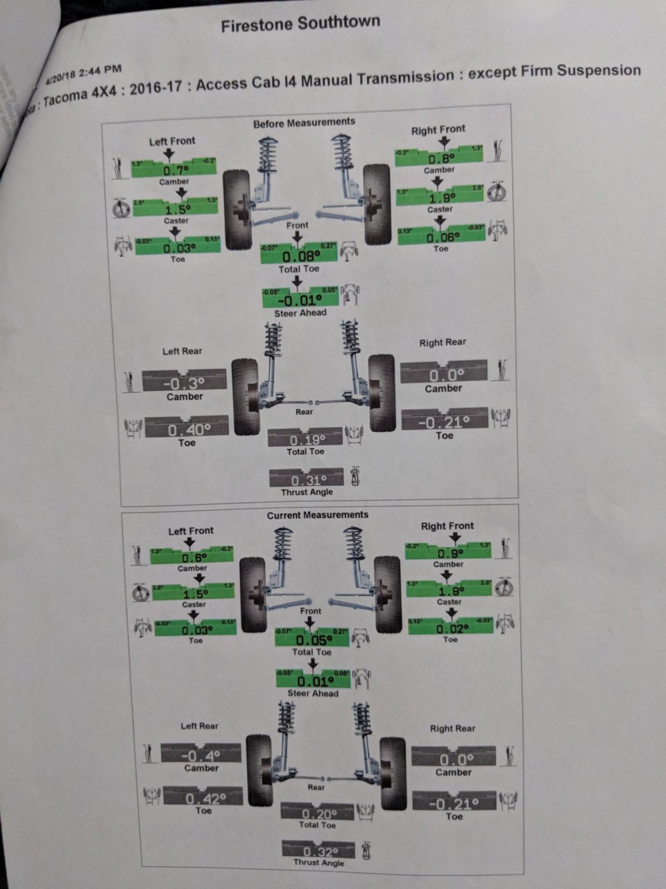

    Just got the alignment checked. As I expected everything was within spec, though the rear is a little wonky-er than I would prefer. I dont believe this is the cause of my wear tho, as I checked tread depth before they were rotated and all 4 tires were the same. IMG_20180420_145549.jpgI'll keep an eye on it and see what happens.

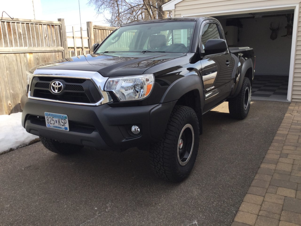

    Got mine installed a few day ago and had the 55-65 mph shakes. Took it back the next day and all 4 were off 1.5 oz each. All good now and really like them.
