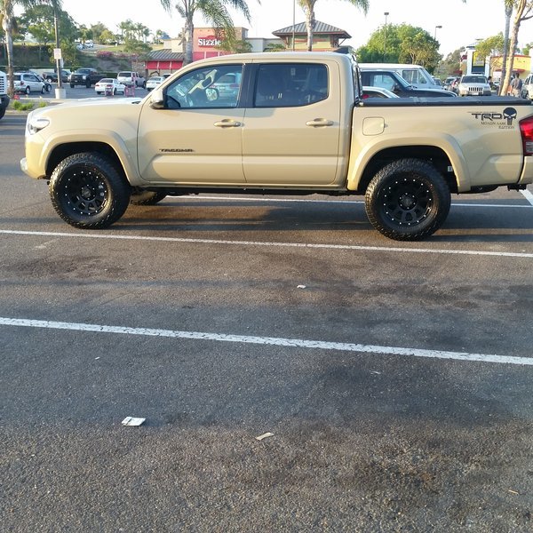

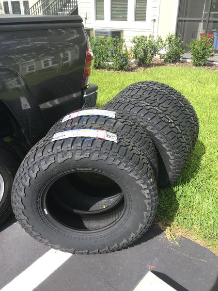

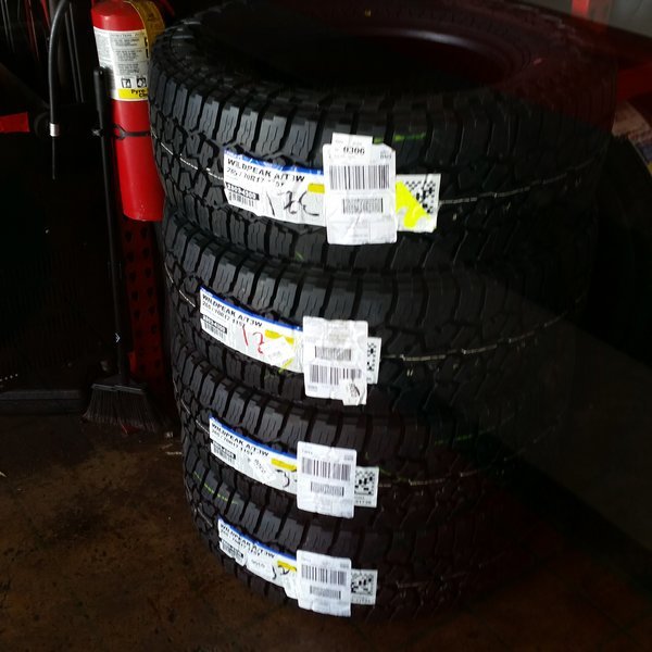

    Arrived on Monday, installing them today.

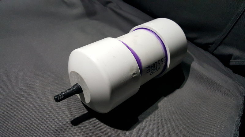

    Exactly why I made one of these bad boys and if you'd like one I could make you one!

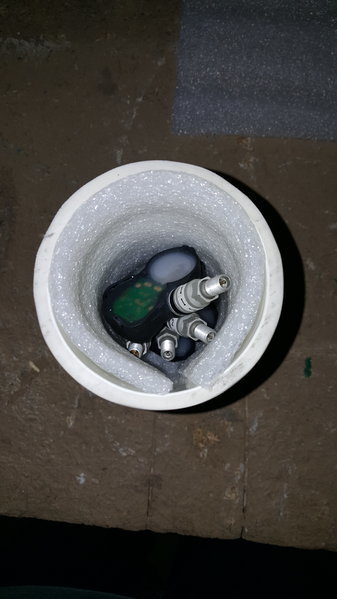

    Just put regular stems in it for now! This is a piece of PVC that i made and you put your sensors in it and fill it up to 30 psi and throw it under the back seat and it tricks the computer thinking that they are in the wheels so the light is off!

    I just put regular rubber valve stems in my tires when i went from steel wheels to alloys then threw the 4 sensors in the tube, closed it up and put air in it and its been fine ever since. I've had my sensors in the tube for about 6 months now and they have been great!

    Not going to lie it sounds a bit risky but it's a good idea to avoid issues with the tpms like I'm having.

    Nothing really risky about it, the PVC glue pretty much melts the plastic together when you glue the two pieces. No way its going to come apart!

    Way cheaper than buying new tpms sensors for $68 each then having to pay someone to reprogram them! 4 regular valve stems cost like $2 lol.

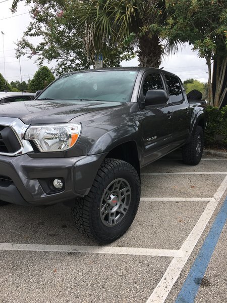

    Finally all done. Falken Wildpeak AT3 265/70/17

    Looks great! Like the wheel/color combo. :thumbsup:
