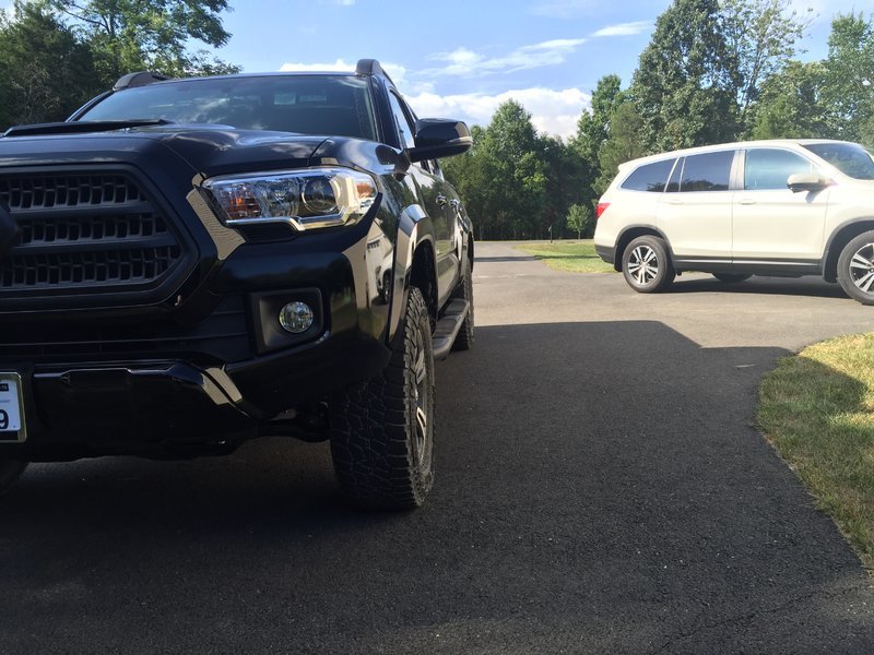

    Nice combo!! These tars are real eye candy!

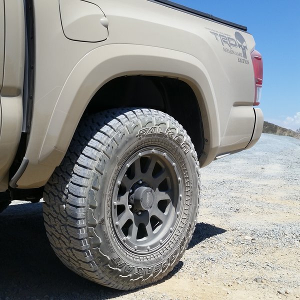

    Got out in the dirt for the first time. They handled everything they came across really well. Loose gravel, sand and some good sized rocks. 20160811_133804.jpg
