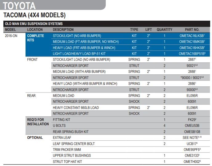

    @Marcmtb1 I see you're running 885's... I just ordered 5100's with 887's. I decided not to wait any longer for 6112.. anyway.. There's a new chart that doesn't even list 885 as an option anymore for 2016+. What are you using the 885's with?

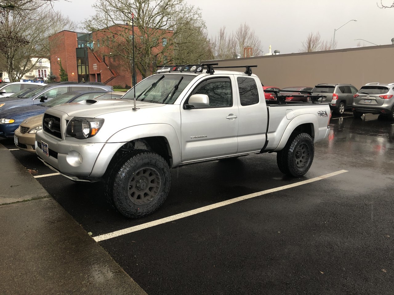

    What size tires did you go with? How much lift do you have and what are the specs on your wheels?
    Nice Truck BTW!

    Tires are 285/70/17, 5100’s in the front set at top, OEM UCA’s, AAL in the rear. Wheels are 6x5.5 with a -6 offset and a 4.75BS.

    Thanks for that info. Those are SL rated correct? How's the ride with them?
    I'm currently on 265/75/16 load E S/T Maxx's and they'r pretty stiff. I'm think about going with something different, possibly in a 33"

    Mine are the LT, E rated 10 ply.
