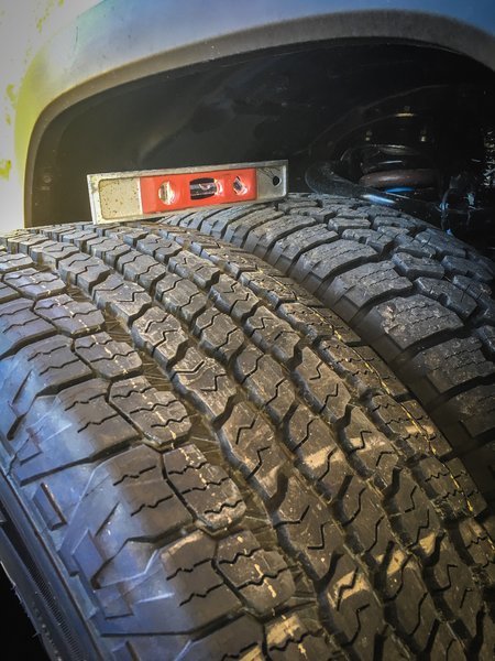

    So update on tread depth. I have these in standard load (p metric) 265/70R17. Website says 14/32" new, mine arrived measuring 13/32" and change. Did a tire rotation today backs measured little more then 12/32" and the fronts just under 13/32". There's around 4,000 miles on them right now. The wear pattern on them makes it look like they might have been under inflated even though they've been around 35-37psi. I have been finding they don't like holding air. All four will loose pressure at the same rate. So I've been setting them to 39psi and checking every few days which has been keeping them wearing even.

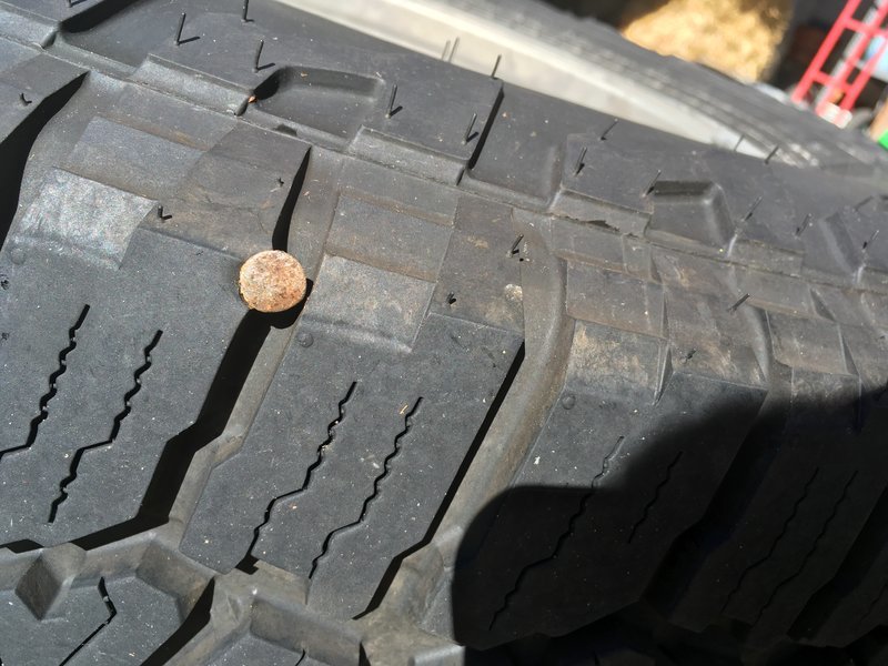

    Also side note picked up a nail but got lucky and was able to patch it.

    How do they ride at that psi?

    They ride pretty decent actually. Little firm but not to bouncy.
