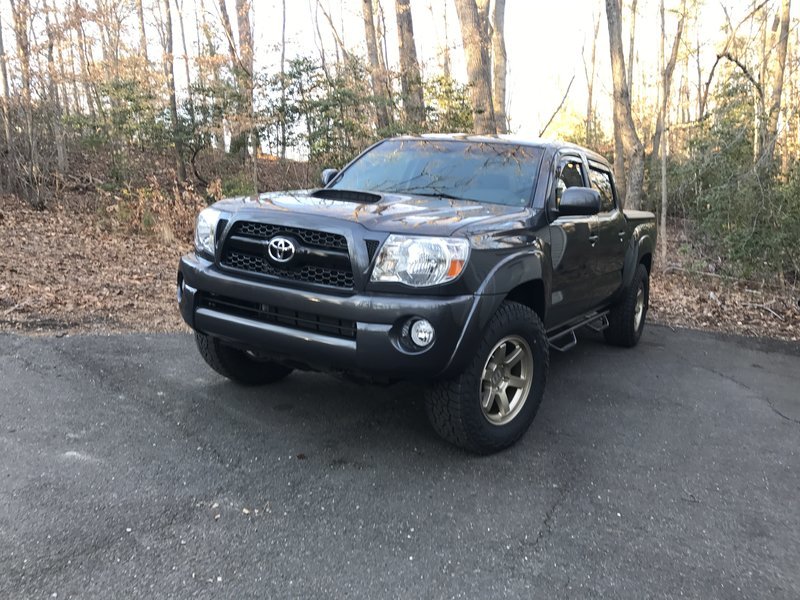

    Finally got my truck back..like the tires so far but only 40 miles or so. Even though they're the same size as the coopers I had on before they look much bigger.
