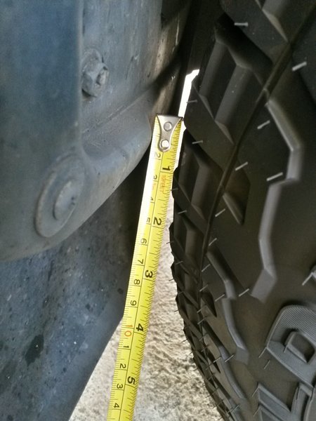

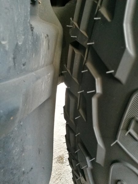

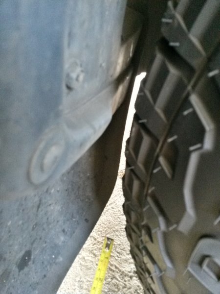

    I have the shorter Husky mud flaps mounted so I can't speak for the stock flaps. At full lock turned right, there is an approx 3/4" gap. At half turn, there is a 1/2" gap from the most protruding point on the Husky (the tape measure is 1/2" in width). The last photo shows the full lock.
    My 245/70 is 30.8". A 245/75 is almost a full inch more at 31.7". That would be 1/2" tacked on to my tire radius. Gap is 1/2".
    There are people that swear they have no rubbing issues with 31.7" Falkens on stock suspension and you will find people that do. I think this inconsistent rub/no rub reports are attributed to a combination of stuff like condition of suspension, caster setting, personal tolerance etc.

    I didn't have any issues moving to a SL245/75/17 (31.5") falken prior to the Bilsteins, but the different wheels changed my offset. Moving from 30mm to 15mm, that could explain why I didn't have rubbing

    Could be. I believe offset is another important factor to the rub/no rub issues. If I remember correctly, my TRD 17x7 wheel has a 4mm BS, whereas the stock 17x7.5 sported a 30mm BS. As such, the TRD wheel would get pushed out a little. That caused some concerns for me on the rubbing. In fact, while researching, I found that people were experiencing more rubs with the TRD 17x7 and 265/70 combo than the stock wheel w/ 265/70. I just played it safe and went w/ 245/70 and have no regrets.
